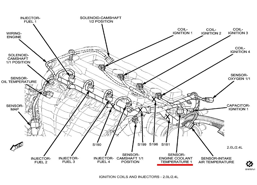

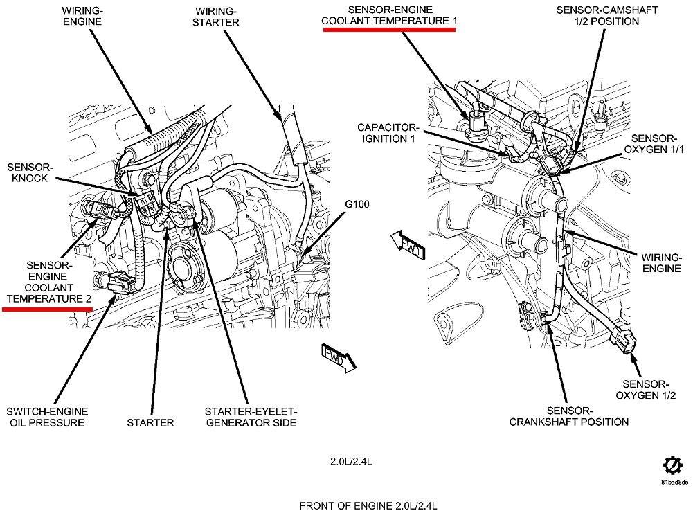

Hello, so a few weeks ago our check engine light came on along with the red lightning bolt light. We went to AutoZone and had them run a check on the check engine light and it confirmed that the issue was the Engine Coolant Temperature Sensor we purchased and replaced. Only the vehicle is still overheating, and upon further research we found that there may possibly be 2 sensors. The one we replaced and then another one. My question is, where is the second one located? The one we replaced was fairly easy to find and on the top right side of the engine if you're looking at the car from the front on what resembled a hose. Where would the second one be? Please use dummy terms because I don't know much about cars.

It's a 2009 Dodge Avenger.

Here's the two drawings available for the Avenger 2.0 / 2.4L.
