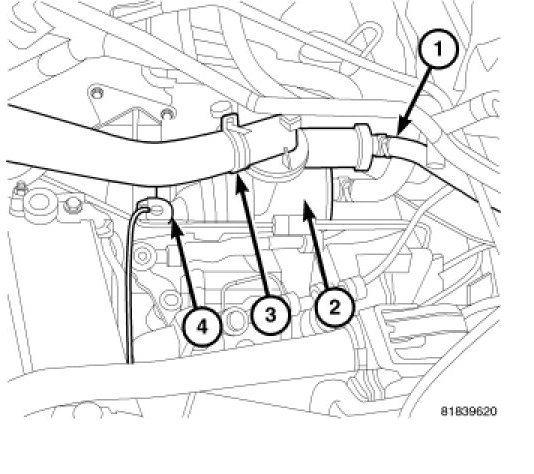

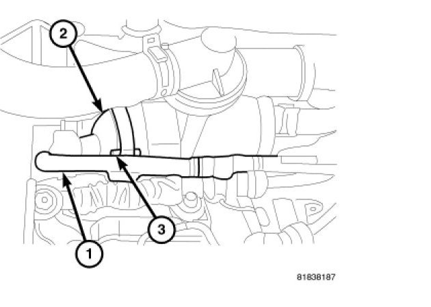

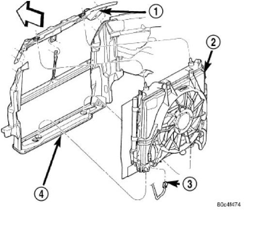

My Daughters car overheated this morning. I went to check it out and noticed the plastic CHEAP! radiator cap broke in two. It looks like a long hose that connects to the thermostat on the motor itself and to the top left side of the radiator. My problem is I can not see the end of the hose that connects to the radiator. Do I need to remove the fan shroud or any other things to get to this so I can replace the hose? It looks simple enough to do but I am needing to make sure. Thanks for your help!
May 15, 2013 at 2:29 AM
  • 55,433 POSTS
Yes it has two thermostats , one primary and one secondary. Here is a guide and a diagram that will help you get the problem fixed.
and
https://www.2carpros.com/articles/how-to-replace-a-car-radiator
Please let me know if you need anything else to get the problem fixed.
