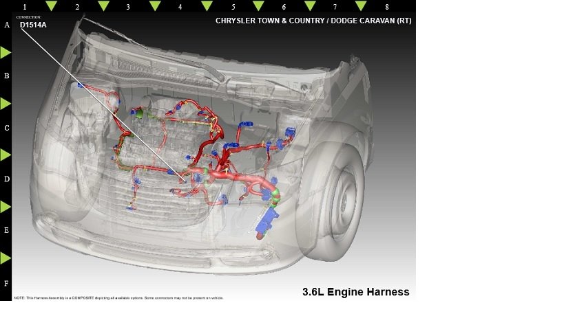

I am trying to find the ECT sensor by the air filter. I am told we have 2 sensors but I only found 1. It is near the front and looks like it is on the engine. I am told by people that the second is near the oil filter but cannot find it anywhere. Are you able to give a description or photo?
Nov 11, 2019 at 7:26 AM
CARADIODOC
  • 34,381 POSTS
Here's what I was able to find for the 3.6L engine. That's the only option in 2014.

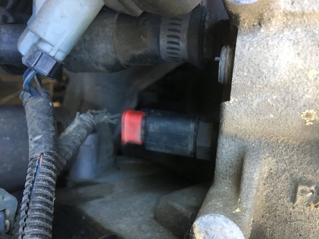

Just a quick question to about the temperature sensor. I don’t want to brake off the connector. Is that red piece the tab I pull out then remove? Or is there a safety tab underneath?
Feb 25, 2021 at 2:30 AM (Merged)
SCGRANTURISMO
  • 4,897 POSTS
If you look at the connector there should be a little tab that you press down on and then pull the connector apart, if not, then the sensor will have a raised male piece and the connector (harness side) will have a tab that goes over the male piece and snaps in place over it. The tab will have to lifted and the connector pulled of the sensor. A quick inspection or feel on the connector/sensor should tell you right away. Either way, just use a little care and you should be fine.

Yep, just found the tab. Thanks!
