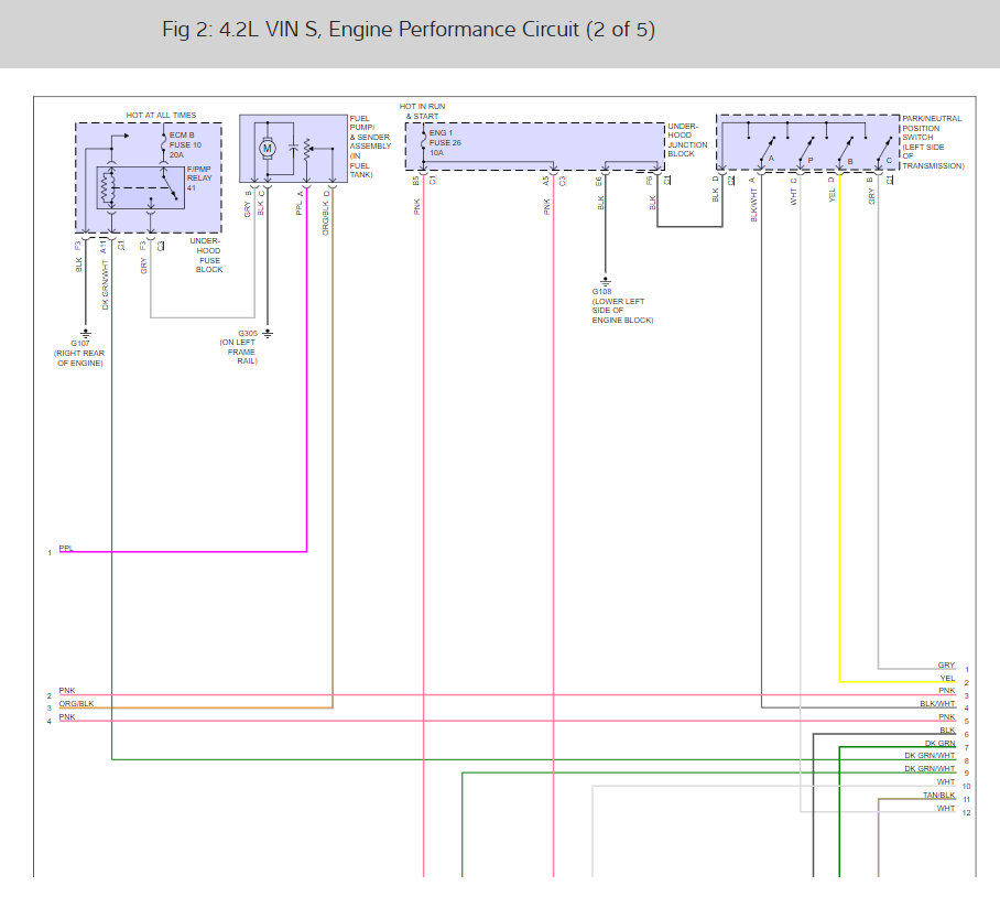

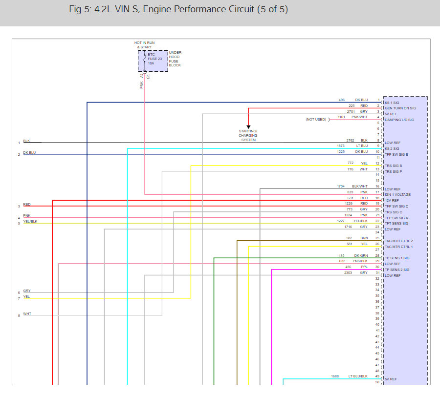

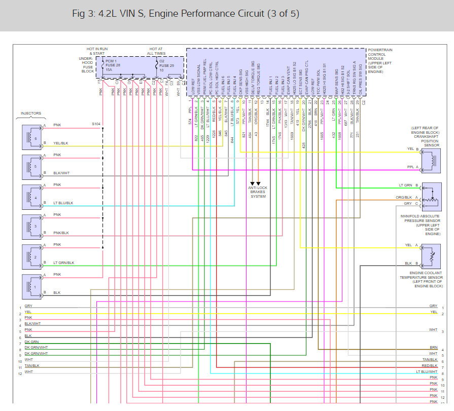

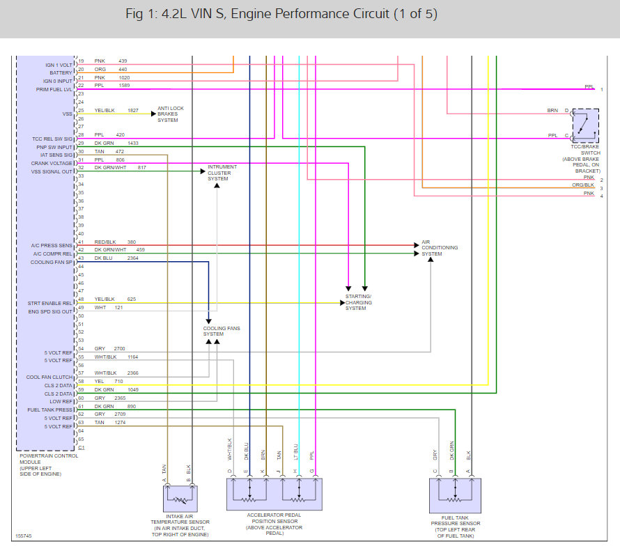

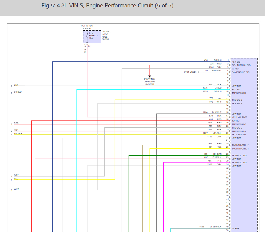

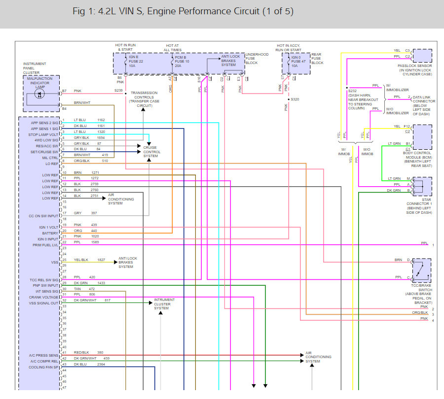

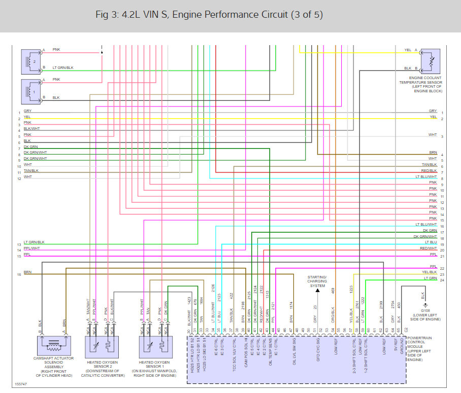

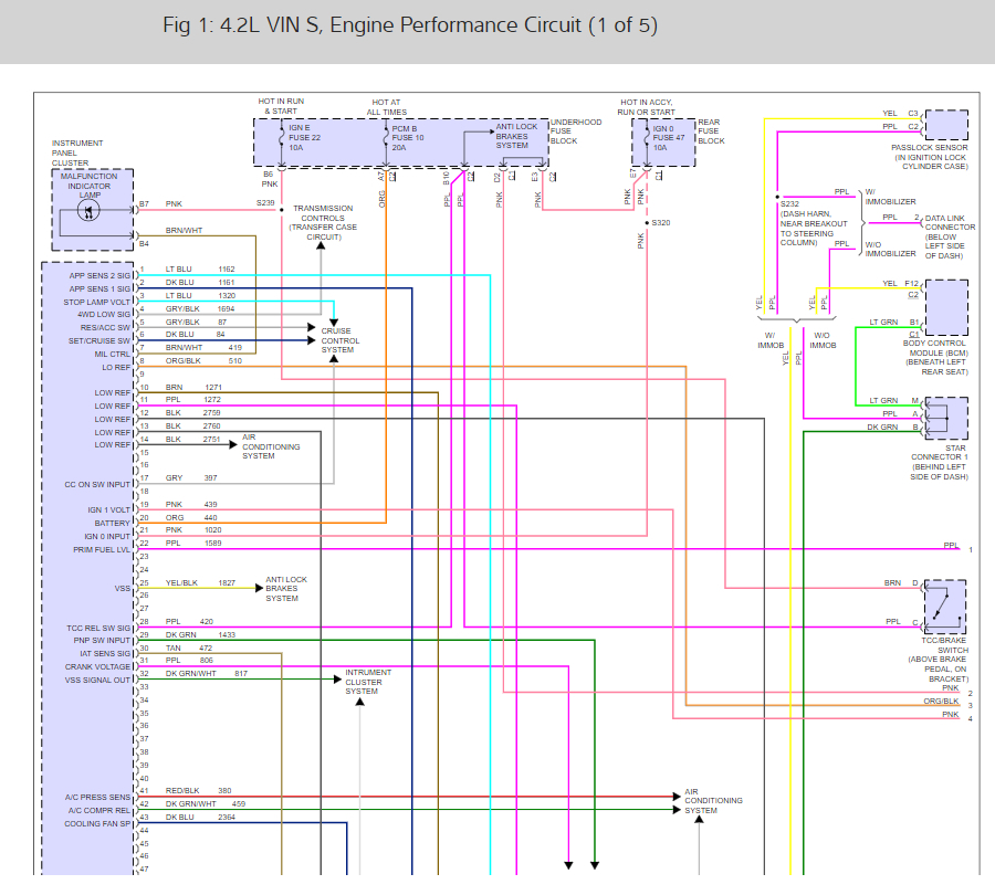

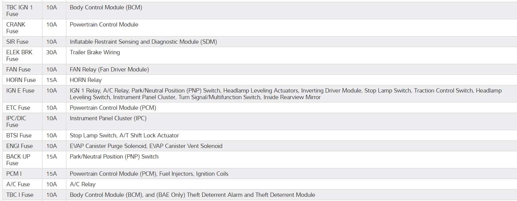

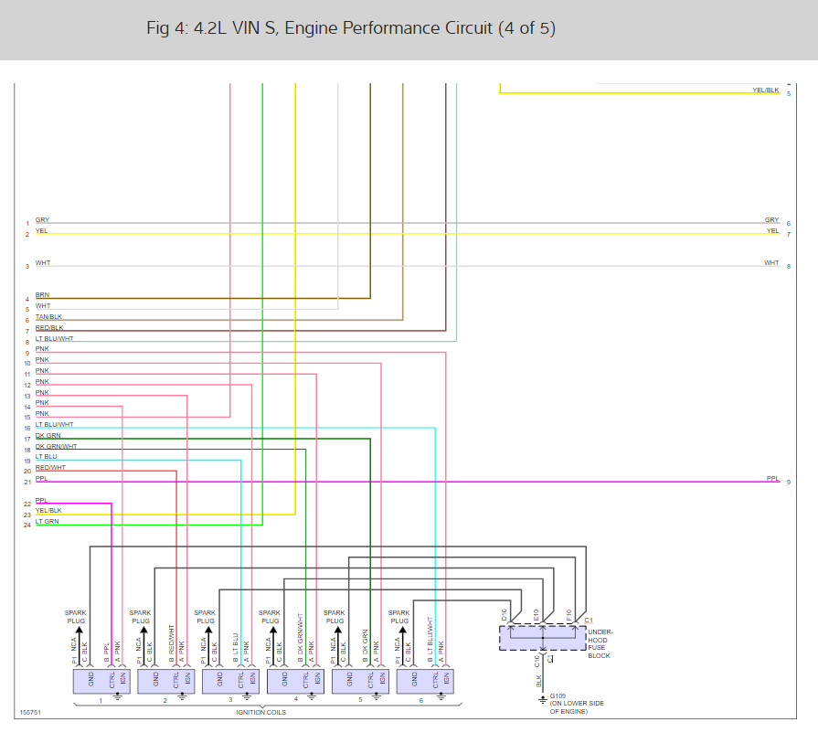

A two foot extension was left under the hood and while driving it got grounded out from positive terminal to the ECM! I replaced with ECM with all the same numbers on it and still nothing. I have all the dash lights come on accept the engine light, I got no fuel pump, no starter, etc.
Aug 10, 2018 at 6:49 PM
  • 55,746 POSTS

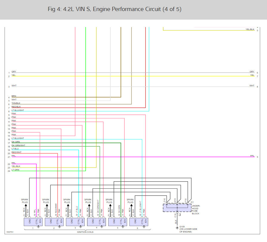

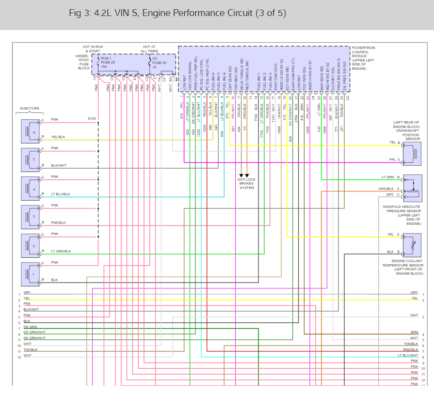

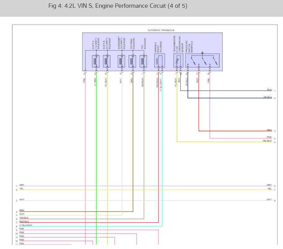

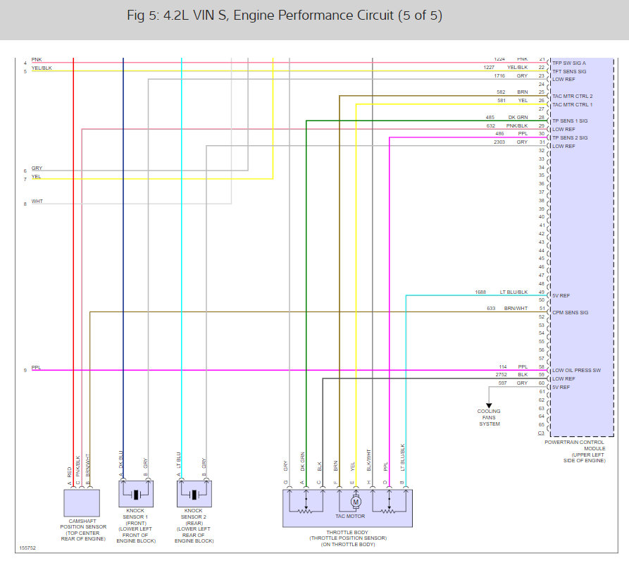

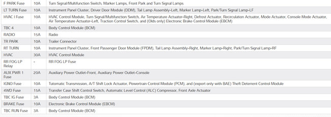

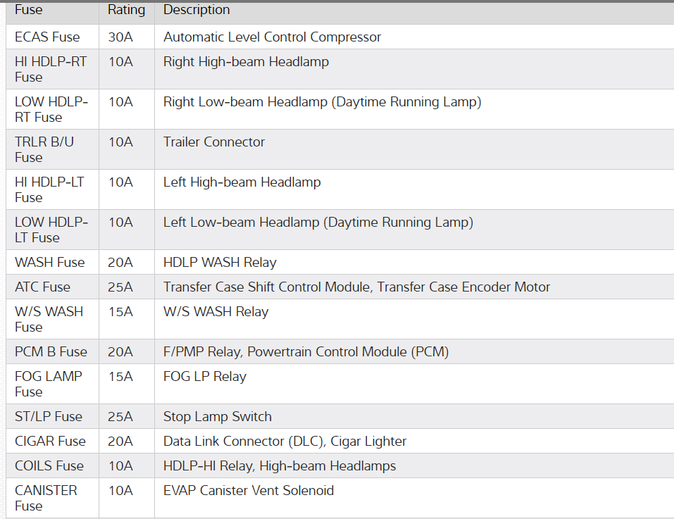

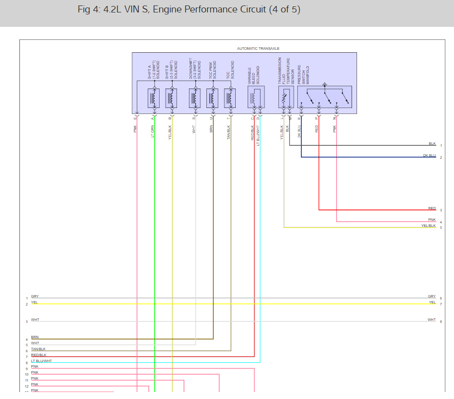

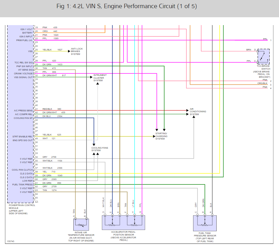

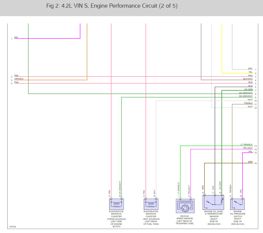

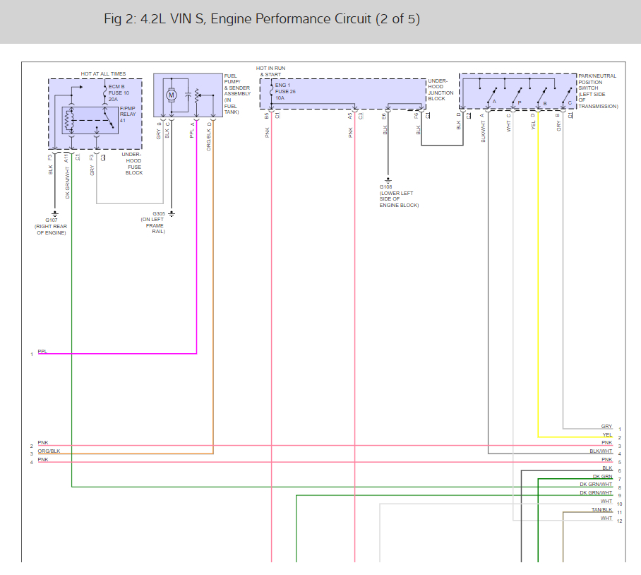

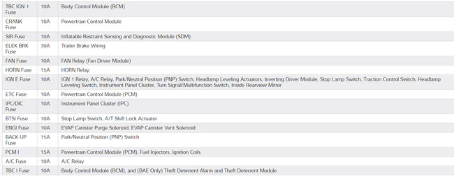

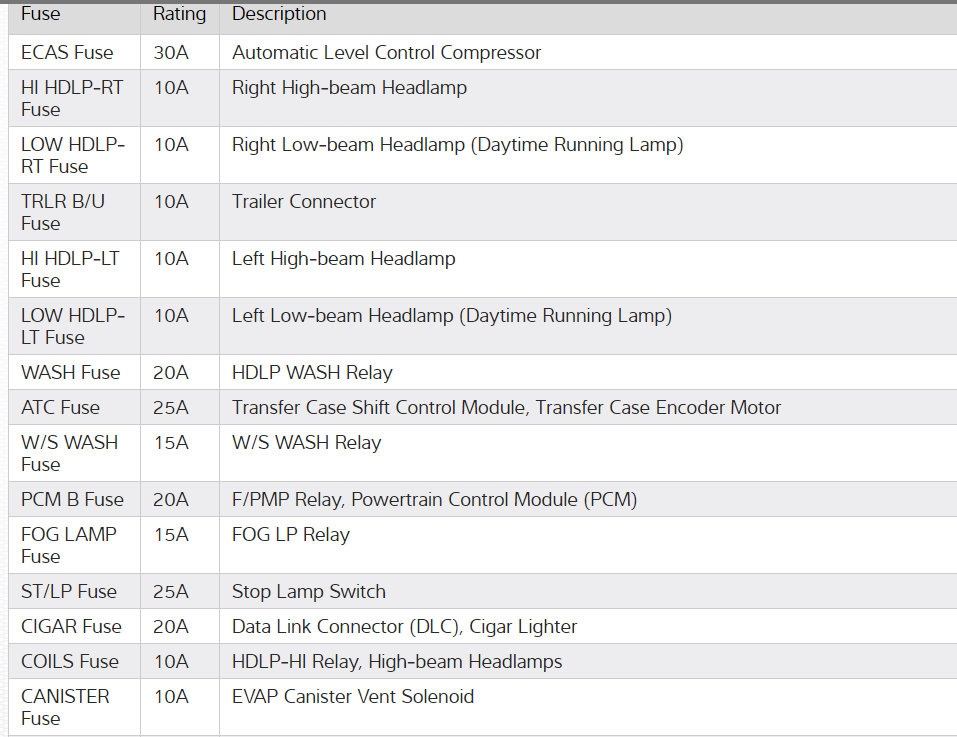

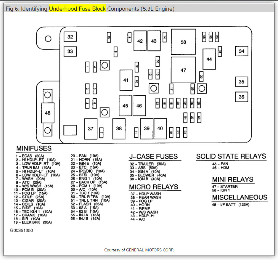

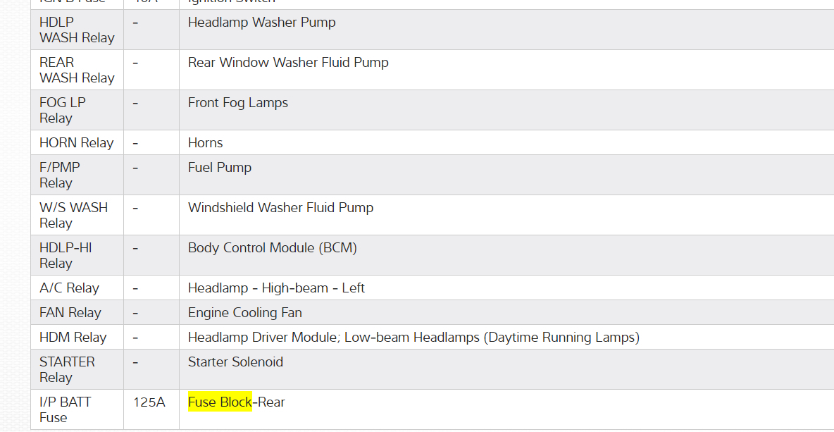

It sounds like the PCM is not getting power. Lets check by following this guide and checking out the PCM wiring diagrams below.

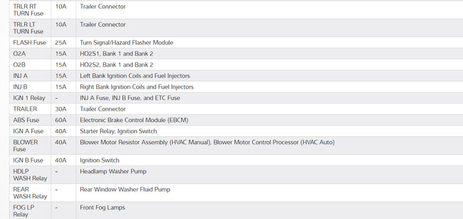

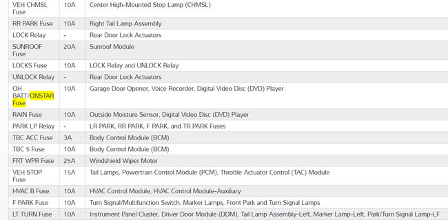

Check power at fuse #22, #10 and #47 here are the engine wiring diagrams and the fuse location.
Aug 13, 2018 at 7:05 AM
