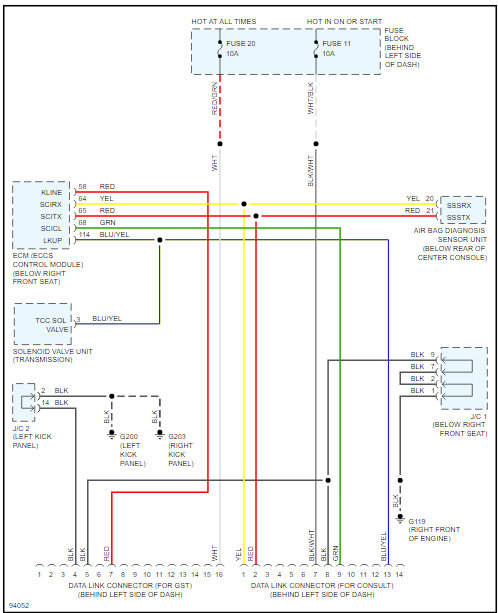

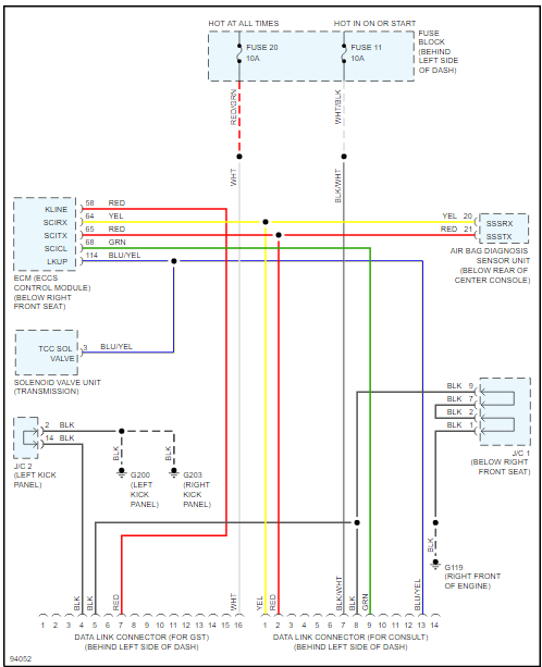

Trying to see whether I can use this ECM for my truck listed above.
Oct 13, 2019 at 11:32 AM
DANNY L
  • 5,648 POSTS
Hello, I'm Danny.

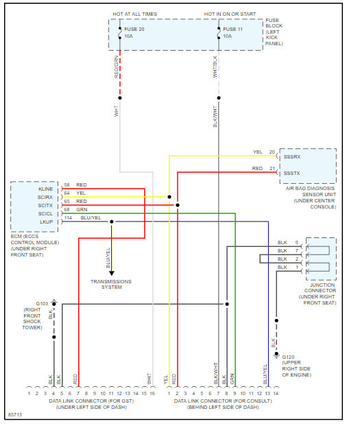

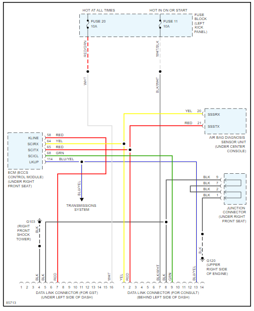

I'm not sure what your asking.. Are you tying to use a 1996 ECM on your 1997 Hard body ? I've attached 2 pictures of the ECM below. First picture is a 1996 and the second is for a 1997. Let me know and thanks for using 2CarPros.
Danny-
Oct 13, 2019 at 11:50 AM
PACIFICISLANDER
  • 239 POSTS
It looks like I can be able to use the 1996 PCM maybe I'm wrong.
Oct 13, 2019 at 3:41 PM
DANNY L
  • 5,648 POSTS
Hello again.
Yes, Both the 1996 and 1997 are both the same.Hope this helps and thanks again for using 2CarPros.
