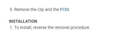

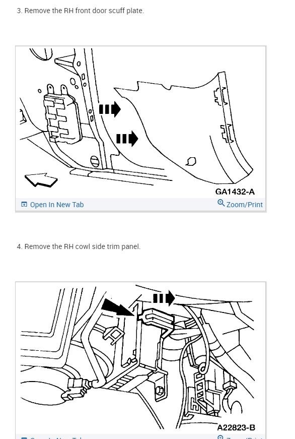

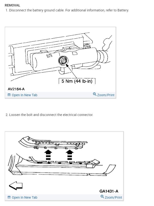

Good morning,
I attached the procedure and location of the ECM for you. The wiring connection is under the hood and the actual unit is under the dash driver's side.
