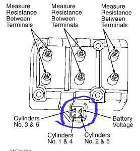

When it stalls is when you want to do testing. My first suspicion is a loss of spark, So use a spark tester to confirm this. IF so I would next want to get to the coil and check for any corrosion on any connections, but primarily at the bottom part of the coil that is circled.
https://images.2carpros.com/forum/automotive_pictures/30961_1coil1_1.jpg

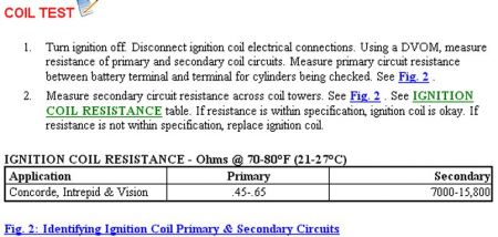

In the event you need this:
https://images.2carpros.com/forum/automotive_pictures/30961_1coil_1.jpg
Checking for fuel pressure is also recommened to know that it is only a loss of one, but not both.
