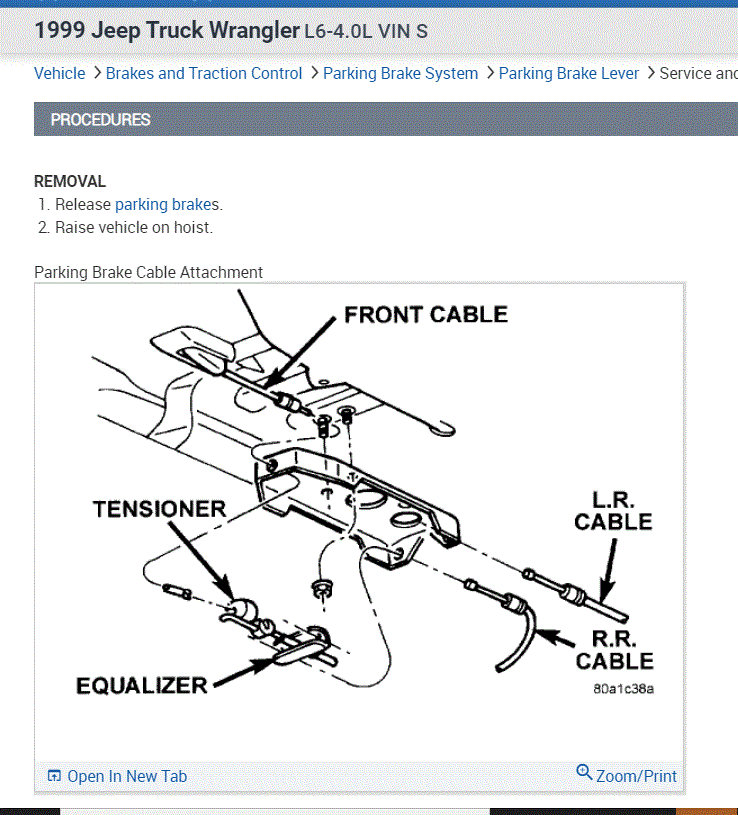

When I pull up the emergency brake handle it doesn't click and it doesn't stay in the up position. It doesn't have any tension. It immediately falls down.
Nov 23, 2021 at 6:25 PM
  • 110,194 POSTS

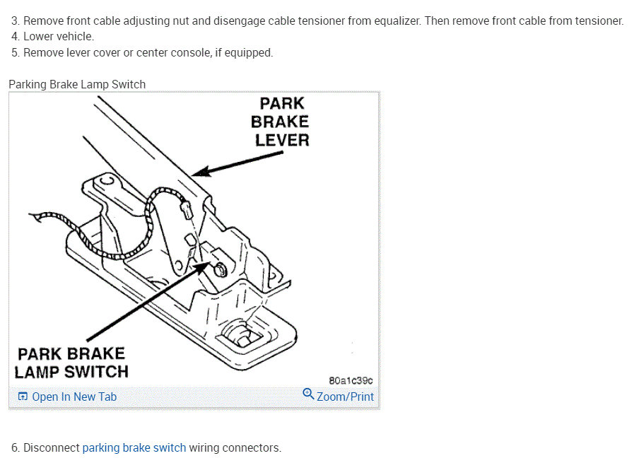

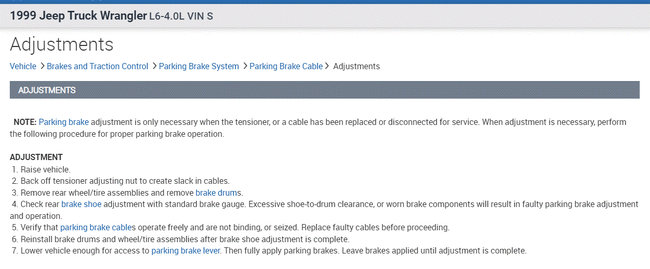

Do you mean the lever that you lift won't stay in the up position until it's released, or it does, and the brake needs adjusted?
The parking brake lever should ratchet, so if that doesn't happen, it will need to be replaced.
If it is simply adjustment, I attached the directions below for doing it.

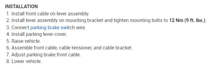

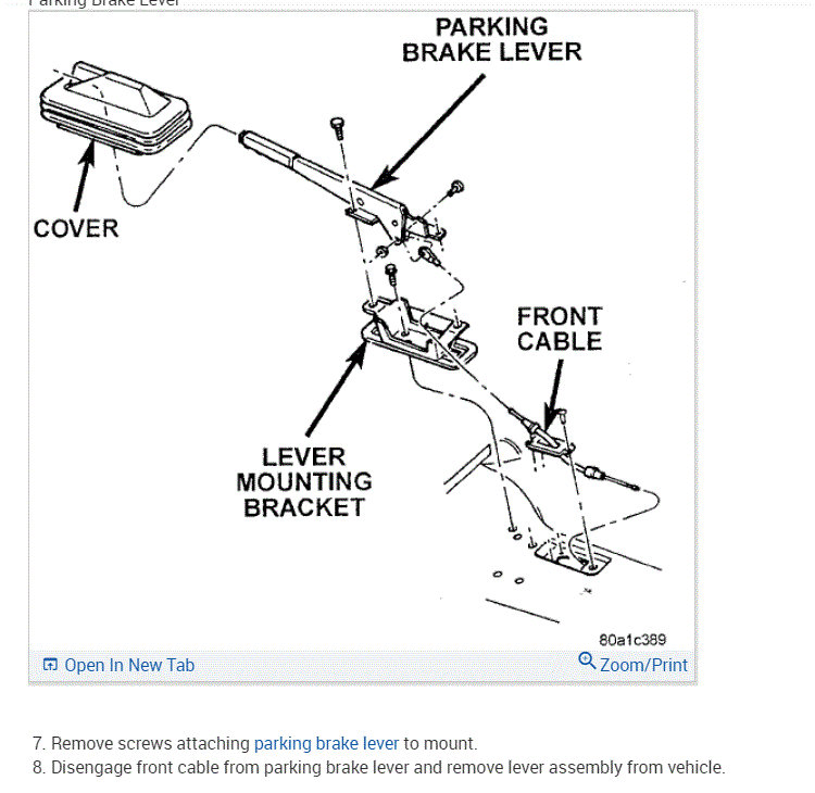

If it won't hold in place, you could try taking it apart and lubricating it to see if the parking claw releases and holds. If you can't get it to work, it will need to be replaced.
Just to clarify, when you pull up on the lever and hold it in the up position, does the parking brake work? Let me know so I can explain adjustment procedures if needed.
I attached the directions below showing how to replace the lever assembly. Take a look through them and let me know if you are comfortable performing the procedure or if you have questions. I'll do my best to help you from here.

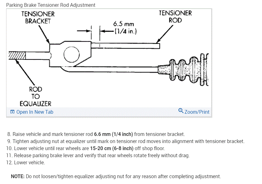

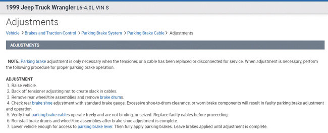

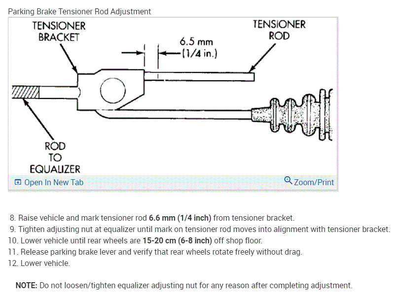

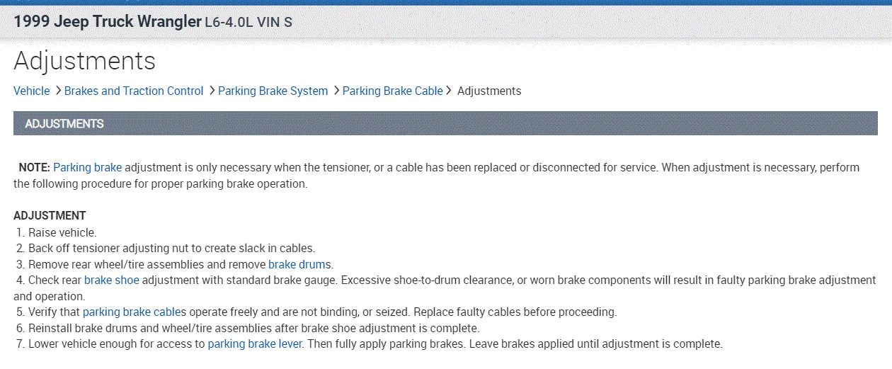

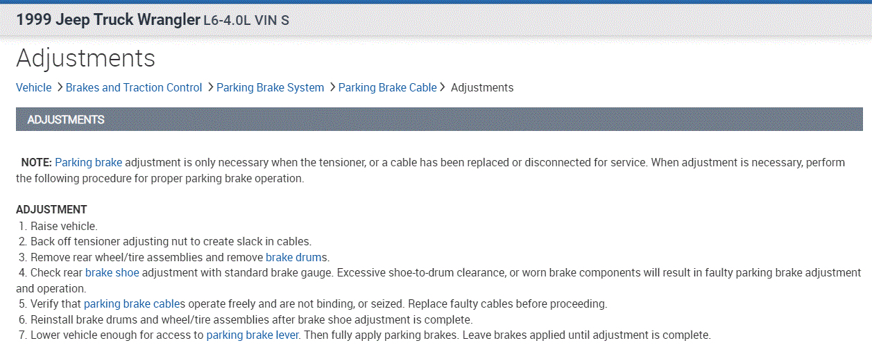

As far as the parking brake, it sounds like the system works, but the lever will need to be replaced. Were you able to try using something like WD40 on it to see if that helps?
As far as adjustment, the two pics below are the directions. Based on what you have already done, I feel confident you won't have trouble.
