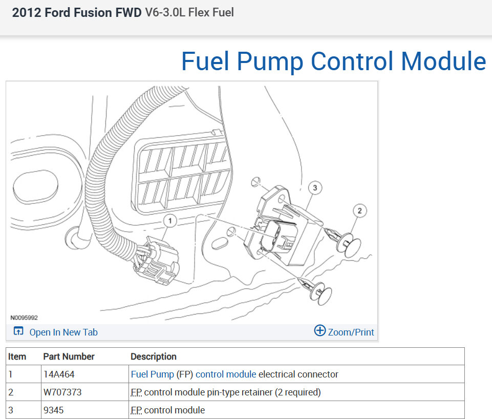

DTC p2196 and p2198?
2012 FORD FUSION
135,000 MILES • 3.0L • V6 • 2WD
GARLANDPERRRY
cannot complete drive cycle?
Apr 13, 2025 at 8:29 AM
  • 55,423 POSTS
How is the engine running? Also are the spark plugs carbon fouled? I have seen the fuel pump control module over voltage the pump and force too much fuel into the engine.
P2196 - O2 Sensor Signal Biased/Stuck Rich (Bank 1 Sensor 1)
P2198 - O2 Sensor Signal Biased/Stuck Rich (Bank 2 Sensor 1)
If all of the spark plugs are black, I would swap out the FPM. Here is a guide to help as well.
https://www.2carpros.com/articles/why-an-automotive-engine-will-run-rich
Position aside the LR quarter panel luggage compartment trim.
Disconnect the Fuel Pump (FP) control module electrical connector.
Remove the 2 pin-type retainers and the FP control module.
To install, reverse the removal procedure.
Clear the codes once completed. Check out the images (below). Please let us know what happens.
