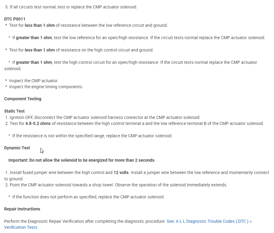

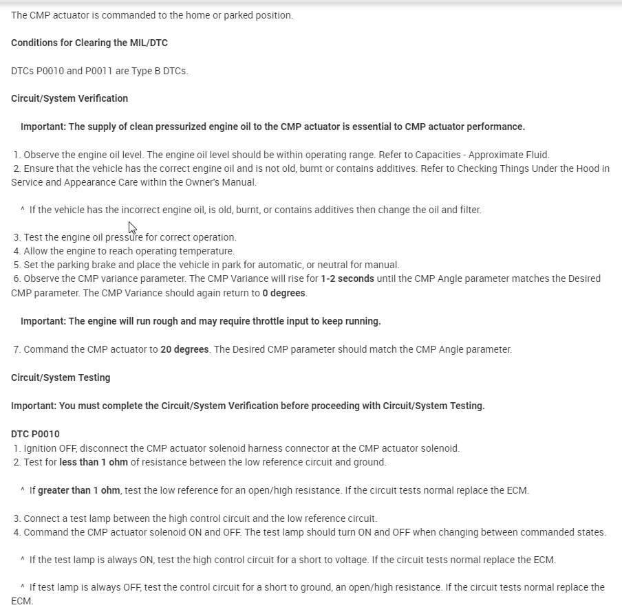

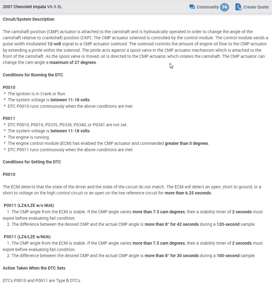

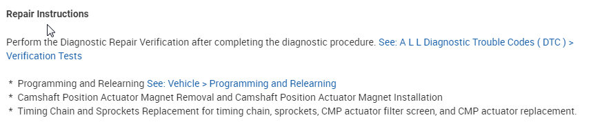

I attached the procedure for this code.
Basically this code is saying that the commanded position and the actual position of the actuator do not match. Normally it is a circuit issue. Short to ground, power, or an open.
Follow the testing through for this code and it should lead you to the issue. Let me know if you have questions or run into issues. Thanks
