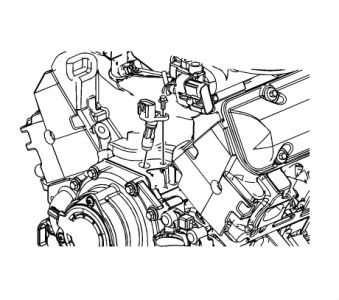

2006 Chevy Impala 6 cyl
how to install camshaft sensor
Oct 21, 2009 at 7:25 AM
BRIAN 1
Experienced Mechanic
1,030 POSTS
Remove the power steering pump. Disconnect the camshaft position (CMP) sensor electrical connector. Remove the CMP sensor bolt. Remove the CMP sensor. Inspect the sensor O-ring for wear, cracks, or leakage if the sensor is not being replaced
the 3.5 and 3.9 are the same.
