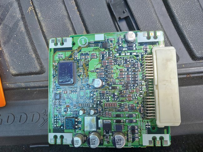

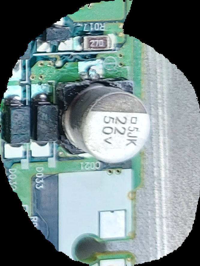

Hi, I found this piece broken and I stuck it back on with some crazy glue. Could this be the source? Should I buy a new mpx? I tested the unit again direct from the neg battery and it stayed the same.

Looking at the pics, I would say replace it. Chances are something is melted, or a solder joint is broken or cracked.

If that was just glued in place it is likely the problem as it is a capacitor and would have been soldered to the board below it. It looks more like the cap failed and leaked on the board though. Common thing with that cap design in larger sizes. If you have a good electronics repair shop nearby have them look at it, if it leaked but didn't damage the traces on the board it could be repaired and see if it works. I've repaired a lot of similar issues over the years because of faulty caps.

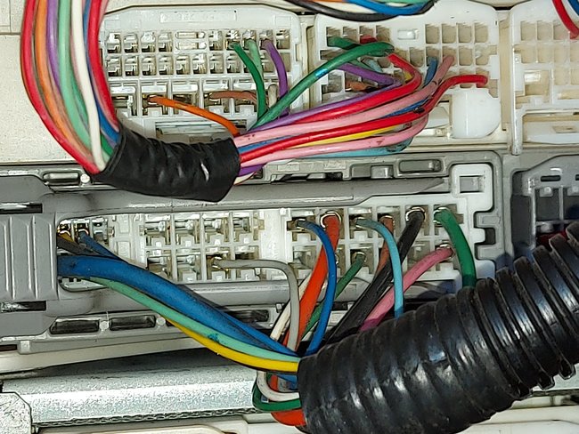

I tested the following connections.
Green--wiper starts to work when probed.
Black - - nothing
Brown - - nothing
Lt blue - - nothing
Red--nothing
Blue-battery dash indicator flashes when probed
Pink--nothing
Green--nothing
White--nothing
Grey-cigarette light works when probed.
Blue-ABS, PS light goes off when probed.
Where should I look now?
This module is connected to a fuse box.
Could the module be broken?
PS I used the duoyi dy18 probe circuit finder.

Did you replace the module and program it? If not, then that would be the first step.

Got the module and swapped it and everything works again. Thanks for the assistance.
