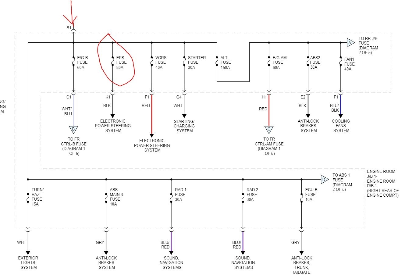

The codes wouldn't cause it but the problem that is setting the codes might.
The C1552 code is a failure in the power steering supply voltage while the B2286 is a power control ECU (not engine ECU, it's the smart electronics controller) fault. It is possible that both are related if the power or grounds are shared between them.
First thing on the power steering code would be to verify that there is power at the EPS fuse in the power center under the hood, it's an 80-amp fuse. It shares the power buss with some other systems. Do the flashers work? They also share that power source. From there you will need access to a factory level scan tool to run the control tests for the modules in order to see if the network is in control or if there are multiple modules that cannot access the network.

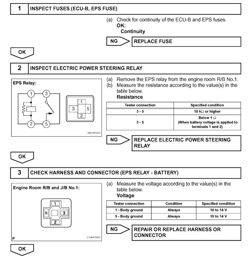

I pulled the EPS fuse and tested it with the car battery and it made the clicking sound.
The factory tool would this be Techstream?

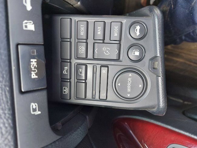

This is the list, nothing automatic works.
Car: starts and runs but AT will not shift normally.
Not working:
windshield wiper auto
Radio
AC
Right side back window (the rest work)
Temp Gauge console
Shift console gear indicator light
Cigarette light (no voltage)
Left side panel
- odo trip, odo sensor, rear window shade, invert/control side mirrors, parking sensor.
Rain sensor wiper.
Auto light.
Steering buttons.
Windshield sprayer.
Fusses that are not working:
Right side panel.
8 Air Sus No Voltage
9 Power Outlet Low Voltage
10 Cigarette Lighter Low Voltage
11 Acc, Low Voltage
14 Ecu-Ig Rh Low Voltage
15 Fr S/Htr-Rh Low Voltage
16 Rh-Ig Low Voltage
Left Side Panel
26 Panel No Voltage
27 Fuel Open No Voltage
All the fuses listed above were tested for resistance and all were good.

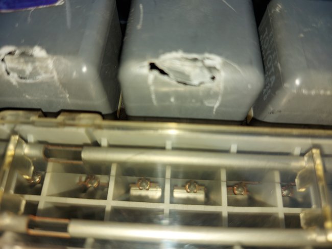

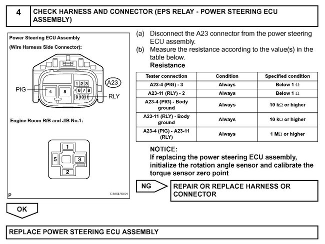

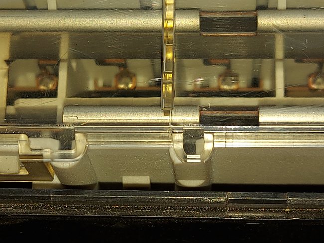

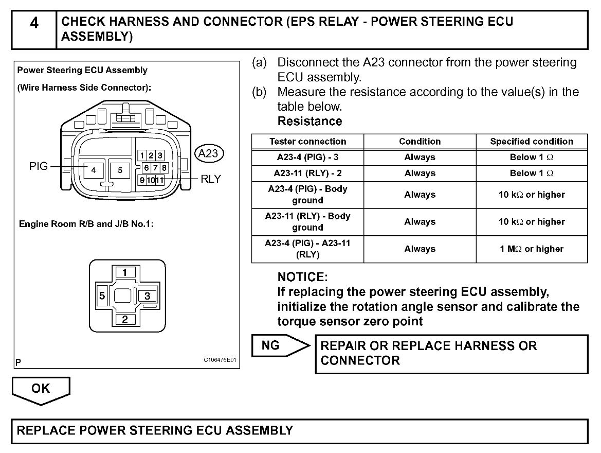

I started with the EPS relay and connector.
EPS connector voltage 1 = 12.49V
EPS connector voltage 5 = 12.49V
Did an ohm test but the results were strange.
I applied 12v to the relay and when I tested it did not go to zero. Tested the relay next to it that yes went to zero. So, I switched the relays and there was no difference. The relay next to the EPS is the headlight. Even with the faulty one the headlight came on.
Pics: One the connections look damaged can that be?
Nov 5, 2021 at 8:22 AM
STEVE W.
  • 15,351 POSTS
That could be the issue, the relay contacts are under that cover, and it could be that the armature isn't connecting on the top. Swap it with a new one and see what you get. Or pry the cover off and check what the relay is doing, could be a piece of plastic causing it to stick.

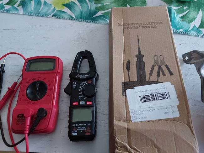

4. Could this help me get a more definitive answer: Power Probe Polarity Identify Electrical Tester Short and Open Circuit Tester Automotive with LED Test Light, or what would you guys recommend finding the short?

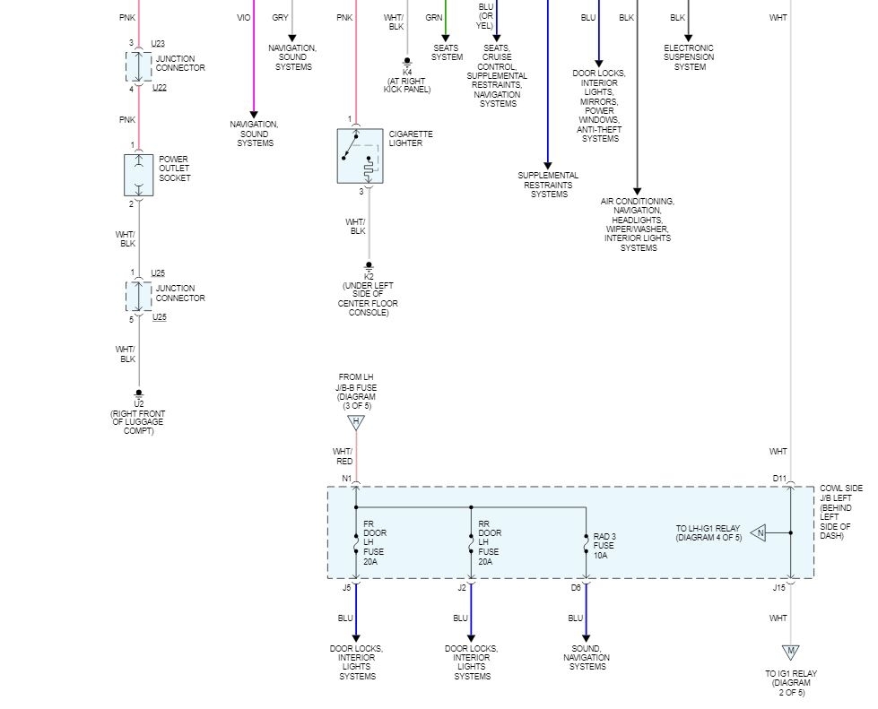

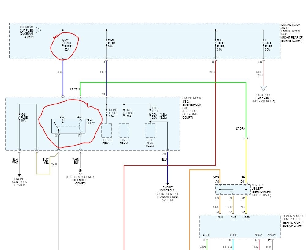

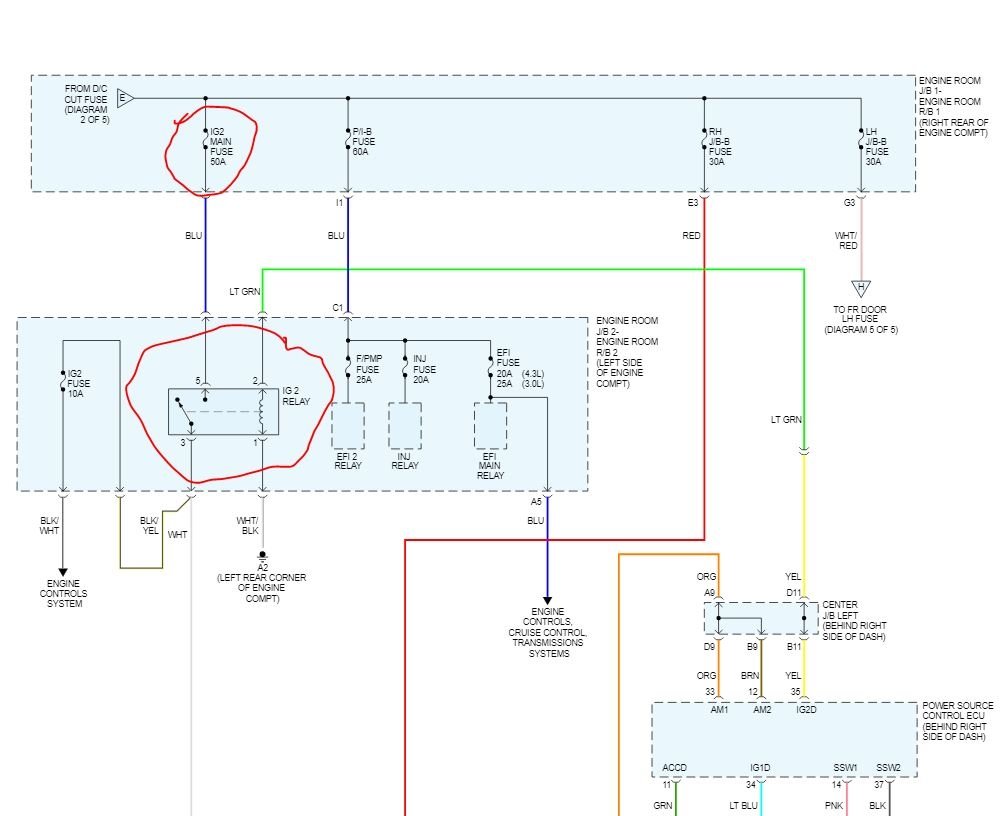

I don't believe it's a short but an open, likely inside the PCU, if you can dig it out of the dash you can use the wiring diagram to check the powers and grounds and see if the power out of the box is okay. It powers the circuits you show as having no power. Testing that will be the first step, if it tests good then the issue is in the harness to the junction box.

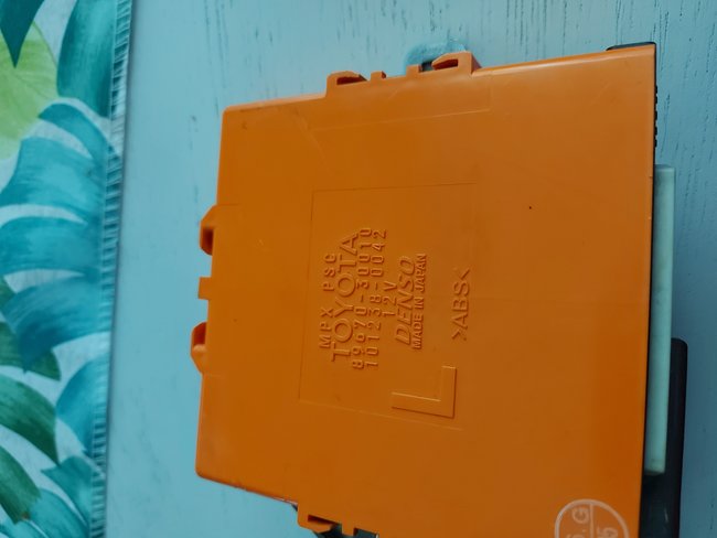

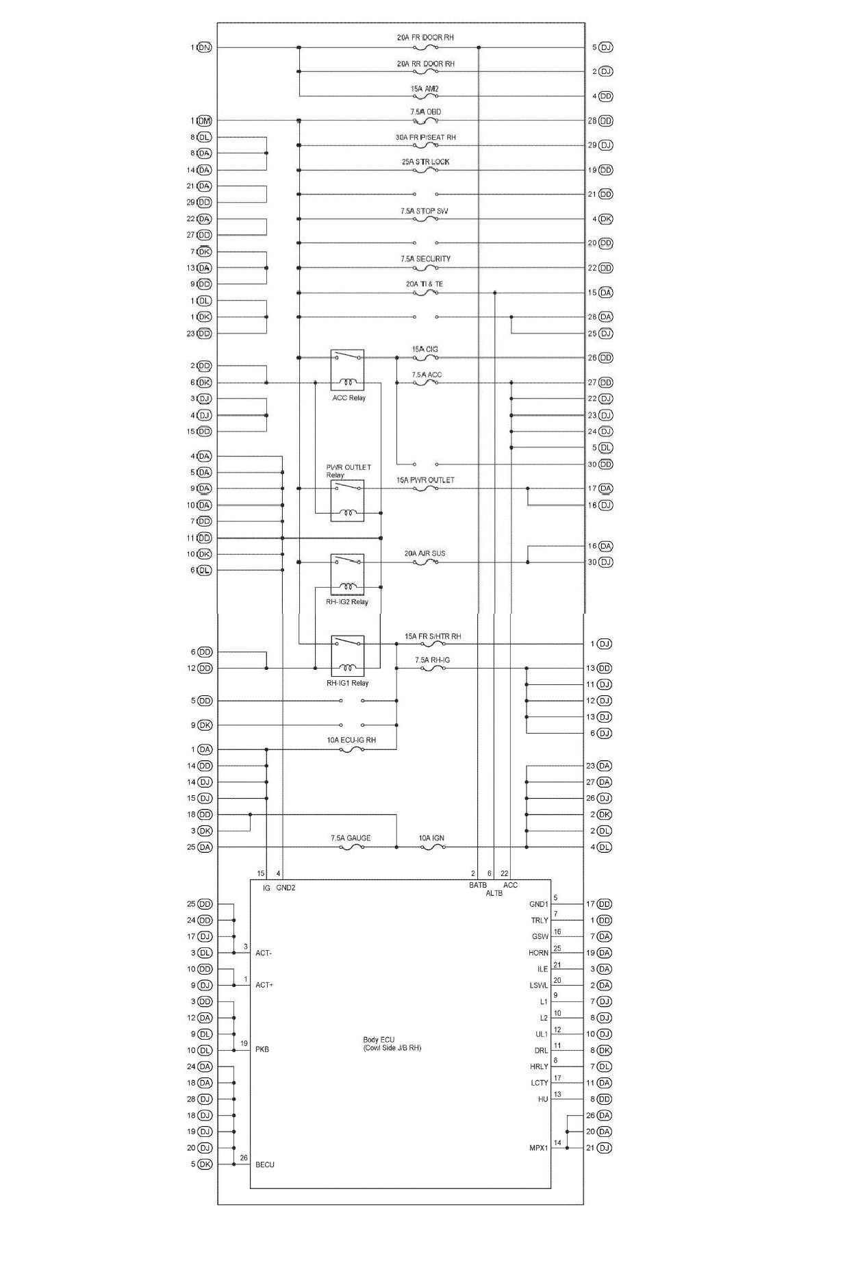

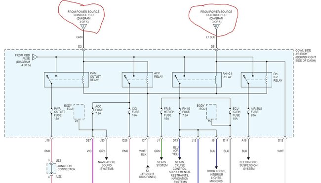

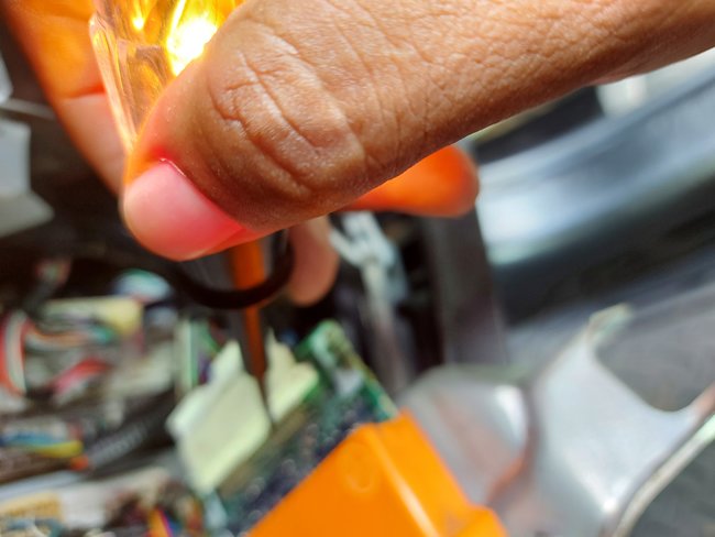

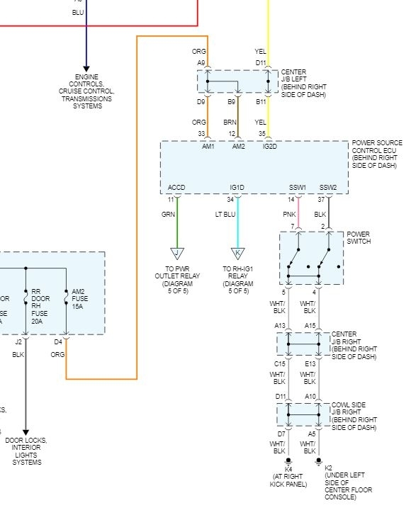

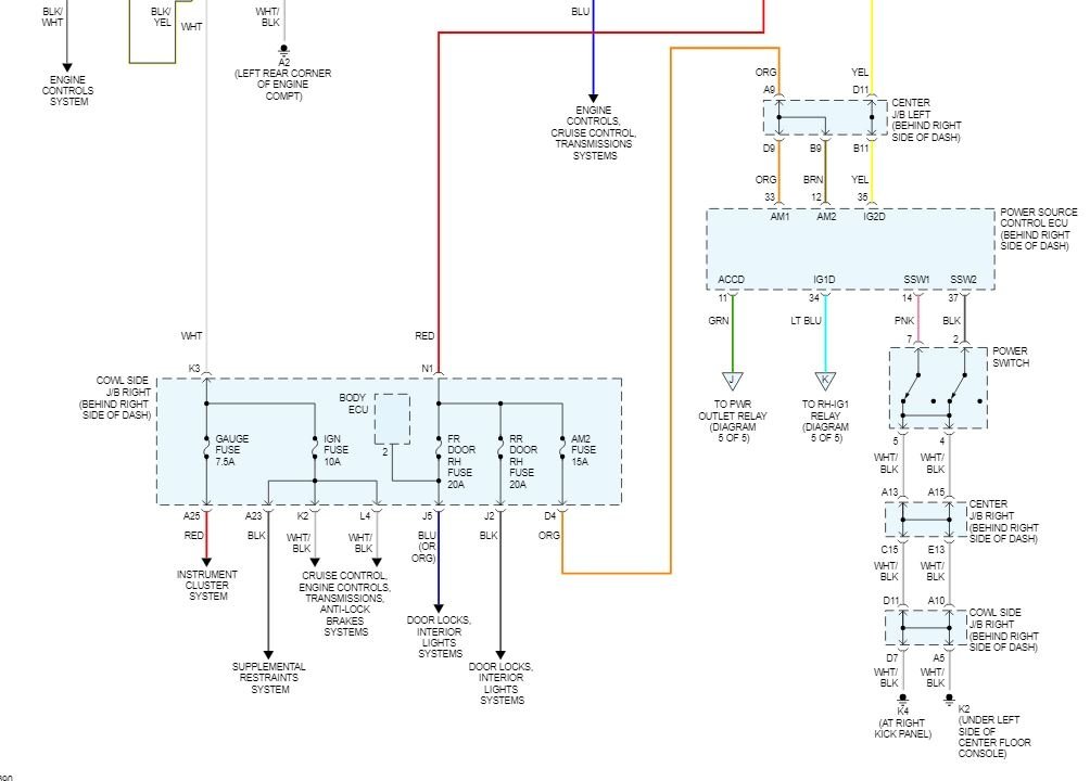

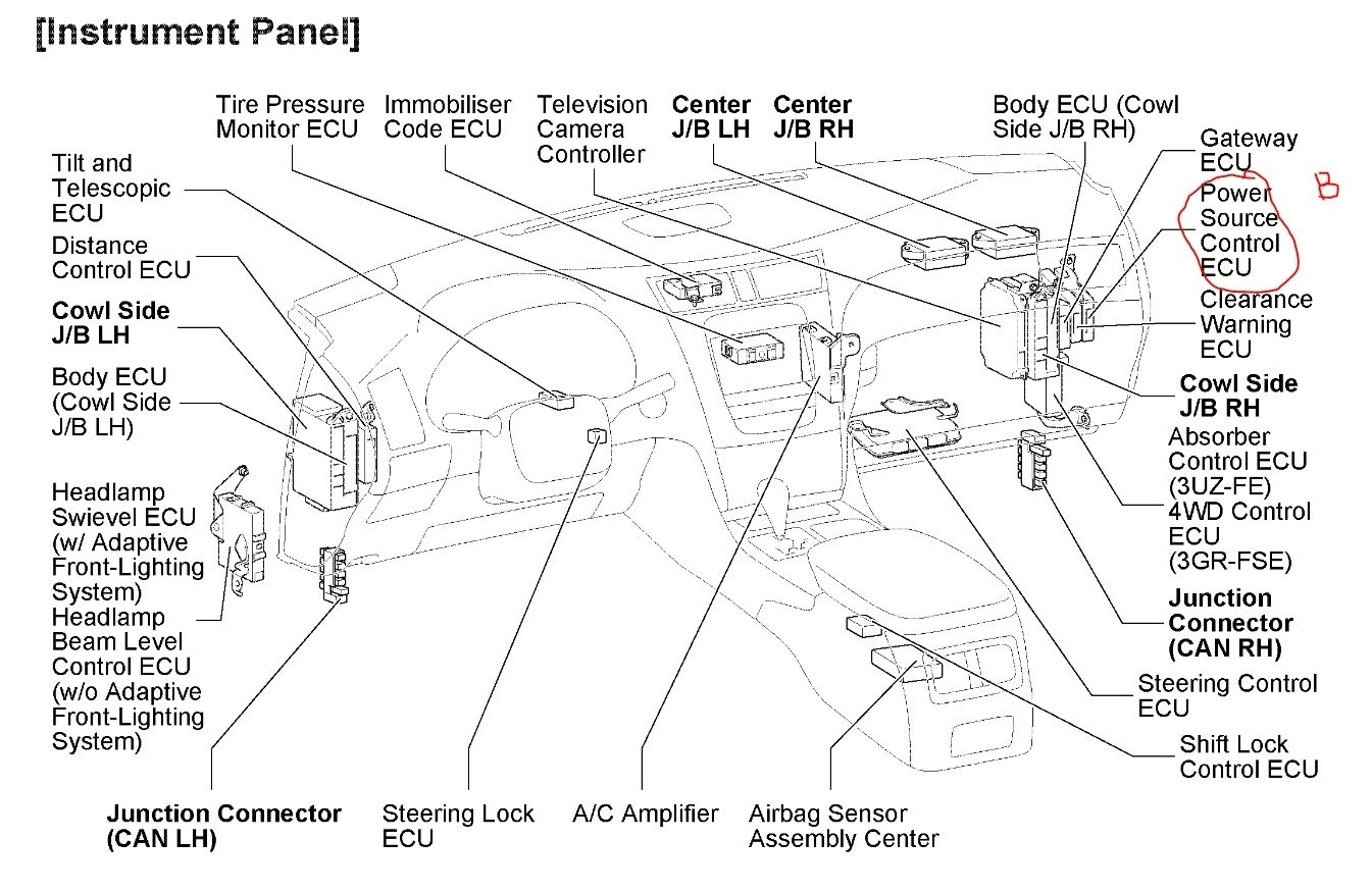

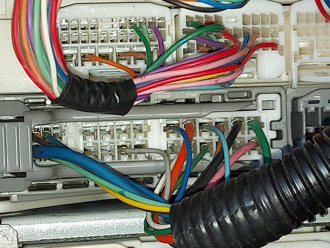

Hi guys, I finally got a chance to work on the car. I found the power source control see pics. Now how do I test it, I have the following tools?
Thanks
Dec 10, 2021 at 4:33 AM
STEVE W.
  • 15,351 POSTS

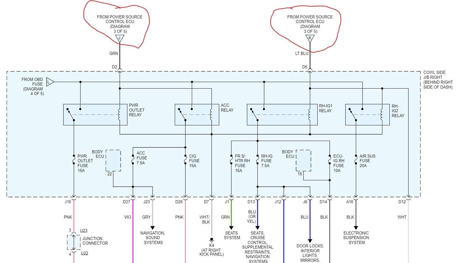

It can be tested installed in the car, you need to use the diagrams above to test the power going into the unit, so the test light connected to ground to test for power on the orange, brown and yellow leads going into the unit, then check the grounds on the black and pink wires to be sure you have a good ground. If you have the constant battery power on the orange and brown wires and the battery power on the yellow wire is turning on and off with the relay as you turn the key on and off. Check to see if you are getting power out of the unit on the green and light blue wires. If either one doesn't have power the box is bad. If you don't have power into the yellow wire when you turn the key, then check the ignition 2 relay in the power center.

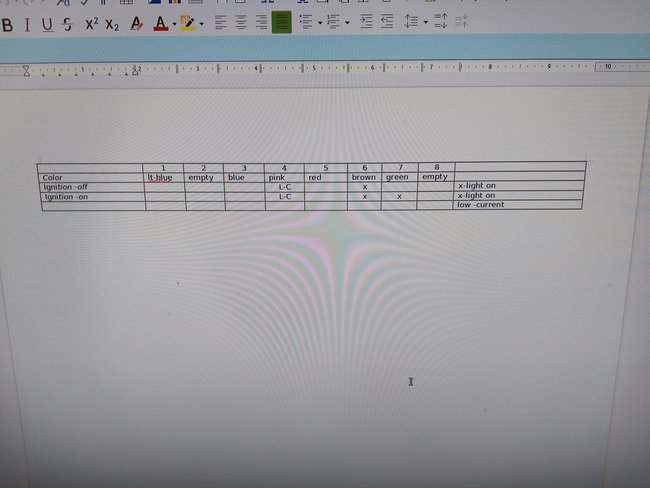

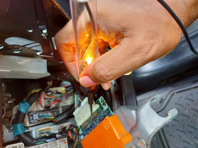

I tested the wires with a circuit tester.
See pic and table.
Green ignition on - light
Green ignition off - no light
Brown ignition on - light
Brown ignition off - light
Pink ignition on - low current
Pink ignition off - low current
Dec 17, 2021 at 10:12 PM
STEVE W.
  • 15,351 POSTS
The pink and black should both ground with the switch on and have no ground switch off. If you get a dim light with the switch on and the test light connected to battery power the ground is corroded or the wire is. Poor grounding can cause the unit to shut off one section and give you the results you are seeing. Check the grounds from the pink wire, or for testing turn the key on and run a jumper to a good ground from the pink wire.

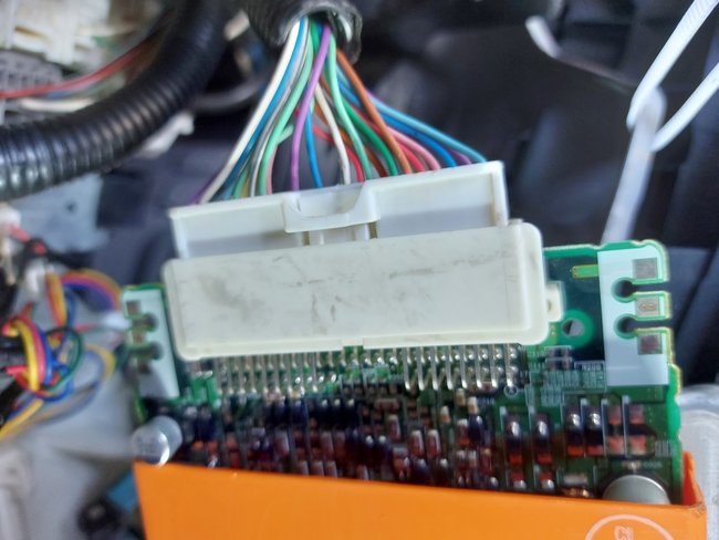

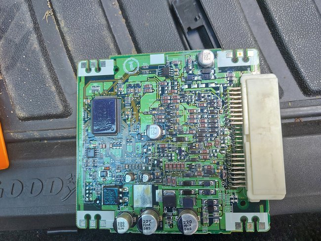

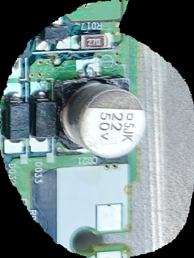

Hi, I found this piece broken and I stuck it back on with some crazy glue. Could this be the source? Should I buy a new mpx? I tested the unit again direct from the neg battery and it stayed the same.
Dec 22, 2021 at 10:00 AM
  • 110,244 POSTS
Looking at the pics, I would say replace it. Chances are something is melted, or a solder joint is broken or cracked.
Let me know how it turns out for you.
Dec 22, 2021 at 1:16 PM
STEVE W.
  • 15,351 POSTS
If that was just glued in place it is likely the problem as it is a capacitor and would have been soldered to the board below it. It looks more like the cap failed and leaked on the board though. Common thing with that cap design in larger sizes. If you have a good electronics repair shop nearby have them look at it, if it leaked but didn't damage the traces on the board it could be repaired and see if it works. I've repaired a lot of similar issues over the years because of faulty caps.
Dec 22, 2021 at 6:55 PM

Hi guys,
I tested the following connections.
Green--wiper starts to work when probed.
Black - - nothing
Brown - - nothing
Lt blue - - nothing
Red--nothing
Blue-battery dash indicator flashes when probed
Pink--nothing
Green--nothing
White--nothing
Grey-cigarette light works when probed.
Blue-ABS, PS light goes off when probed.
Where should I look now?
This module is connected to a fuse box.
Could the module be broken?
PS I used the duoyi dy18 probe circuit finder.
Jan 24, 2022 at 1:39 AM
STEVE W.
  • 15,351 POSTS
Did you replace the module and program it? If not, then that would be the first step.

Got the module and swapped it and everything works again. Thanks for the assistance.
