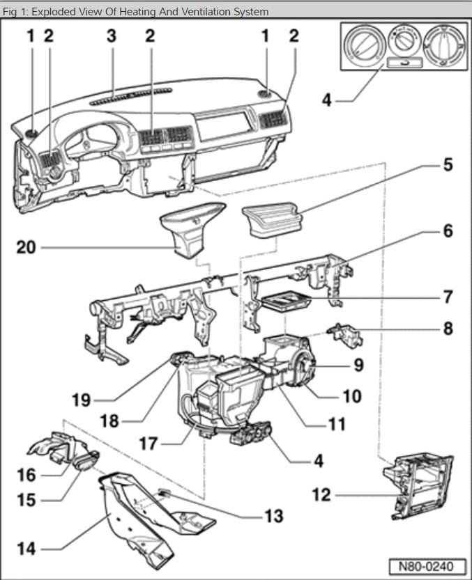

Okay, I had a piece of paper that I needed to put right against windshield from inside the car because it was a parking permission slip for this hotel I am staying in, the paper is small and kept slipping. long story short I was multi tasking and had keys to the car in my hand when I fell into dash (muti tasking here, had two duffles and was thinking I would quickly lean in and be done). I then dropped my car keys into the vent on top of dash! There no vent grill on one side (driver). How am I to get them out? I cannot drive anywhere for help, I do not know who to call, and I have torn up my car by pulling out every plastic thing possible around the vents, stereo, and ashtray. I even pulled the front of glove box off, which did not help because now all I have is a glove box with no door. I have crawled down below steering wheel and on passenger side where blow motor thing is on the center piece (because yeah I tore that panel off too). My car looks hella broken into, I have Googled many topics that have not helped and still no keys! Please help!

If you just want to continue removing parts, I assume the keys fell down the vent shown here as #3 into the defrost duct, shown as #20.
Here are the instructions for removing that duct:
Defroster duct
Replacing:
Remove and install instrument panel. Refer to 70 - INTERIOR TRIM
Loosen instrument panel cross member
Note installation position.
There is a lot involved in removing that instrument panel and the book says about 4.5 hours as well.
