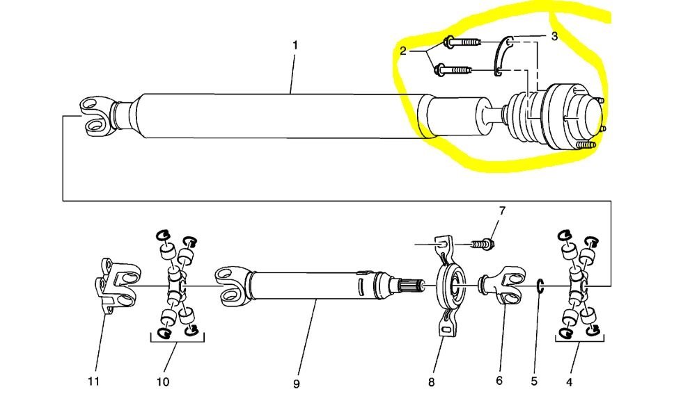

Is this the joint you are talking about? If it is, why did you remove the boot?

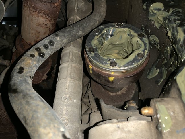

The boot stayed in the transmission how do I get that out?

In the picture I sent you, there are bolts you remove for removing the shaft. They are marked number 3 in the diagram. That will separate the joint without removing the boot.
Somebody must have pulled very hard to release that boot.

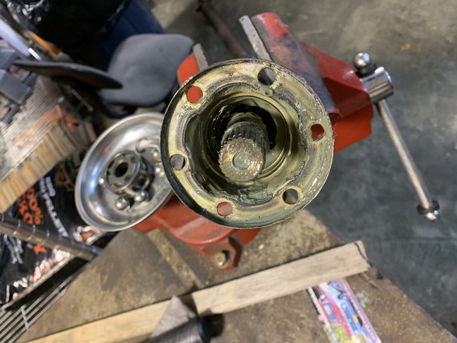

The bolts were removed but the boot did not come out, just what I showed you in the picture.

The second picture is of what stayed in the transmission.
Saturday, April 13th, 2019 AT 5:26 PM
  • 52,797 POSTS
Okay, there is no service procedure for this constant velocity joint.
Replace the propeller shaft half if any of the following occur:
Important: The constant velocity (CV) joint assembly is not serviceable. If the dust boot is torn or the joint is worn or damaged, replace the propeller shaft as an assembly.

Okay, thank you. Now to figure out how to get that piece out of the transmission.
Saturday, April 13th, 2019 AT 5:42 PM
  • 52,797 POSTS
Use a small hammer. That piece will split in half. You may need a screwdriver to help split the joint. It does not come out of the transmission, it splits past the where the bolts were.
