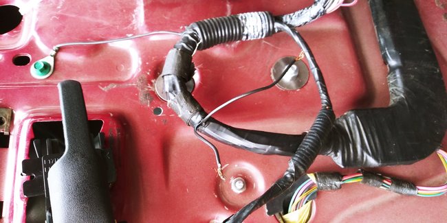

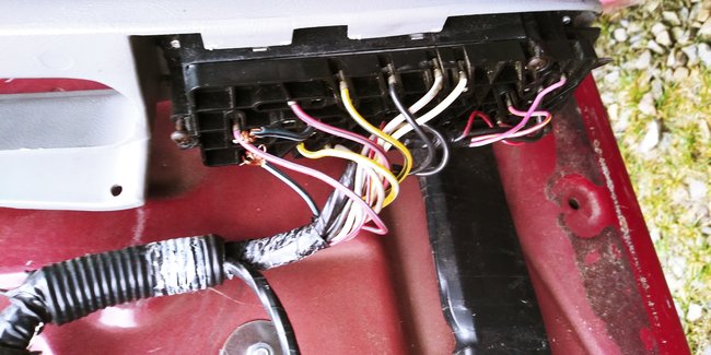

Okay, so when I bought the vehicle listed above 6 weeks ago it had 2 main issues. Wiper motor replacement and window motor/regulator replacement. The parts came with the vehicle it was a simple deal or so I thought. The door panel had been removed and the window was being held up by a board. The door switch control part was tied to the door frame with a zip tie but other than the drivers side the other windows worked from main switches as I used them when I drove this home. After my brother came over to look at my purchase and he being an electrician was troubled by the door wiring as there was black tape holding wires together. I ran up to get a meter and to make a long story short my bro and I have not spoken to each other in over a month because I wanted to take a picture of how the wires were before he undid them. Now he will not tell me what he did and I need to use a hot wire to operate the switches except for lock and unlock. The outside combination lock also works. I'm getting ready to put the door panel back on and I am at a loss I do not know what the black/blue and black wire is for on the door. I see the two light/dark blue wires match on the wires coming from the switches but other than that I cannot get it to work again. As I stated it was McGuyvered up and useable on my way home from purchasing it now I cant get them to work. I have attached a few pics. thanks

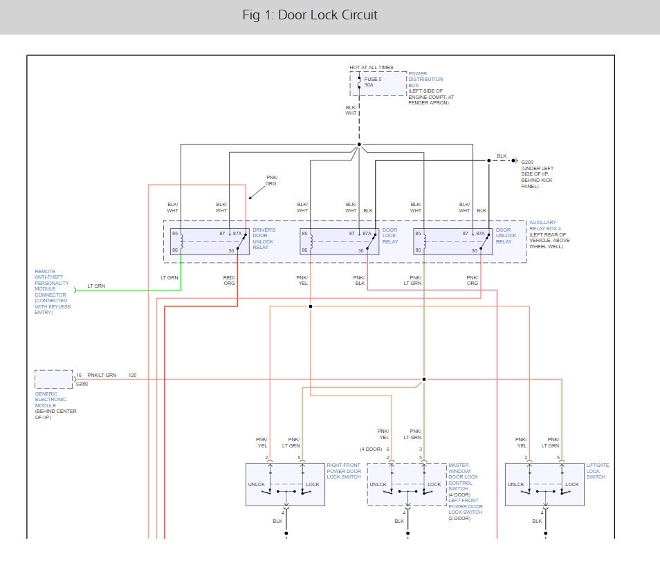

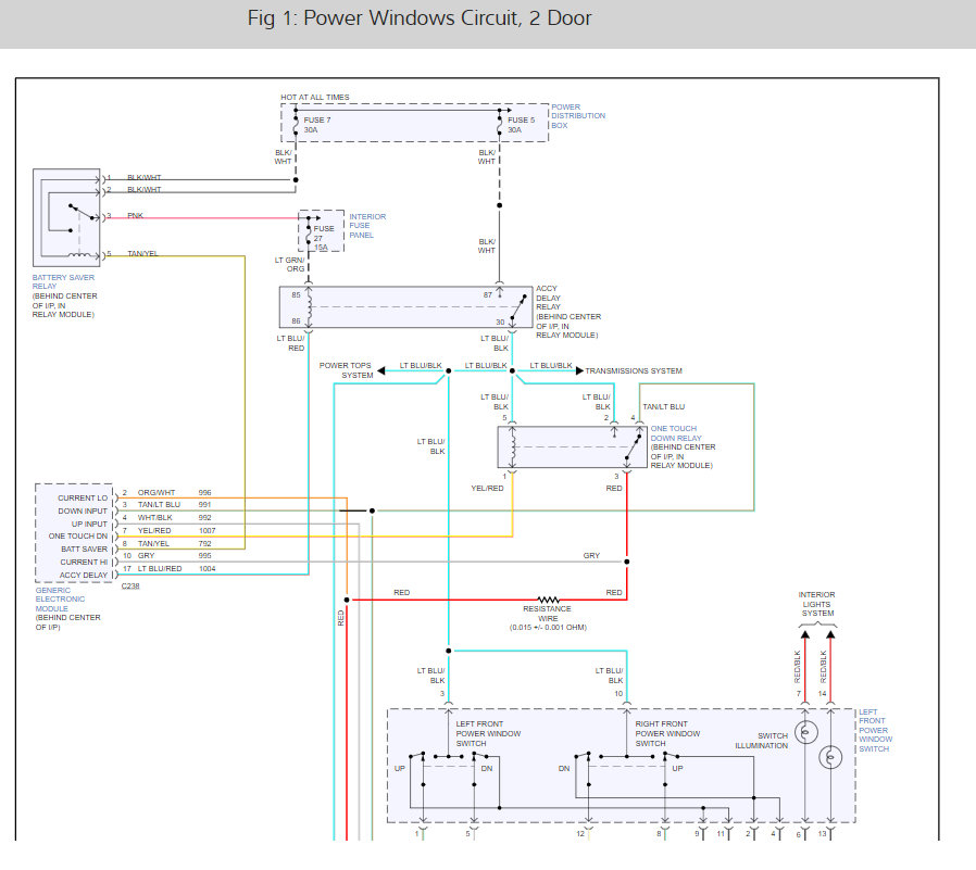

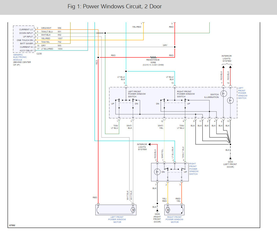

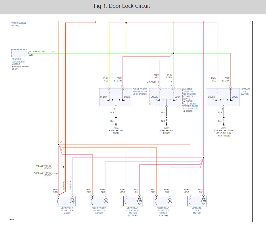

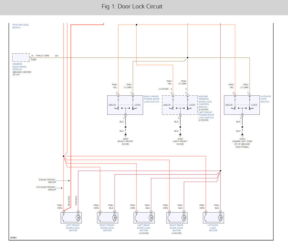

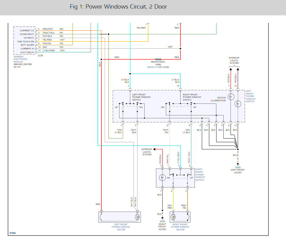

Thanks for the images. Yep, that needs some work to fix. Here are the door lock and window wiring diagrams with the guide to help you check them:

It's hard to say to sell it or not, if it were me I would cut open the damaged parts and just wire it the way it is in the diagrams and get rid of that plastic mess in the door jam and fix the connector.

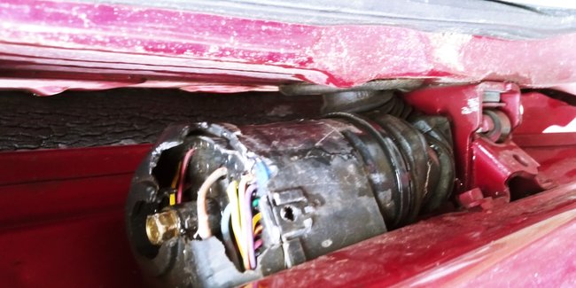

Thank you for the reply. I'm actually halfway there. I'm very proud of myself using the diagrams and wire troubleshooting guide. I also have a 1995 Ford Explorer wiring and vacuum diagram book. I've learned though. It can be frustrating but it's also rewarding in its own way. Will post pictures , issues I found and what I did to fix it. I went to a salvage yard today and I'm hoping to get everything done tomorrow. Thank you. 1995 was a horse of a different color. Wow! Someone told me to always save receipts and see if I can return parts I've bought because even though the claim is that the part is an exact fit for my vehicle does not mean it actually does fit! I got sent a 5 pin. Wiper motor instead of the 6 pin I need. So.I found one today at the salvage yard on a 1996 that still has 01/21 inspection sticker on it. I'm thinking that motor that worked with hot wire is like half bad if that's possible. I'm making some progress thanks to this site. Have a great night!

The window diagrams you gave me were for a 2 door. Mine is actually a 4 door. Would the wiring still be the same? The color diagrams are great!
Jan 13, 2021 at 3:49 PM
  • 55,433 POSTS
yep, they are the same.
