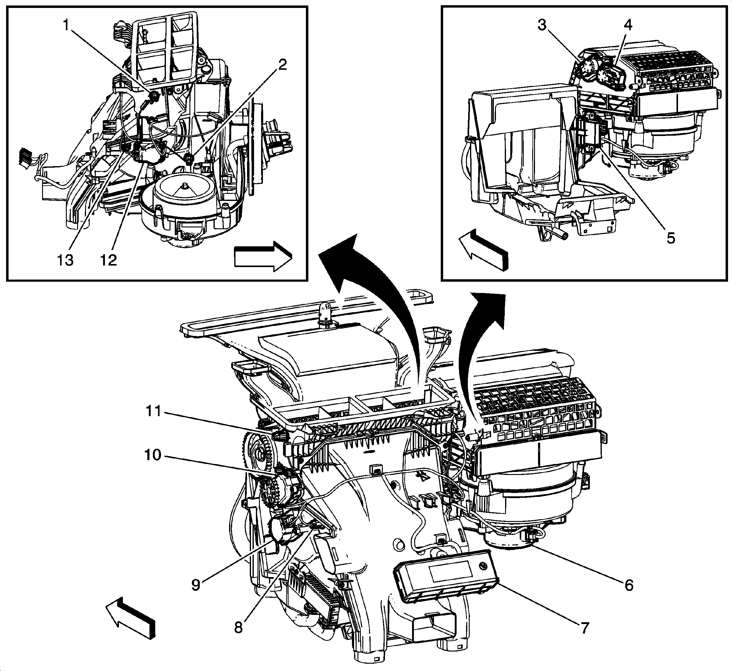

I attached a pic below. Here is a list which is a legend identifying the components related to the HVAC. Take a look at it to see if there is anything close to where you heard the noise. Please keep in mind, a sensor won't make a clicking. It has to be a motor.
Here is the list:
1 - B7J Air Temperature Sensor - Duct Right Upper
2 - B39 A/C Evaporator Temperature Sensor
3 - M4 Air Inlet Actuator
4 - M46 Air Recirculation Actuator Motor
5 - K8 Blower Motor Control Module
6 - M8 Blower Motor
7 - K33 HVAC Control Module
8 - B7D Air Temperature Sensor - Duct Left Lower
9 - M6L Air Temperature Door Actuator - Left
10 - M37 Mode Door Actuator
11 - B7H Air Temperature Sensor - Duct Left Upper
12 - M6R Air Temperature Door Actuator - Right
13 - B7E Air Temperature Sensor - Duct Right Lower

Sounds somewhere in the area of 11. Behind the radio area if I am looking at it right.
Dec 22, 2019 at 4:09 AM
  • 110,241 POSTS
If that is the area, then I would suspect it's actually number 10. That is a mode door actuator and not a blend door. That is responsible for air flow direction.
Tell me. Is it possible for you to have a helper turn the temp controller to cause the noise while you try touching the actuators to see if you can feel it vibrate or grind?

Okay, I think #9 is the actuator I already replaced. Is #10 an actuator with a gear on it? I just went out and looked to see what all moved.
Dec 23, 2019 at 5:51 AM
  • 110,241 POSTS
Yes, number 10 is the mode door actuator. It is an electric motor which has plastic gears inside.

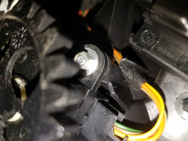

Tried to take a picture of the one I see. I dont see that it turns when I change the temp setting. It connects to some white gears.
Dec 24, 2019 at 6:55 AM
  • 110,241 POSTS
I believe that is the mode door actuator. It should change if you switch air flow direction.

The plastic gears I see which change the direction have all the teeth. The clicking noise is coming from the actuator as I can feel it like catching on something when it makes ththe noise. Hope you had a good new years! And yes I miss the "old" stuff myself. Hence why my race car pull truck is an old diesel. Lol
Jan 2, 2020 at 6:39 AM
  • 110,241 POSTS
That sounds like fun. What kind of car is it you race?
As far as the actuator, if you feel it, there is a good chance the internals of it have failed. There is a gear on the motor that may be bad or even something could be letting it move around and not make good contact.

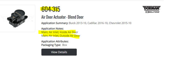

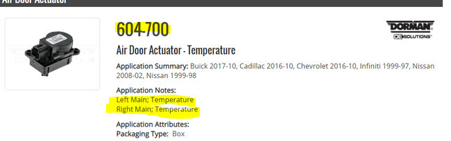

So while doing some searching, it appears there are 2 different Dorman numbers that the actuator could be. 604-315 or 604-700. Quite a but of price difference but very similar looking. Wonder if I am getting the wrong one. Or what the difference would be?
Jan 6, 2020 at 10:36 PM
  • 110,241 POSTS
I looked on Dorman's website and found that one is for air temp and the other is a fresh air door actuator. Take a look at the two pics below. You need the 604-700. Which one did you get?

Was supposed to be the 700 when ordered but actually looks like the other ones markings. It was not an actual Dorman #. I may just order an actual Dorman one that way i know its right. Then when I install I can see if the door is actually hanging up.
