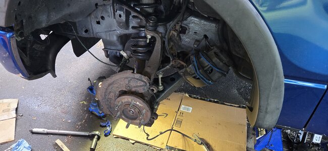

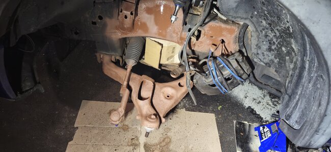

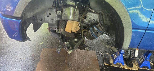

  • 6 POSTS
Driver side before I buttoned it up. Used rust killer on the parts and areas that I couldn't afford to replace including parts of the frame and shock Tower. Primed it painted it with some Rust-Oleum and good as new.
May 31, 2024 at 1:36 PM
  • 110,236 POSTS
It looks like you did a really nice job. As far as the additional work you plan to do, let me know if I can help in any way.
