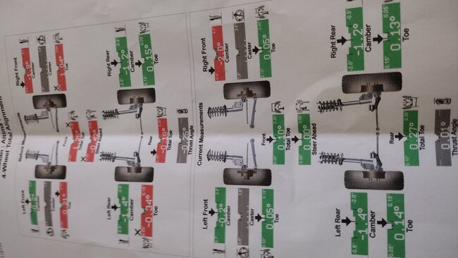

Hello, I recently replaced my passenger side strut CV hub etc. My car was pulling hard right replacing the strut corrected the problem. It's time to replace the driver side. My question is the passenger side was 2.0 camber. I need to know what kind of reading I need on the driver's side. Included a printout from the front-end shop before I replaced the passenger side strut.. Thanks for all your help. JC

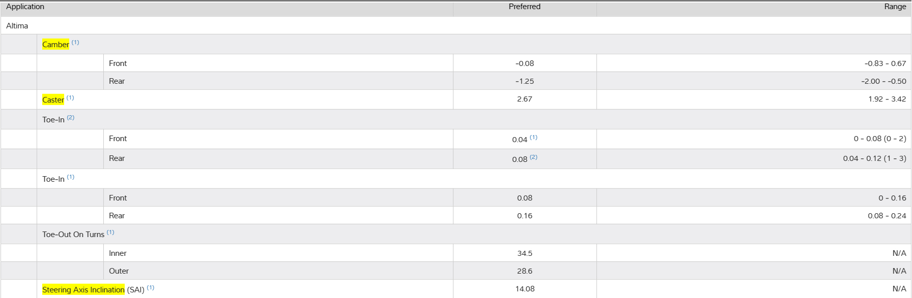

Hello JC-842,
I have added an image of alignment specifications for your vehicle.
I didn't know the sub-model, so I checked all four that were available to me. GLE, GXE, SE and XE. They are all exactly the same.
Let me know if I can provide any other information for you.
Hope this helps.
