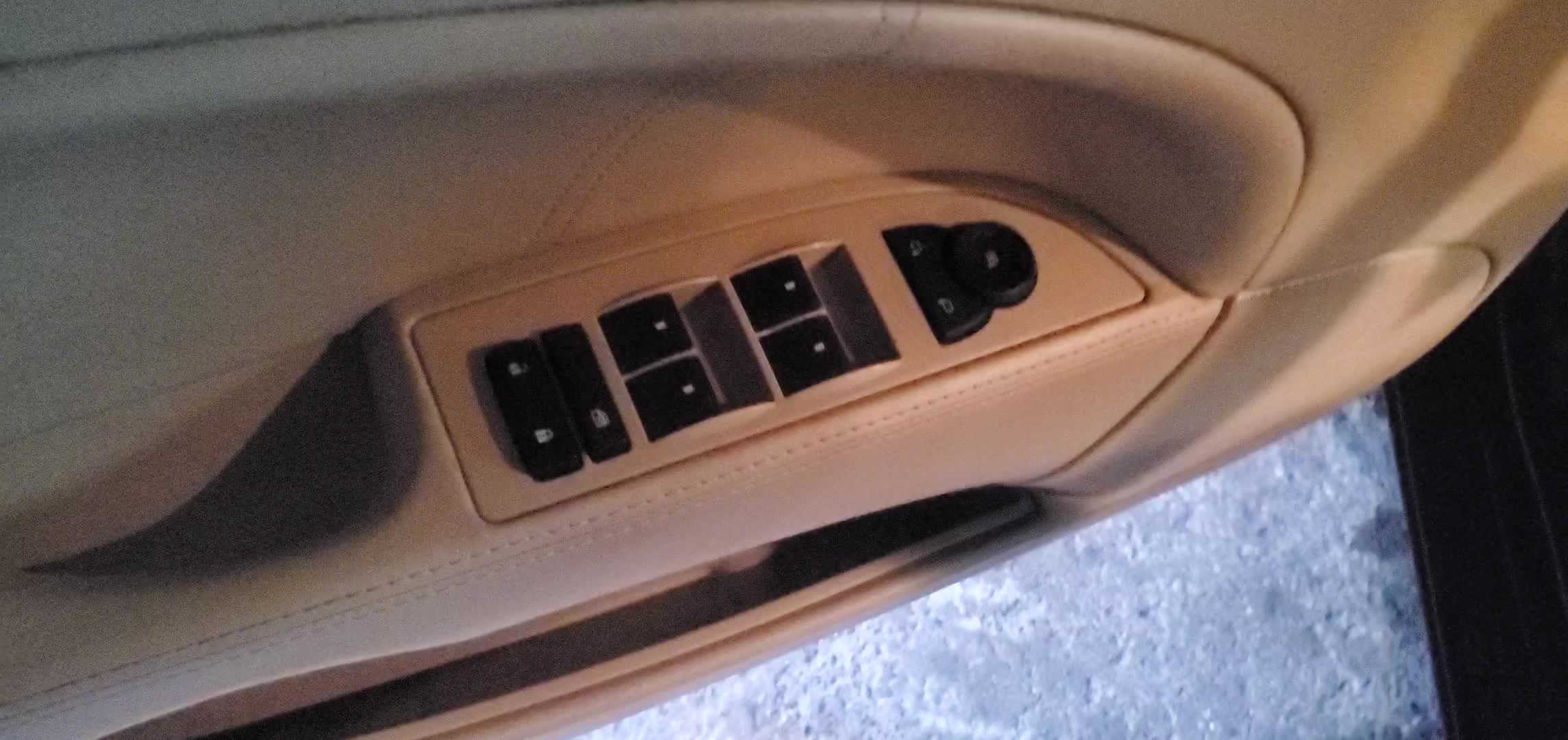

The switches on my driver side door are functional, they just don't illuminate. I've replaced the window harness, but that didn't fix the problem. Any help is appreciated.
Thanks!

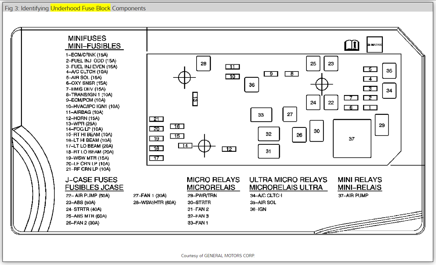

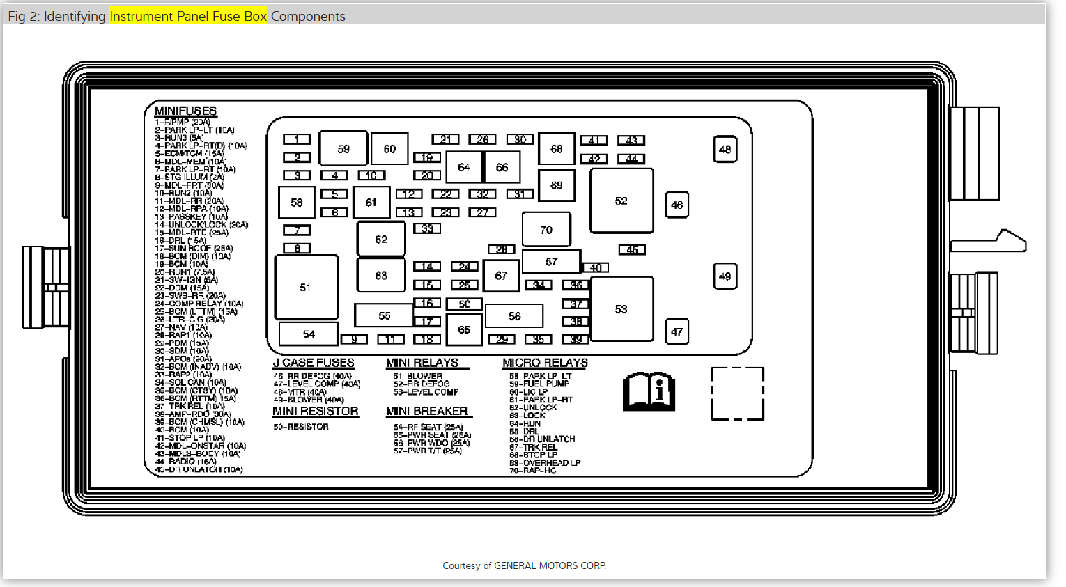

We need to test the STGILLUM #8 fuse in the interior fuse panel. here is a guide to help with the fuse locations below:
Jan 17, 2021 at 10:25 AM
MUNDO9287
  • 7 POSTS
Thank you. I will report back in the morning with video.

Hello. I attached a video to explain better.
Thank you again.
Jan 18, 2021 at 2:00 AM
  • 55,421 POSTS
thanks for the video. it is suppose to light up on both sides please replace the fuse lets see what happens.
Jan 18, 2021 at 10:31 AM
MUNDO9287
  • 7 POSTS
I replaced the fuse, no luck...

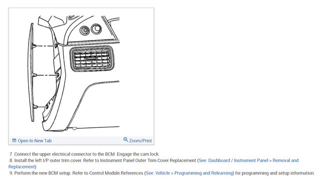

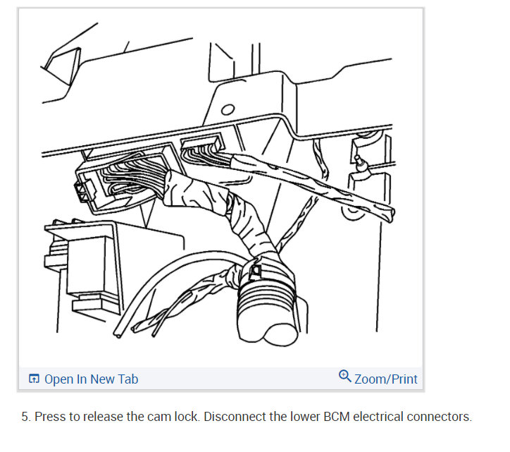

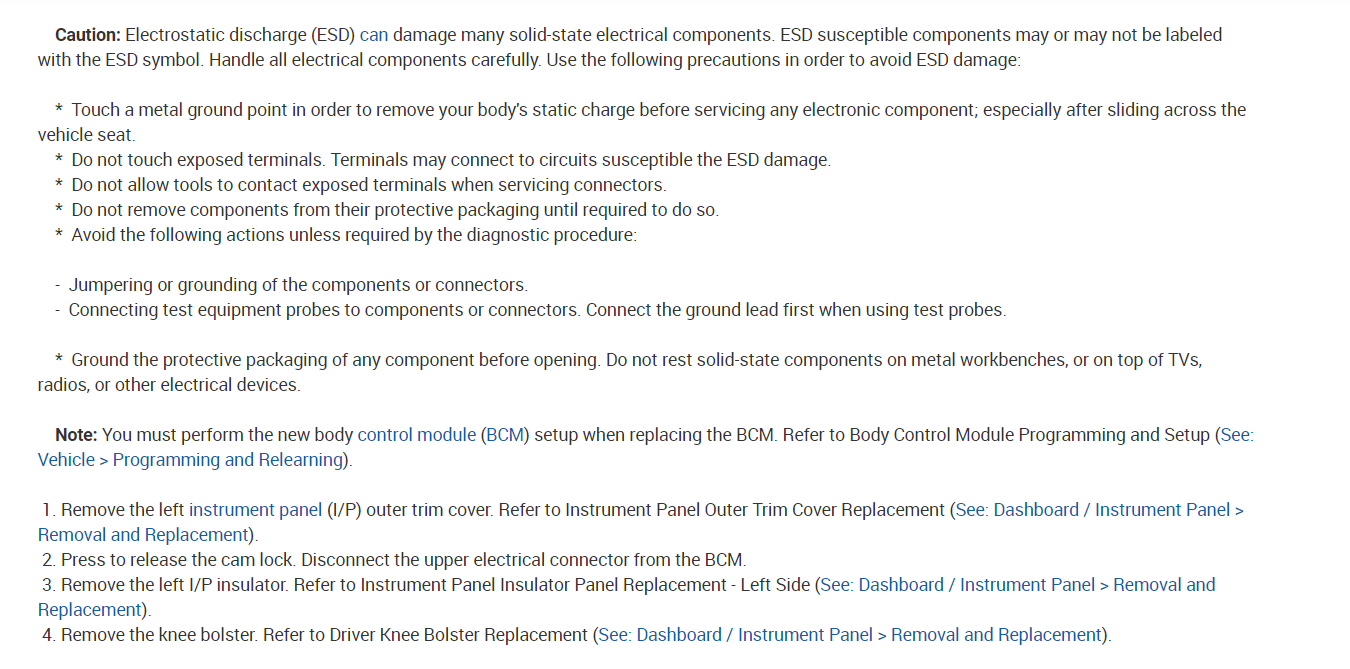

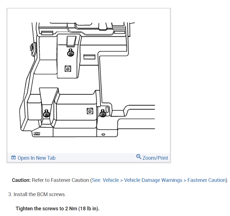

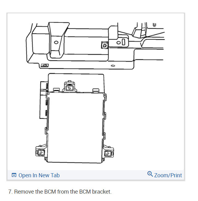

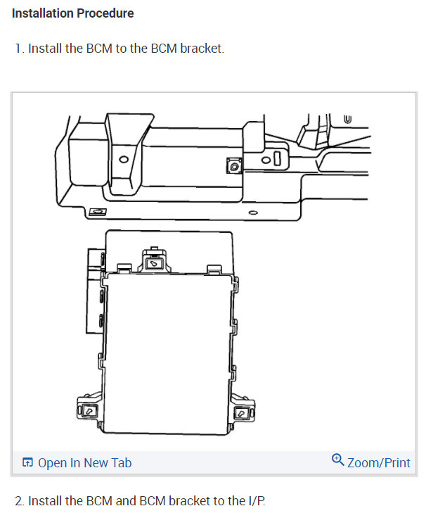

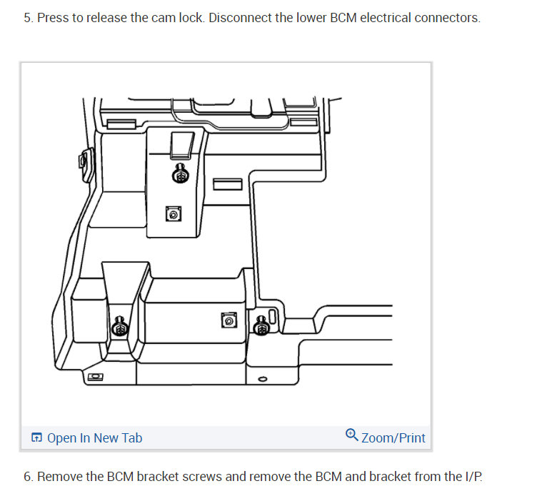

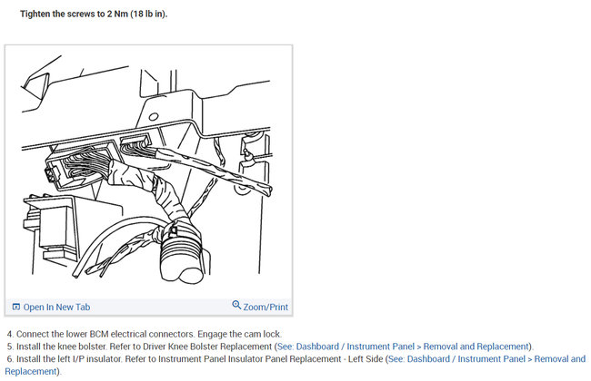

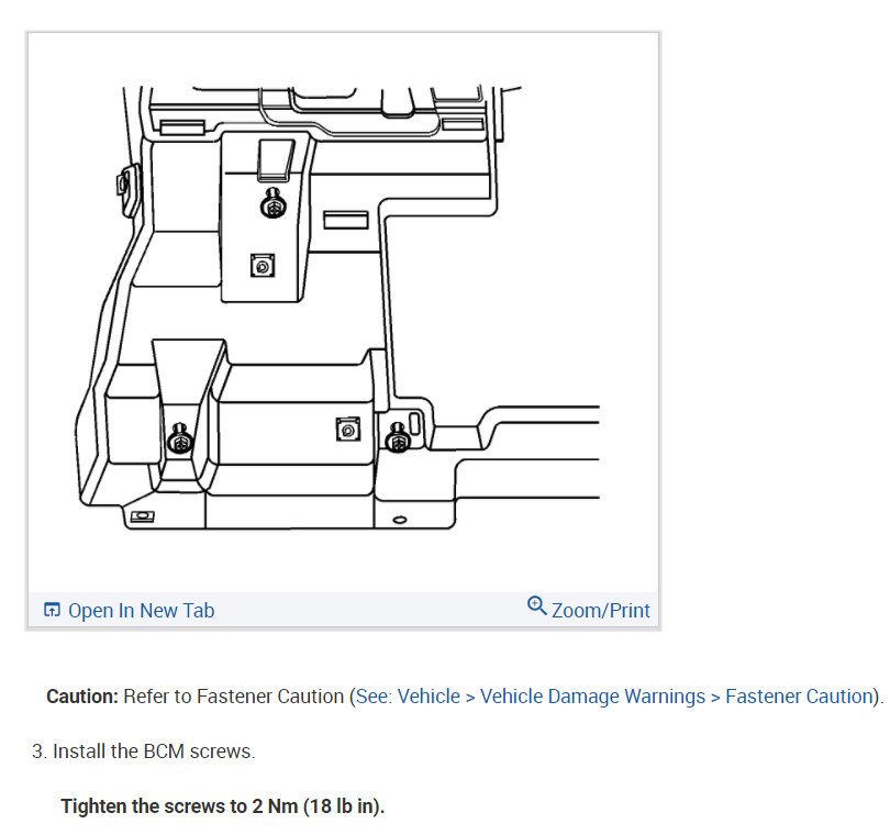

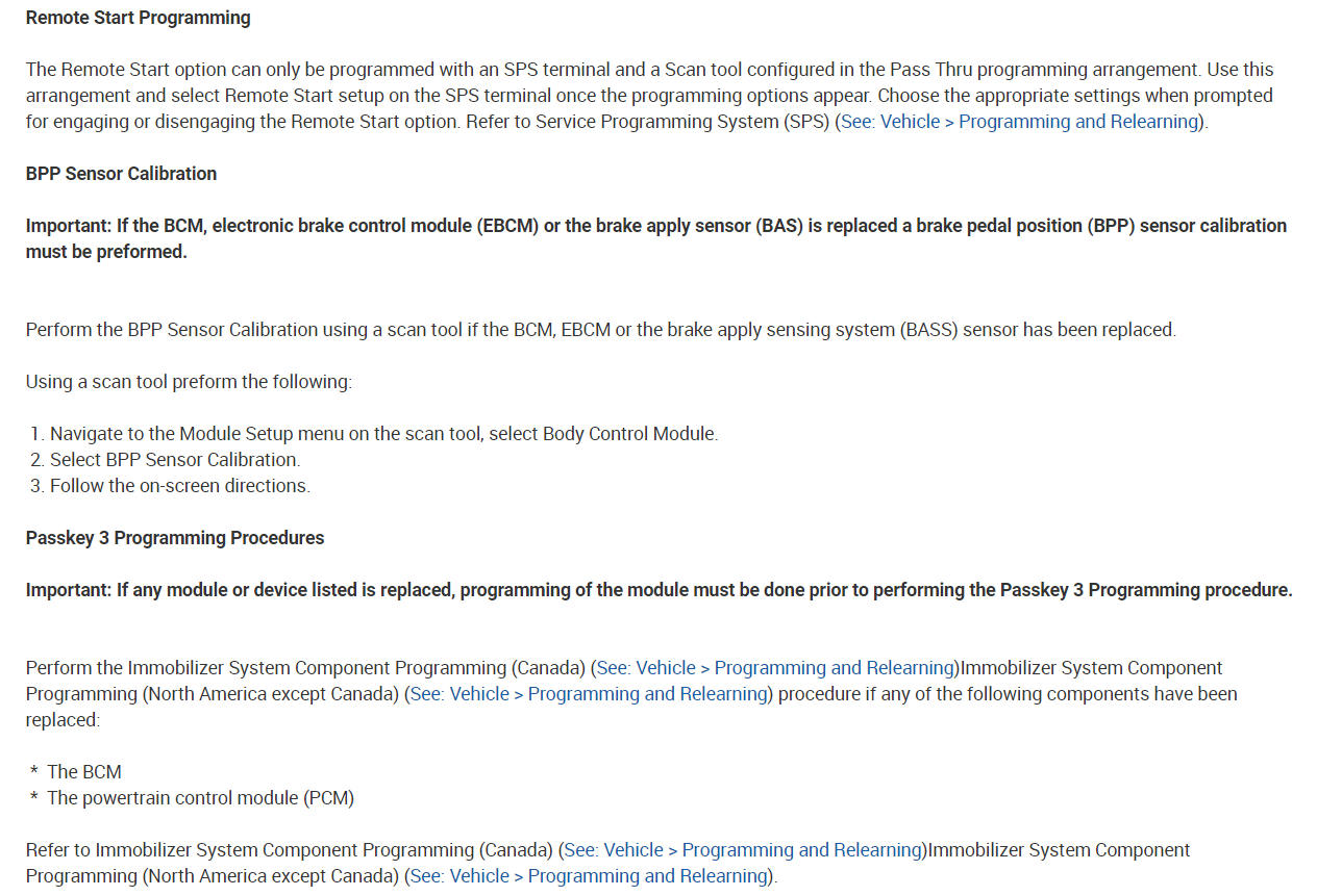

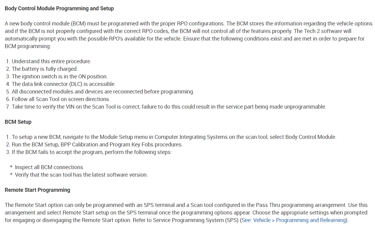

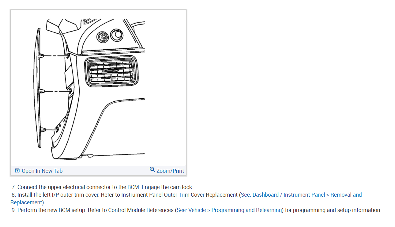

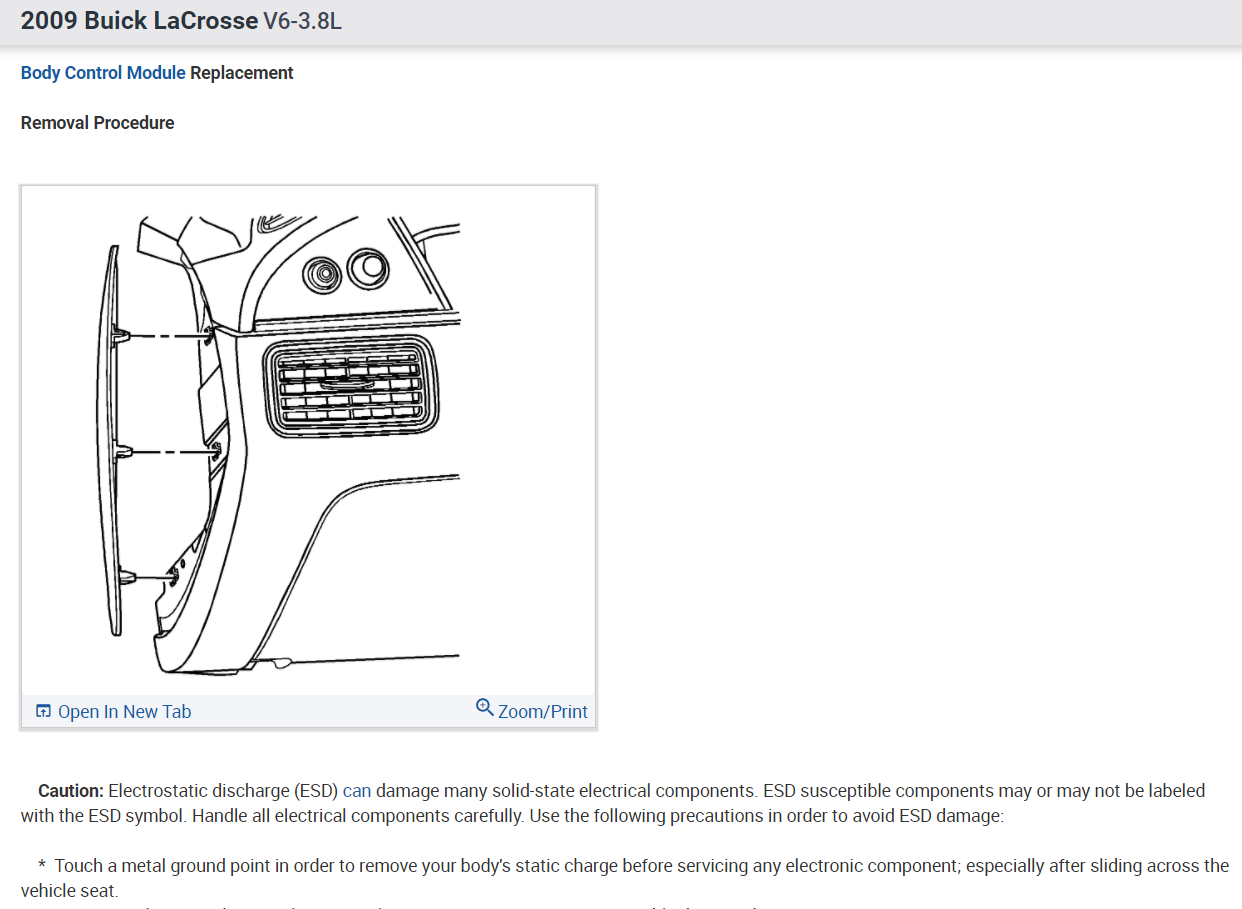

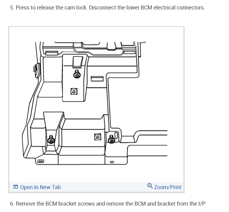

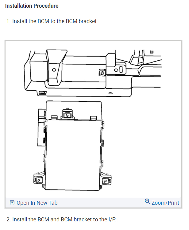

Okay, it looks like the BCM is going out. to be sure lets do a CAN scan which is the future of automotive repair. you can get a CAN scanner from Amazon for about $50.00. here is a video to show you how:
https://youtu.be/InIlnsjOVFA
Here is how you can replace the BCM. Check out the diagrams (below). Please let us know what happens.
Jan 20, 2021 at 9:05 AM
MUNDO9287
  • 7 POSTS
Hello, I replaced my BCM and that's didn't fix the issue. What else could it be?

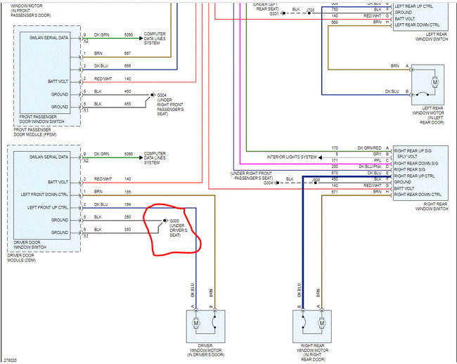

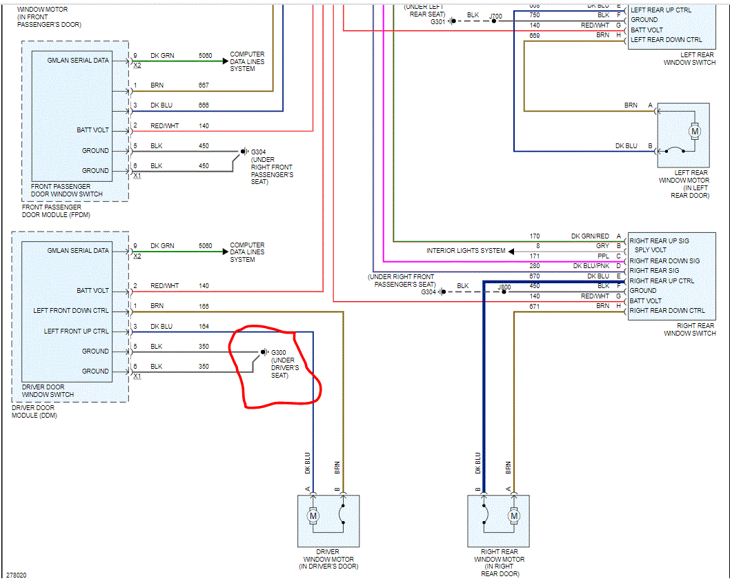

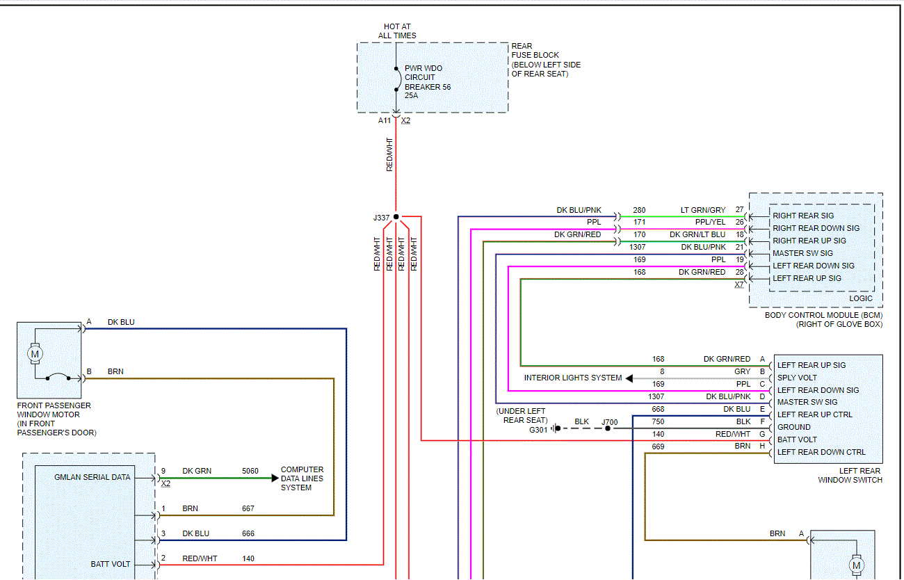

I attached the wiring schematic for the power windows so I could get a good look at the driver's switch. Here is what I want you to try:
First, I need you to check the ground for the door module. If you look at pic 2 below, I circled it and its location. Confirm there is continuity to ground via the two black wires.

I wasn't able to locate the ground wires unfortunately, too many blocking my view. I will try again tomorrow.
