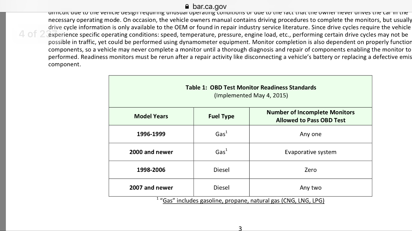

What I have read in California is that any car after 2000 need all monitors set other then the EVAP monitor. All monitors are set but the catalytic converter readiness monitor.
Feb 4, 2017 at 7:21 AM
SATURNTECH9
  • 30,869 POSTS
I live in California and as far as I know you cant have the catalytic converter monitor not set and have it pass.

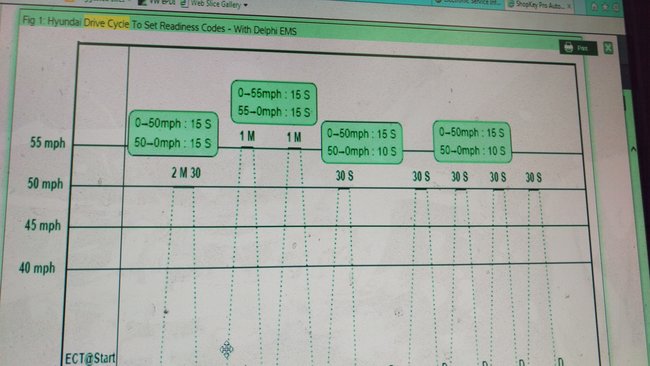

All I am looking for is the drive cycle.
Feb 4, 2017 at 11:51 AM
SATURNTECH9
  • 30,869 POSTS

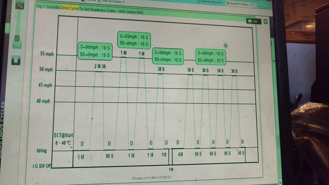

I hope you have empty roads to do this here you go.
Feb 4, 2017 at 1:09 PM
SATURNTECH9
  • 30,869 POSTS
Here is is a complete graph of it.
Feb 4, 2017 at 1:29 PM

Kind of lost how the times for accelerating and decelerating.
Feb 5, 2017 at 11:08 AM
SATURNTECH9
  • 30,869 POSTS
It says fifteen seconds I would think that is what the 15s means. also, below it says times as well.That is from Hyundai it is really confusing actually. I just let my monitors learn natural unless it is some of the European cars I can use my scan tool to do it.

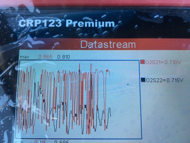

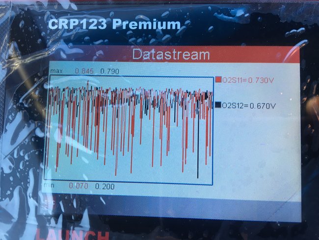

What I do to check and see how good the cat is compare the upstream o2 sensor readings to the downstream readings.See how close they readings are to each other at about 2500 rpms.They should be cleaner than the upstream and the downstream shouldn't be almost mirroring the upstream.

I did that with the pictures I uploaded.
Feb 8, 2017 at 10:44 AM
SATURNTECH9
  • 30,869 POSTS
Is the second picture bank two?because upstream and down stream are almost equal readings

Yes the first picture is bank 1 o2 upstream and downstream and the second picture is bank 2 o2 upstream and downstream.
Feb 8, 2017 at 5:36 PM
SATURNTECH9
  • 30,869 POSTS
The second picture bank 2 cat spent look like its really working at all.Rock auto dot com has hit and miss cats for California.I get cats from then when they have cats available for California for what cars Iam working on.

What about bank two ?Isn't that the one that upstream and down stream o2 sensors were almost equal?So why are you ordering bank 1 that you replaced 50k ago ?
Feb 19, 2017 at 1:22 PM
GREENCHEVYMALIBU
  • 230 POSTS
Bank one is the side where both o2s are almost the same.
Feb 19, 2017 at 4:36 PM
SATURNTECH9
  • 30,869 POSTS
The picture on the right you posted is bank 2 correct?If so I would be more concerned with those readings.
