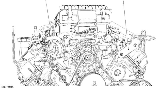

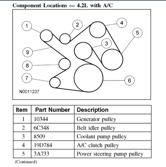

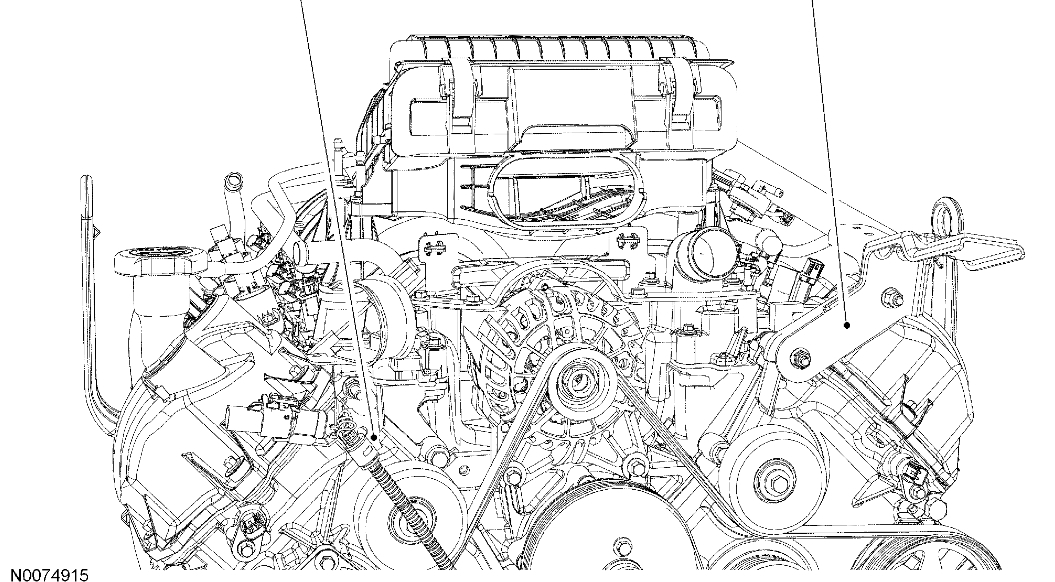

It isn't common. By chance, which pulley came off? Was it one of the components or a tensioner?
I attached a pic below showing the accessories on the V6 engine with AC. Take a look at them and let me know which pulley is the faulty one. Also, if you could take a few pics of what you are dealing with and upload them for me to see, it may be helpful.

Is the diagram you shared with me as it would look facing the engine? I want to make sure I pinpoint the correct pulley before I can tell you which one it is, of course you might be able to tell from the photos also.

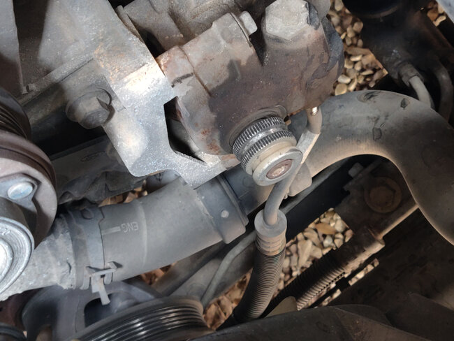

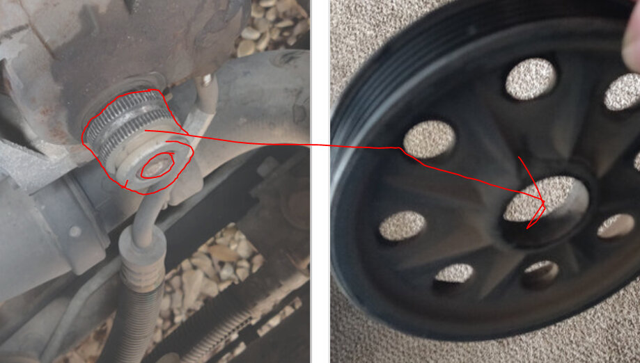

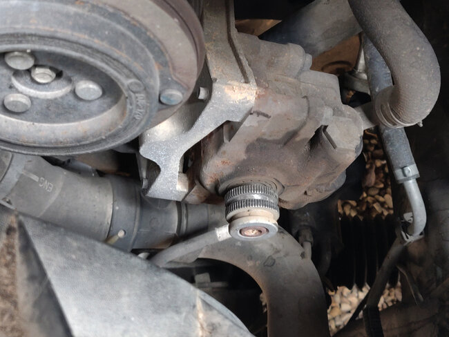

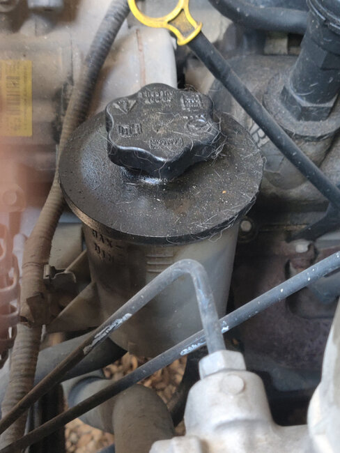

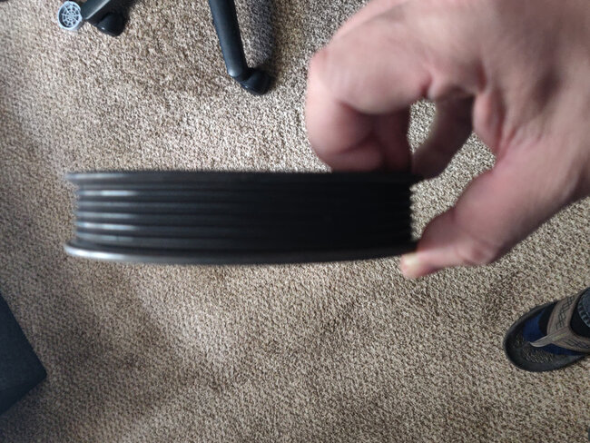

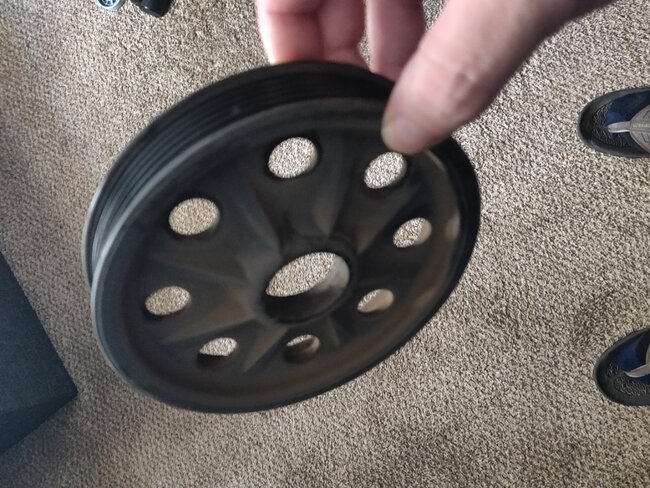

I have attached some pictures for you, just in case it is the power steering pulley I noticed the reservoir is a bit messy up top, but it appears there is still fluid in there. I don't know if that makes any difference in case the power steering pump is possibly faulty here.
Aug 3, 2023 at 6:04 AM
JWEBER78
  • 13 POSTS
Quick update, I just checked the part number for the pulley, and it was indeed the Power Steering Pump Pulley that came off.

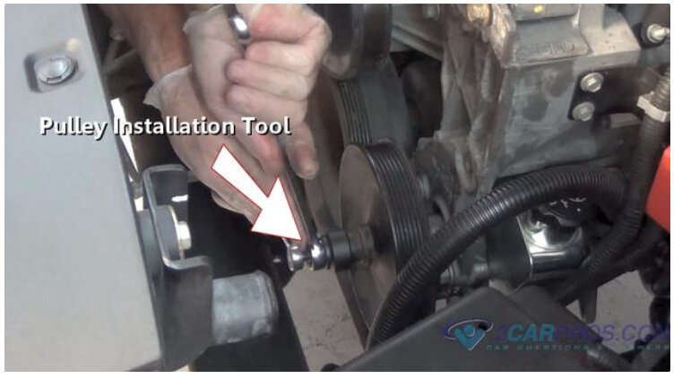

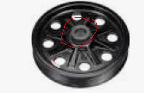

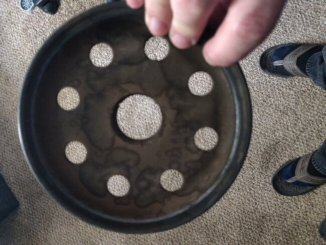

You need a new pulley. I attached a pic below combining two of yours. The part still on the shaft of the pump should be in the pulley. It came apart. Pic 2 shows what it should look like.

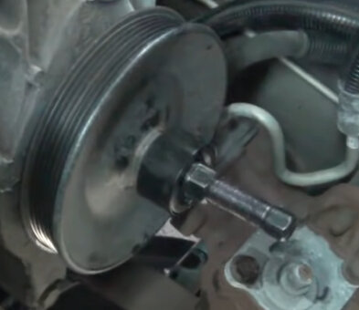

When you get the new part, you will need a special tool to remove what is still on the pump, and you will need another special tool to install the new pulley. See pics 3 and 4. Pic 3 is the removal tool and pic 4 is the installation tool. When you go to the parts store to get the new pulley, ask them to use the tool. Most parts stores will lend one to you.
Also, review this link. It explains step by step how this is done. Additionally, there is a video showing how it is removed about halfway through the link. Note: The link is for replacing the pump. However, most times a new pump doesn't come with the pulley. That's why we show it in the link.

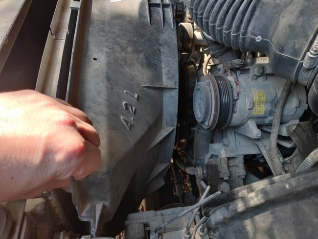

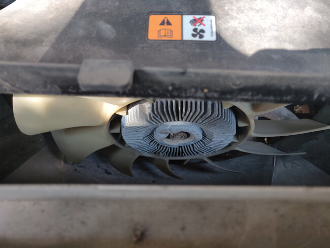

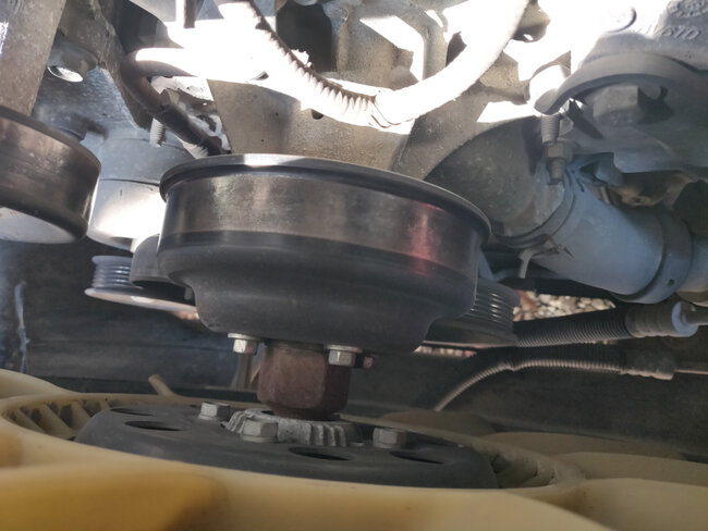

Okay, so, I finally got the tools I needed, and being the procrastinator that I am I'm now just getting on this.

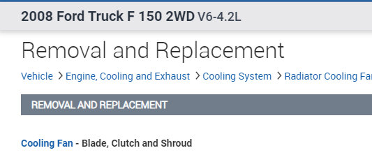

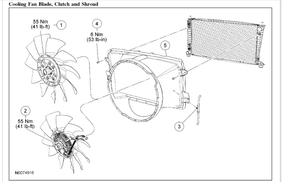

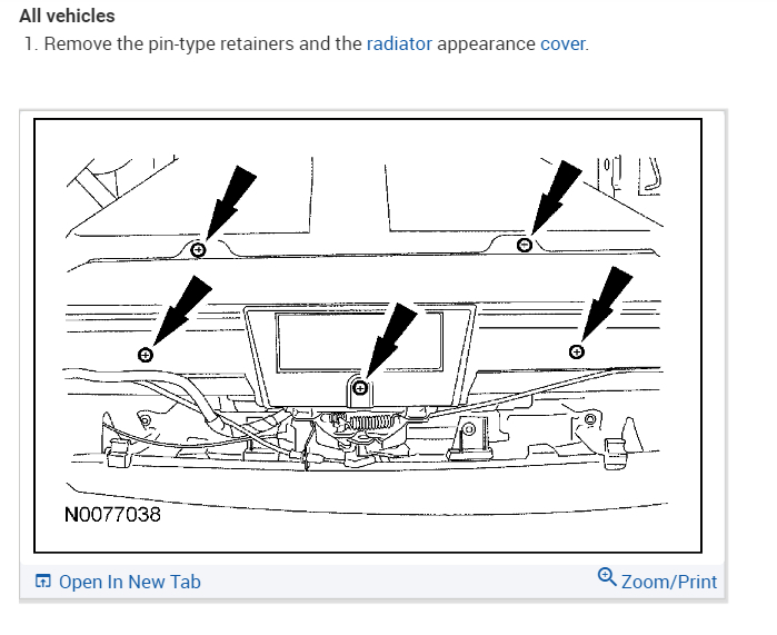

However, the fan shroud is in my way. It will be a lot easier to get this done and to reinstall the belt with the shroud removed. Removing the bolts to it was super easy, but there is not enough clearance for it to come out because of the fan blades.
What is the easiest way for me to get this shroud out? Like could I just remove the bolts you see on the fan and slide the fan off or is it more complicated than that? Would rather not remove radiator hoses and all that if I don't have to just to get this shroud out.
Pictures attached. :)
Aug 30, 2023 at 7:02 AM
  • 110,244 POSTS

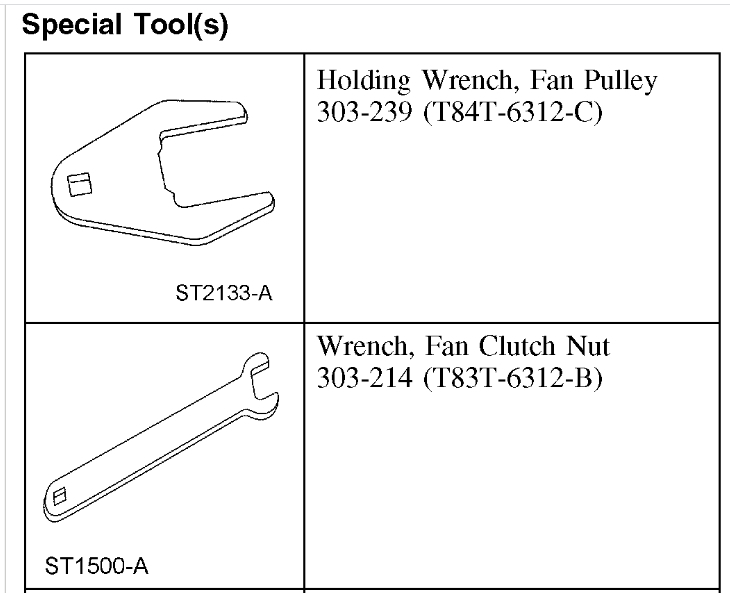

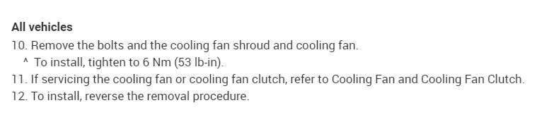

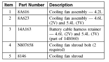

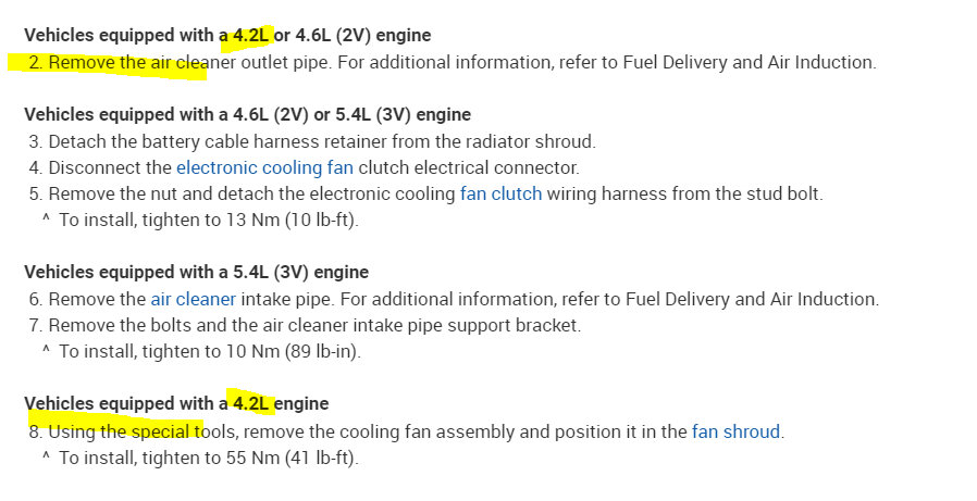

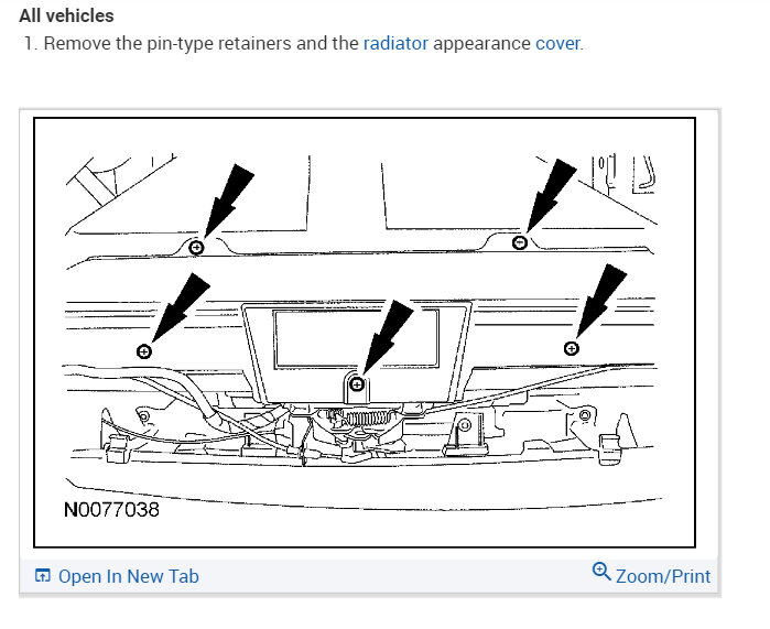

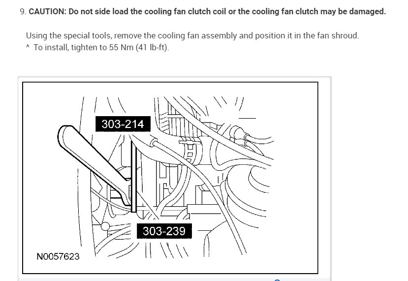

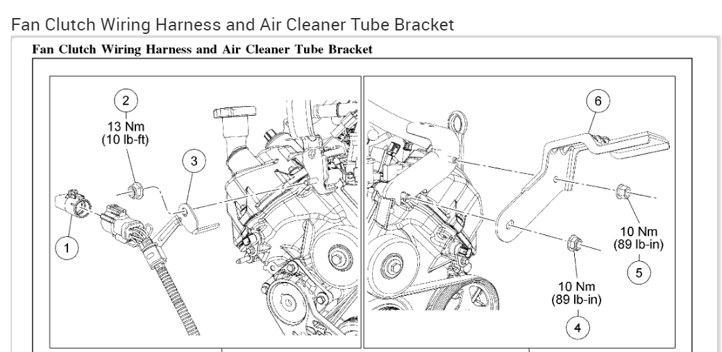

To remove the shroud, the clutch fan needs to be removed. It requires removal tools that most parts stores will lend you. '
I attached the directions below for the removal.
