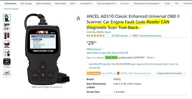

Do the trans repair stores have a special scanner that wouldn't cost alot? Or would it be cheaper to try and buy a scanner with Can Bus reader? I thought I heard someone say that there were some on Amazon for $35. I haven't looked but it sounds good to be true. When I bought my scanner I'm pretty sure a Can Bus scanner was about $500.

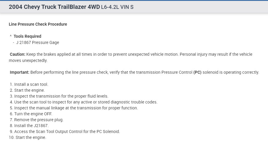

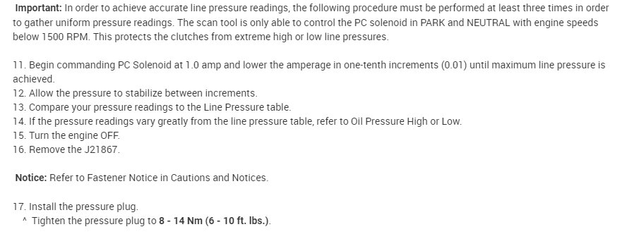

As far as the issue is concerned, it could be a pressure-related issue. If we don't have a scan tool that can read all codes, you can check the pressure. I attached the directions below.
Also, if we have an ABS light, it could be any of the wheel speed sensors. As far as a scan tool, you can get them for not too much money. I attached a pic below to show you. That is from Amazon. What it is capable of I can't say, but it indicates CAN capabilities. And yes, our scanner cost $5,000.00, but it does everything except wash the windows. LOL

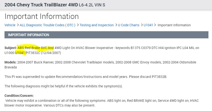

The codes are related to power variations and signals. See the definition for each below.
C0035 and C0040 are related to an erratic signal from one of the wheel speed sensors to the electronic brake control module. (EBCM)
C0201 indicates the power to the ABS valve solenoids is less than 80% of the battery's voltage.
C0550 The EBCM detects an internal malfunction.

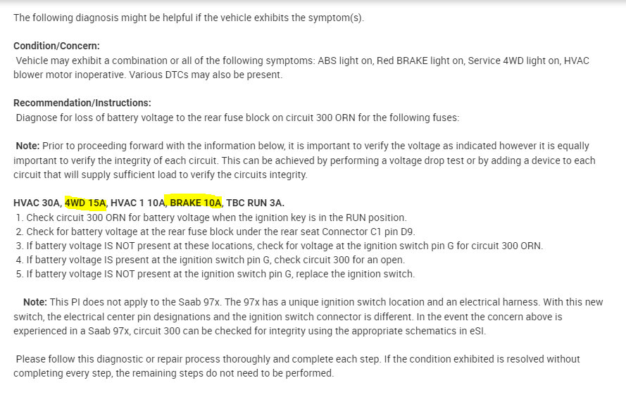

Now, the one that stands out that would be my first check is related to the U1041. If there is a power loss or low voltage to the fuses in the rear fuse box, I suspect it can be causing all the codes above.
Take a look at the pics below and let me know if you are comfortable performing the tests or if you have questions.
