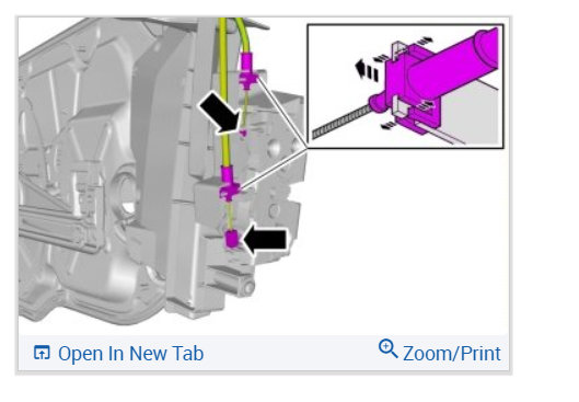

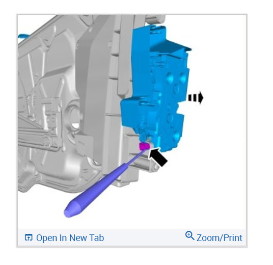

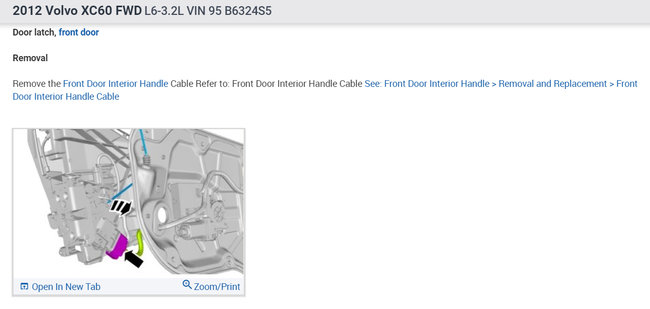

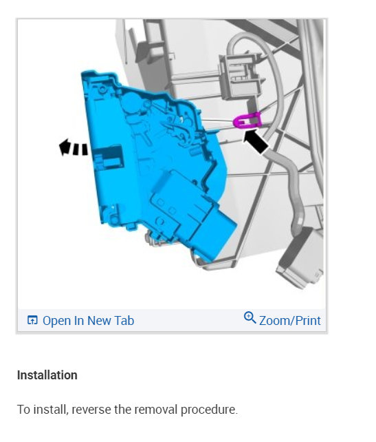

Please run down this guide and report back. If all seem okay the latch is bad here is how you replace it in the diagrams below.
