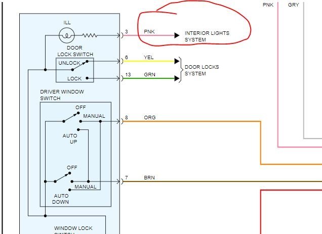

When you turn on the headlights all the interior lights on 3 of the doors turn on (door switch lights illuminate) except for the driver side front door. now, i just replaced the door as the other rusted out. i have tried the basics. looking at fuses and removing them and undoing the battery and leaving it, cleaning corrosion at battery terminals and tried the ECM/ECU fuses too. nothing. i actually replaced the door switch with a new as i thought it was the component.. not the case and have since put the old back in. suggestions? looking at wrong fuses? should i be looking at relays? which one and where is it located? sorry for the long post, look forward to hearing back.

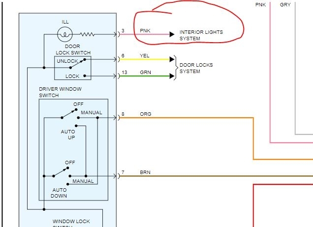

Since the other light switch lights are working, I suspect the wire which supplies power to the light in the driver's switch is damaged or there is a corrode or damaged pin in the connector.
There is a pink wire in the harness to the switch. It is what provides power to the light. You will need to check if there is power at that wire. If there is, then you need to check the connection.

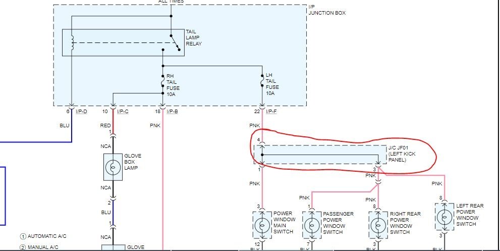

If there is no power, you will need to trace the pink wire back to the left kick panel junction to see where power is lost. Interestingly, all the other switches are spliced together. The driver's is separate even though power comes from the same source.
Take a look at the attached schematics. I have attached a few links you may find helpful when testing.
Let me know if this helps.
