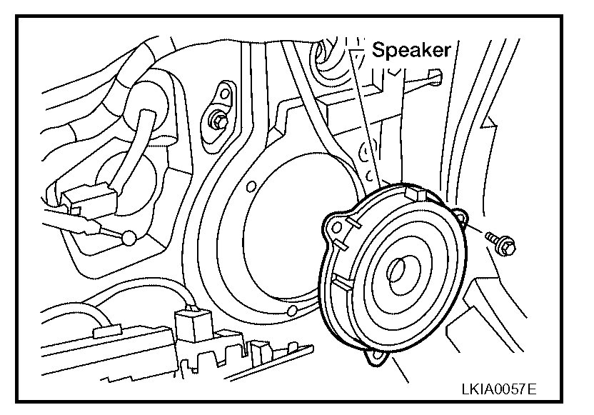

door speakers are not working.

Let's start at the beginning. First, remove the speaker and make sure they are still connected. There will be two wires going to each speaker.
Here are the directions for removal. The attached picture correlates with the directions.
_____________________________
Removal and Installation for Door Speaker
1. Remove door finisher. Refer to "Removal and Installation"
Pic 1
2. Remove screws and speaker.
3. Disconnect speaker connector.
Installation is in the reverse order of removal.
