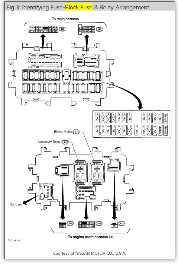

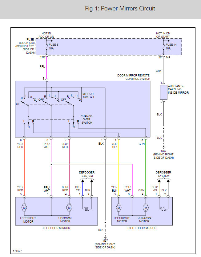

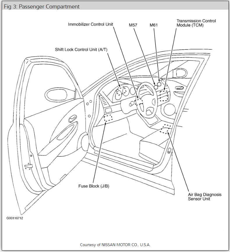

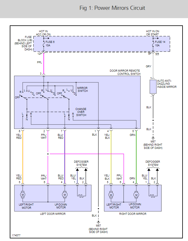

My Rear View Mirror electronic Temperature displayed turned off on my '03 Nissan Altima. I was wondering if you had any ideas or pointers on what I could do. I was thinking maybe a fuse but couldn't find anything on it.
Feb 19, 2009 at 1:37 AM
ZACKMAN
  • 4,202 POSTS
It looks like fuse #14 - 15 amp is the one you want to check here is a guide and wiring diagrams so you can check it.
