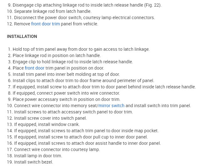

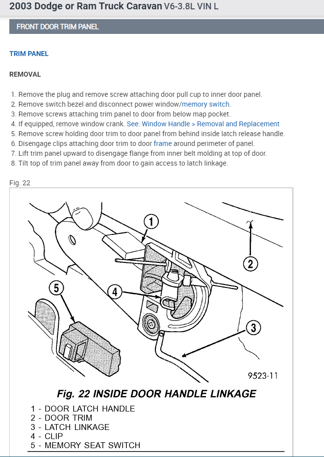

I need to replace the driver door power window regulator assembly. Took the door panel off a realized I need to replace the sound proofing and water barrier; they have both degraded to pieces. Any chance of finding part numbers and replacement parts or will it be best effort by me?

Our repair manual only provides part number for major mechanical parts, unfortunately it does not provide the parts you are looking for.
The best course of action would be for you to call your local Dodge dealer and provide them with the VIN, they will be able to look up any of these specific parts and can provide you with part numbers.
https://www.2carpros.com/articles/door-panel-removal
