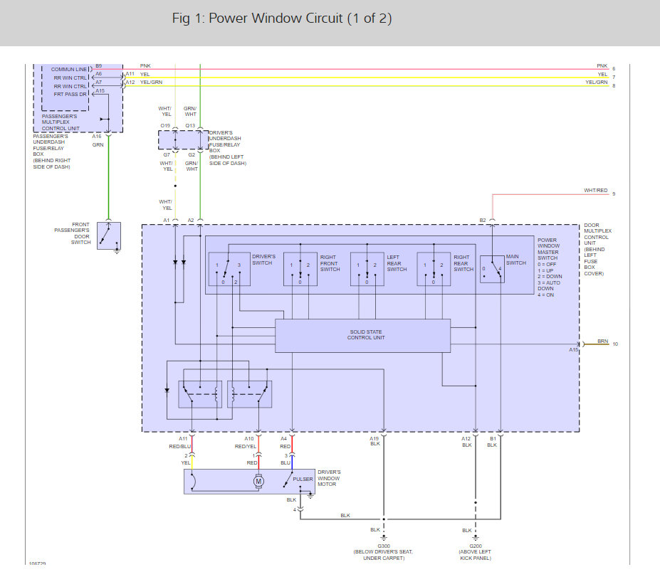

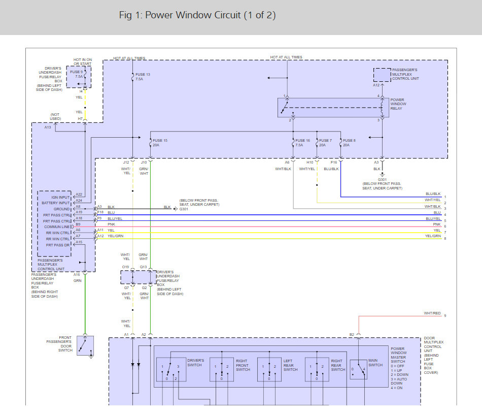

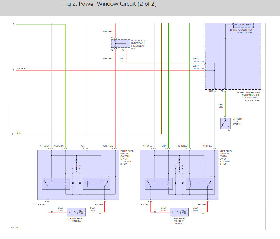

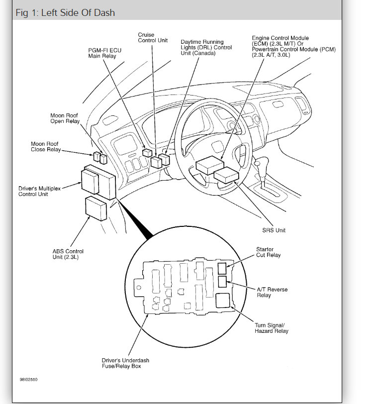

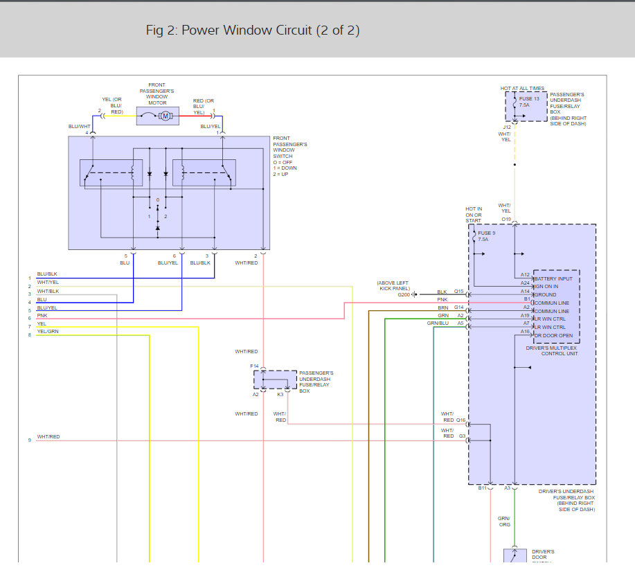

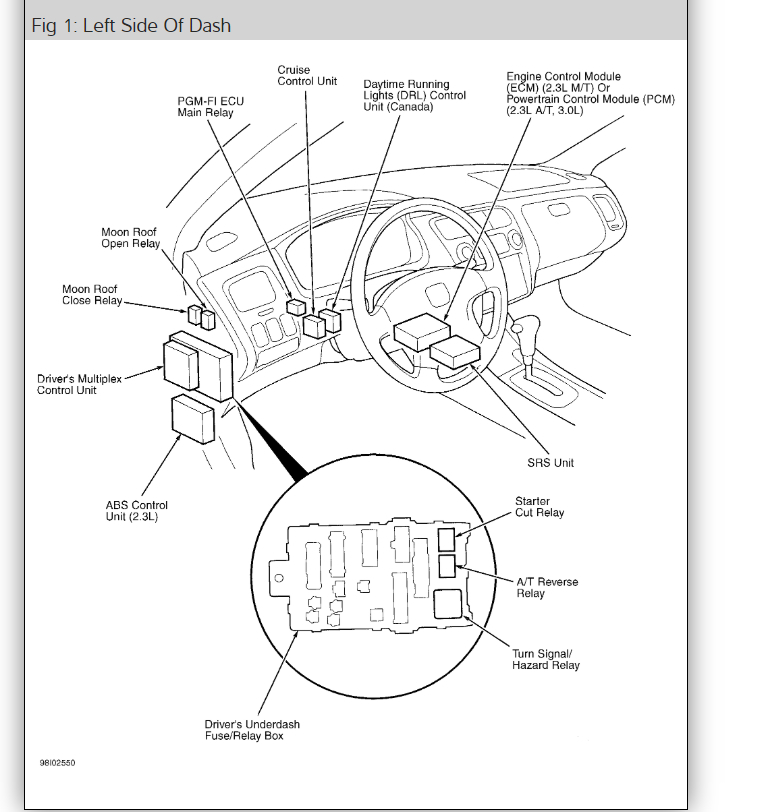

Hey i have the car listed above sedan EX model. I am having a problem with my windows and locks; when i go to lock it from the door inside none of the locks work at all and when i put the the windows down on the passenger side they go down really slow. but when i use the buttons on the passenger side the windows go up and down with no problem. i checked the fuses but still does the same thing.
Jun 20, 2019 at 8:25 PM
  • 55,710 POSTS

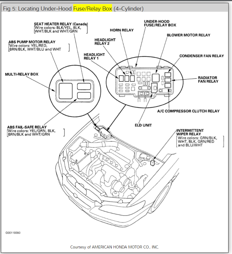

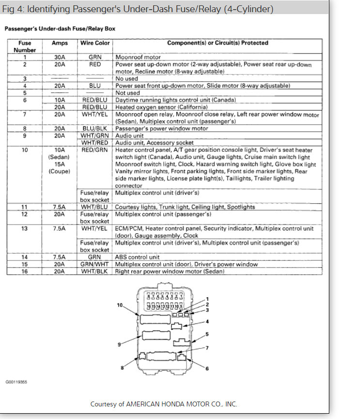

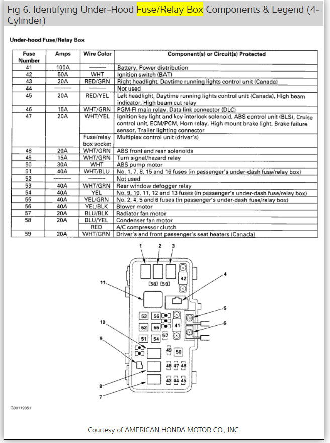

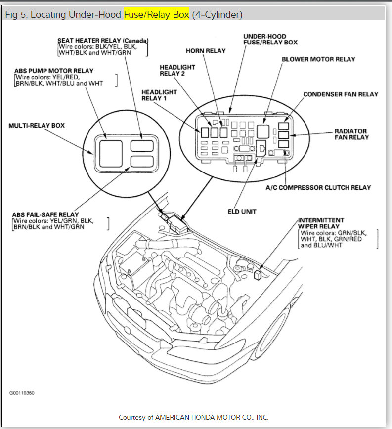

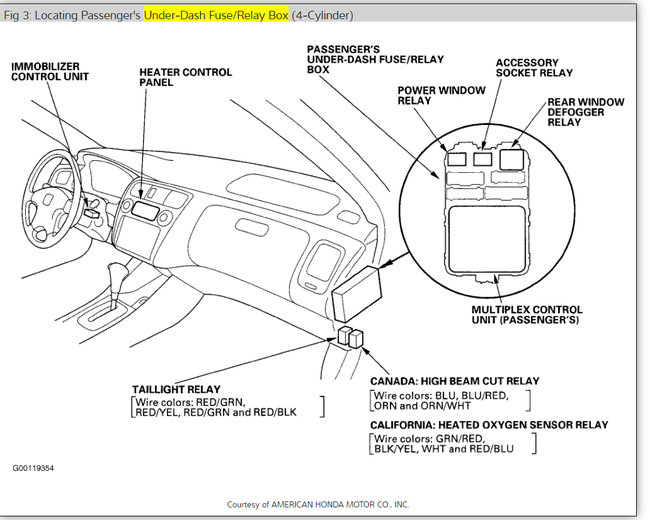

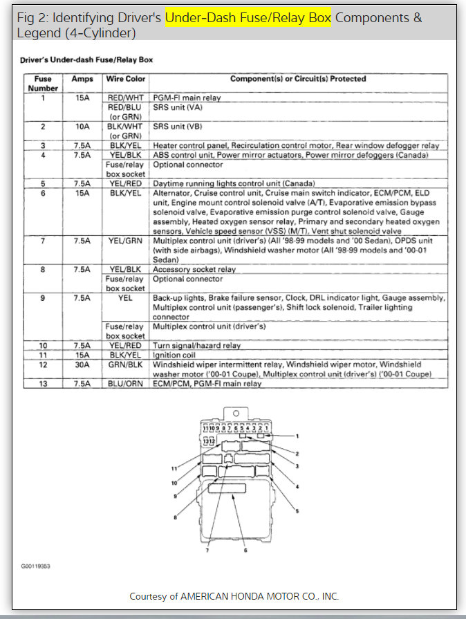

This sounds like the drivers multiplex is out. To confirm here are the wiring diagrams and a guide to help you test the outputs and the module location. Also check the window relay as well
and
