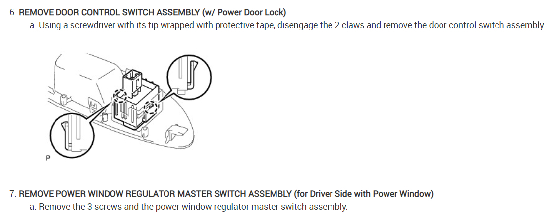

If smart key you mean that is has a remote to unlock the doors then yes, unfortunately I don’t have a CAN scanner just a regular OB2 scanner but I did try to pull and push on all doors but the door locks did not act up but now my door switch on both sides doesn’t want to unlock sometimes but will always allow me to lock.

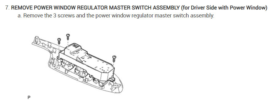

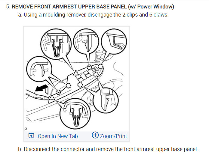

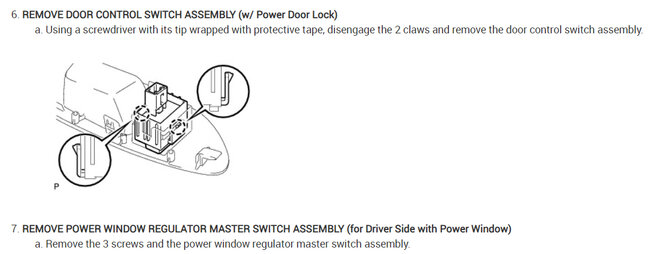

Thank you, the smart key door lock system is involved. It has a body ECU and a certification module; this is why I wanted to do a CAN scan but since the switch seems to be having an issue you might want to swap it out to see what happens. I would get the switch from Amazon so you can return it if it does not make a difference.
Here is one for $35.00:
https://amzn.to/4fRoDKq
Here is how to change the master window switch out. Check out the images (below). Let us know how it goes.
Aug 21, 2024 at 1:57 AM

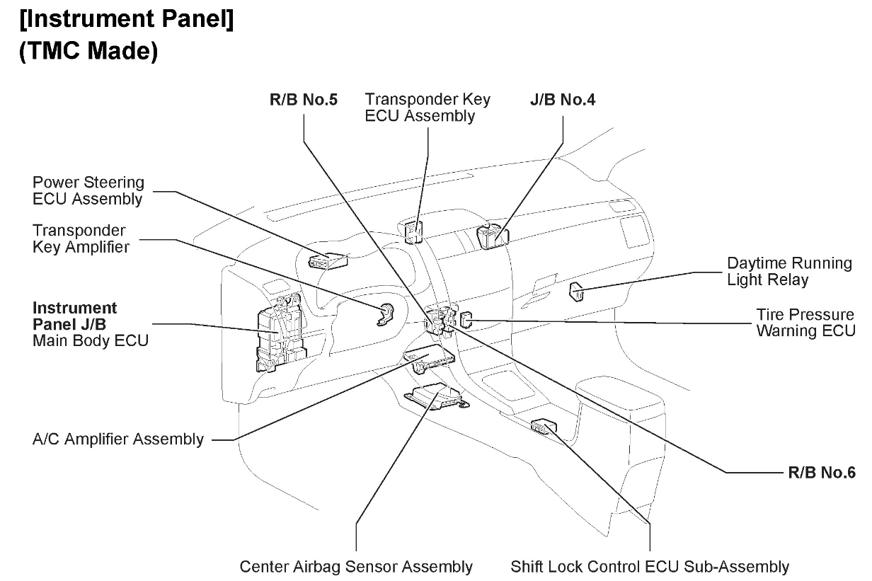

Okay, thanks, I’ll give that a try. but just wanted to ask wouldn’t it make a difference it a disconnect and in theory it should stop the problem, wouldn’t it? Because I’ve disconnected the driver side switch, and it still does the same thing so I’m kind of believing that’s not the problem.

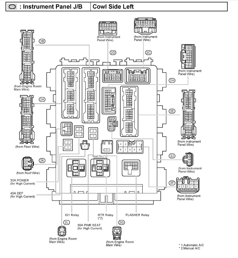

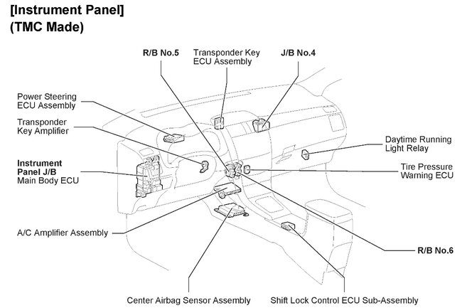

Okay, that is telling us the body ECU could be bad, that is why I wanted to do the CAN scan. Here is the location and how to replace it in case a code comes up for it. The only other thing I can think of is one of the latches is bad, you might want to disconnect the latches one at a time as well, I would start with the driver's door.
