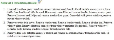

How to do this?
Driver side rear door.
I can see a bolt that's easy to remove. I do not have visibility to see how the actuator is connected to the outside door handle. I am afraid of dificulties placing the replacement.

my question is in reference to the door lock actuator.
I got the wrong answer. The answer refers to the window regulator.

So sorry about that..I misread your question. Here is the correct answer..

I am sorry to tell you that your answer doesn't help me.
"3.Remove door actuator linkage, 3 screws and remove door lock actuator through service hole."
I removed the panel and my problem is I don't have visibility except for one bolt holding the actuator.
It looks to me that I don't need to remove the regulator and window glass to replace the actuator.

Well you DO need to remove the door glass and regulator so if you would follow the steps you would be able to replace your vehicle's door lock actuator properly..
