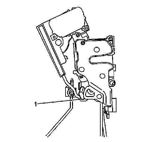

All the others (3) doors lock. When I hit my remote, I get this buzzing sound from the door on the driver's side. I removed the door panel to see what the problem was, nothing. I looked down the window channel to see what it could be and even change the power window button, but nothing. Also, where the door latch is, I believe I see some kind of wire (2) ,but it looks like a headache to replace, could this be where the problem is? I am lost on this issue, please help me out. Thanks and any type of image or instructions to get this done..
Oct 29, 2020 at 11:08 PM
  • 110,236 POSTS

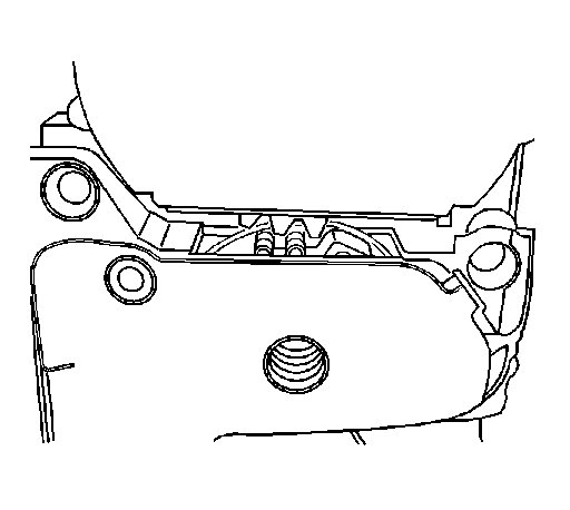

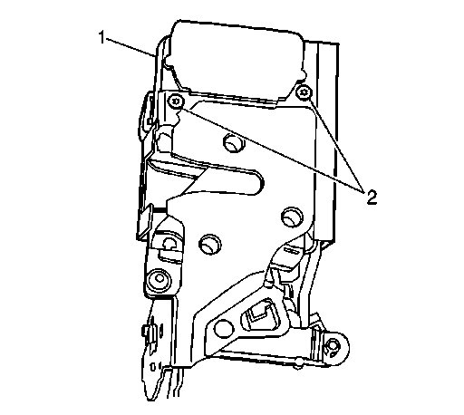

As far as the lock, are you able to lock it manually or is it jammed? If you can do it manually, then it's likely the actuator is bad. The only way to confirm (in this case since you hear a buzzing) is to remove it and see if it actuates. Since you hear it, we know it's getting power.

1. Remove the door trim panel.
2. Remove the water deflector.
3. Remove the door latch assembly.
pic 1
4. Remove the 2 screws (2) that retain the lock actuator (1) to the latch.
pic 2
5. Simultaneously lift up on and rotate the actuator away from the latch in order to disengage the rubber bumper (1) from the latch.
6. Remove the actuator from the latch.

3. Install the actuator to the top of the latch.
pic 5
Notice: Refer to Fastener Notice in Service Precautions.
4. Install the 2 screws (2) that retain the actuator (1) to the latch.
Tighten the screws to 0.75 N.m (6 lb in).
