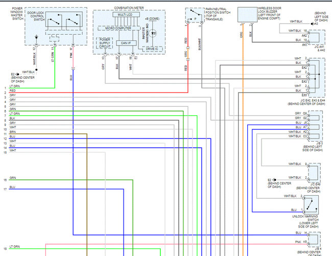

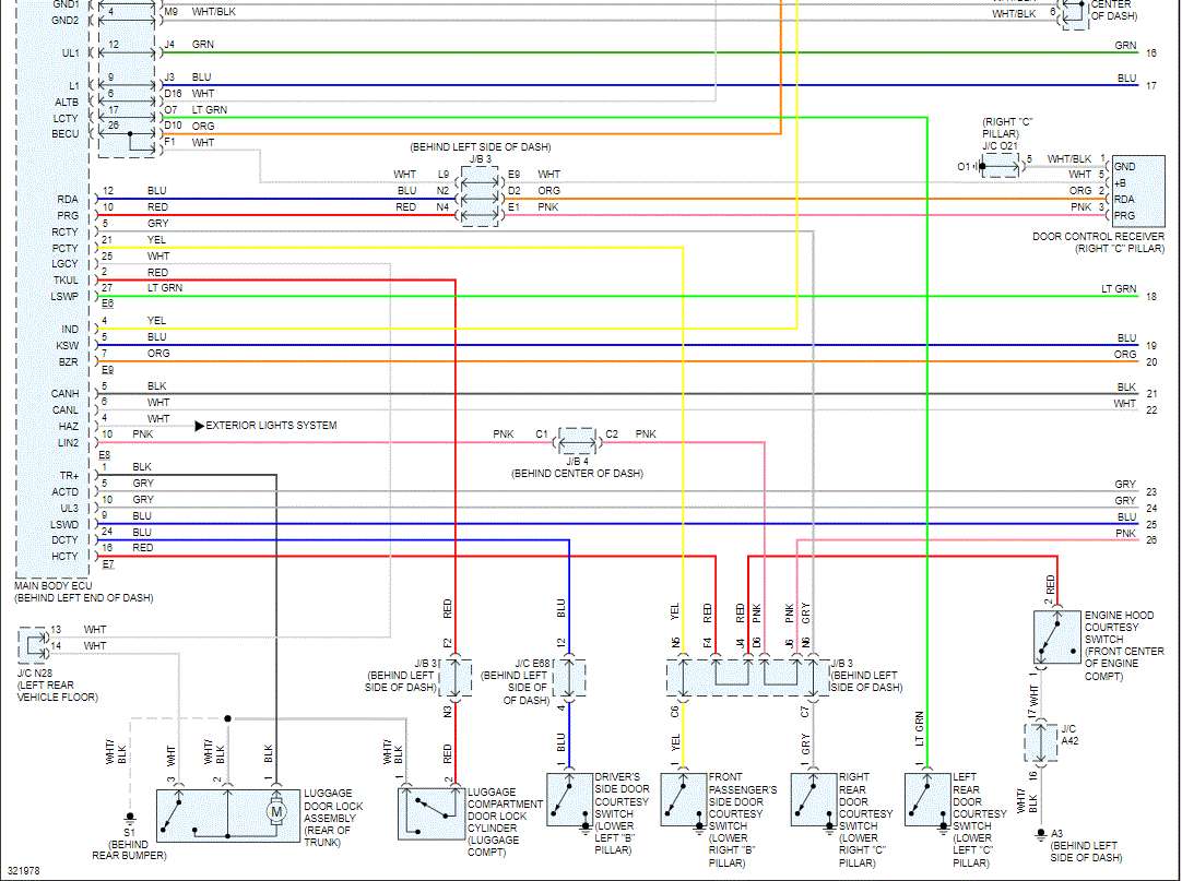

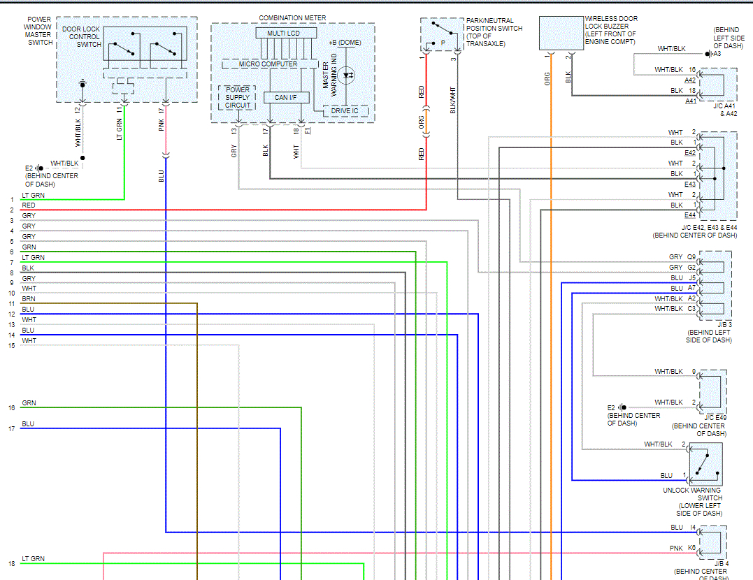

Hello, this vehicle's central lock is not responding, when the button is pressed one will hear a clicking sound as if it has locked, but if attempt is made to open the door it will opened. Please could I get any circuit diagram for this?
Mar 5, 2021 at 11:48 AM
  • 110,240 POSTS

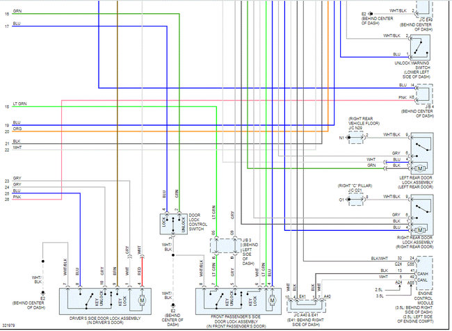

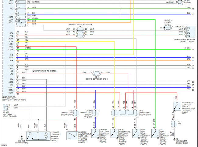

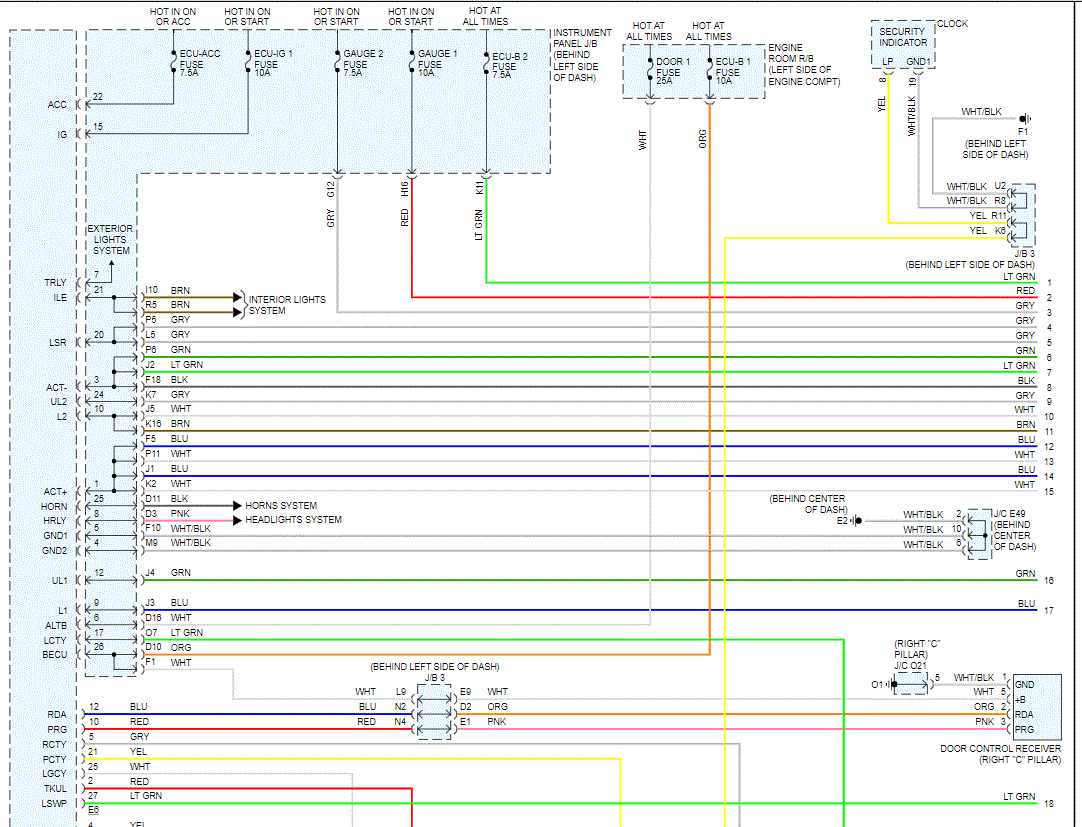

Are all of the locks making a noise but not working? Since you hear a noise, it doesn't sound like a power issue. It could be a ground problem as well. If only one door is doing it, then the actuator itself could be bad.
Regardless, I attached the entire wiring schematic for the door locks. This is for a vehicle without a smart key. If you have one, let me know. Also, if it is a hybrid, let me know.
I cut the pics in half to make them readable. I did overlap them so you can follow from one to the next.
