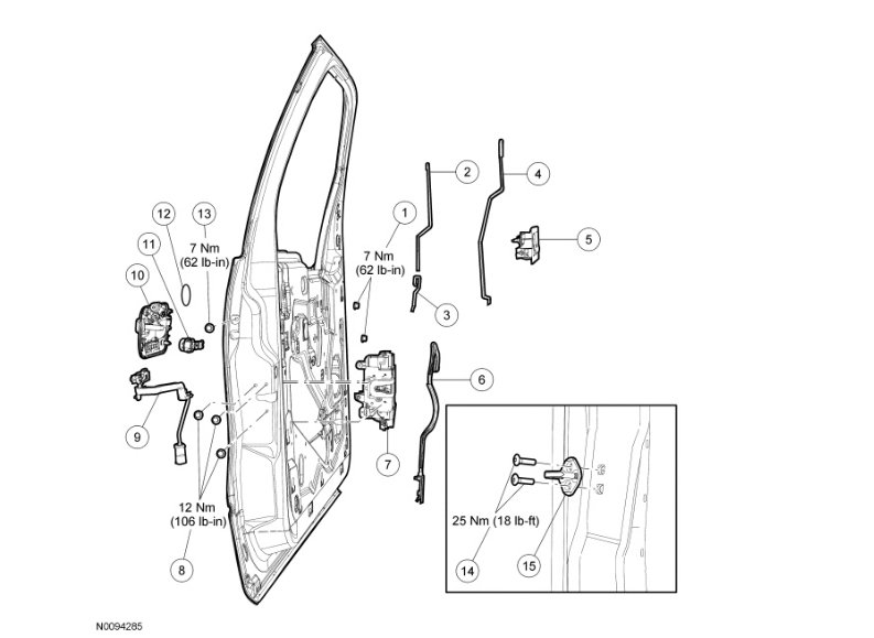

No access do replace actuator because door is lock close.

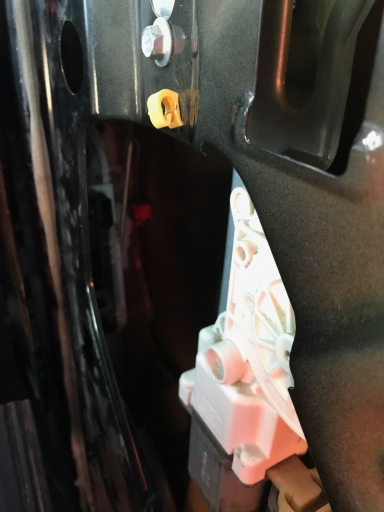

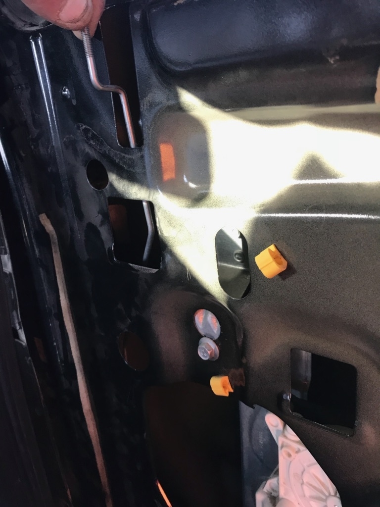

Already have the door panel out and seam like the the door does not want to unlock the rod moves but door stay locked.

Which rod moves?
Can you post a picture of what you see?
Oct 20, 2018 at 2:32 AM
PATRICK GALLANT
The one to lock the door moves in the actuator and I can see the thing move inside but will not unlock the latch.
Oct 20, 2018 at 6:36 AM
From your description, it sounds like the door latch is what is not working. If the rod moves and you see it move the actuator, the only thing left is the latch.

You may need to go to the latch and manually release it. You may need a screwdriver to move it to open.
