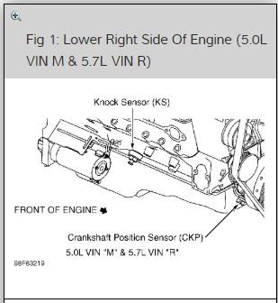

You know, the knock sensor has me thinking. It helps the PCM fine tune ignition timing. Take a look through this link:
https://www.2carpros.com/articles/how-a-knock-sensor-works
I attached a picture of the knock sensor location.
Next, the noise you were hearing makes me think it could be a vacuum leak. You have a lean code which is most commonly caused by a leak. Here is a link that shows how to check for a vacuum leak. Check that, too.
