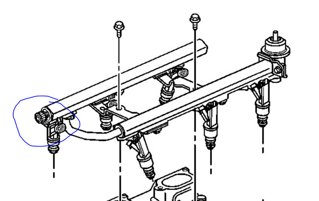

When I try to start the car sometimes it won't start. It will lose power when driving also. It will take several hours for it to finally start. I've had it diagnosed at Car Care and they were unable to diagnose anything wrong. Please tell what can be wrong? I need my car for work, I'm a door dash driver.

I would check the fuel pressure to be sure the fuel pump is working.
https://www.2carpros.com/articles/how-to-replace-an-electric-fuel-pump
FUEL PRESSURE
Fuel Pressure (Key ON, Engine OFF) .................... 386-427 kPa (56-62 psi)
Should not decrease more than .................... 34 kPa (5 psi) in 1 minute
I attached the location of the tap for checking the pressure below.
