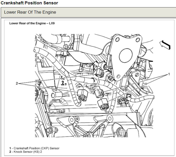

While driving down the road the car will suddenly die without any warning. Then it will. Start right back up as if nothing happened. But it does it more and more frequently now. I don't know if. This has anything to do with the problem but the radio hasn't worked and about a week ago it started working again right before the car started dying.
+1
Tuesday, June 11th, 2019 AT 1:19 PM (Merged)
  • 110,176 POSTS
This sounds like a classic crankshaft angle sensor which will cause the problem you have described.
Here is a a guide to help you see what you are in for when doing the job.
When this sensor goes out it will not trigger a check engine light.
This guide can help as well
https://www.2carpros.com/articles/engine-stalls
Here is the location for your car
Cheers
+4
BILLYSTHEMAN
Thanks for the heads up, I got a sensor from Amazon for $56.00 and have not had a problem since. Thanks I love this site.
