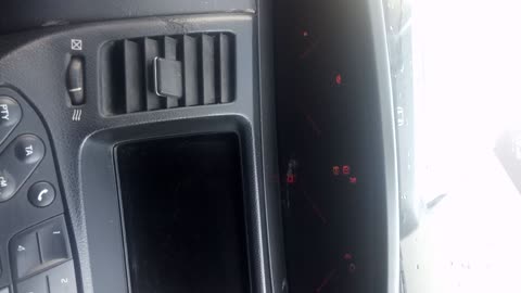

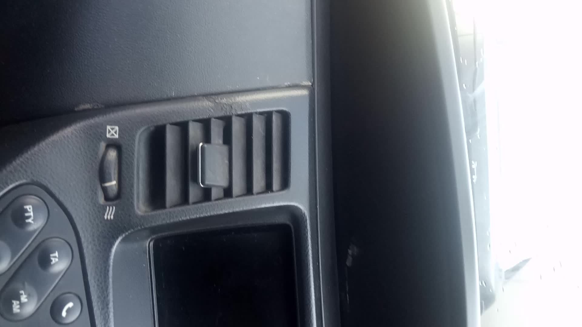

Hi all...
My vehicle listed above (wagon) starts fine and idles smooth.
But whenever I try to rev it up,the needle gets to 2,500 RPM's and starts fluctuating.. what could be the cause? I was told it could be the ETPS or the throttle pedal itself. please I need answers because I'm going nuts.

It does that both at idle and while driving...
