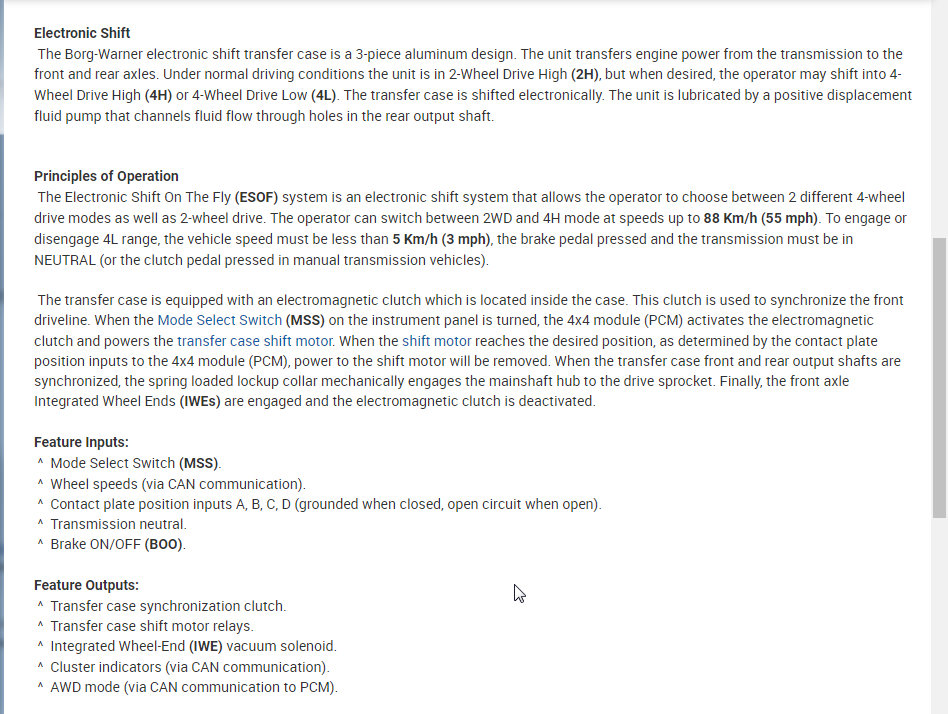

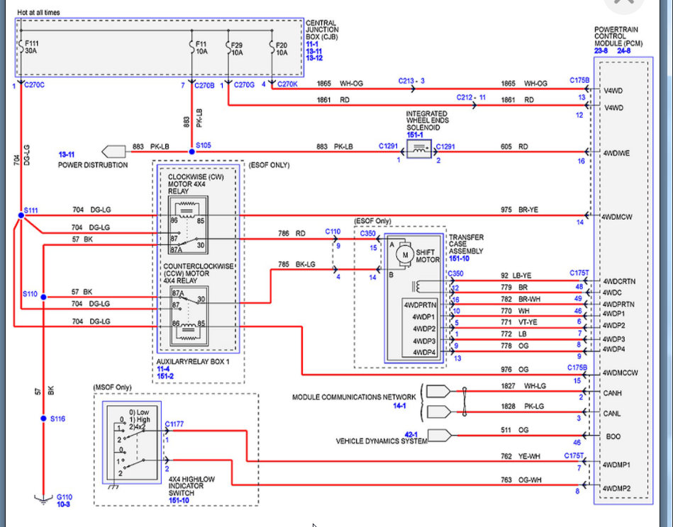

This is most likely either a switch issue or the PCM is not sending the signal to the motor to shift into gear. However, normally when you turn the switch the indicator will light up if the switch is operating and the fact that it is not, points to the switch itself.
We need to test for power coming out of the switch to the PCM when you turn it and that will tell us if that is the issue or not. Here is a guide that will help with this:
Below is the wiring diagram that should give you the info that you need. Also, more detail about how the system works. Let's review this material and let me know if you have questions. Thanks
