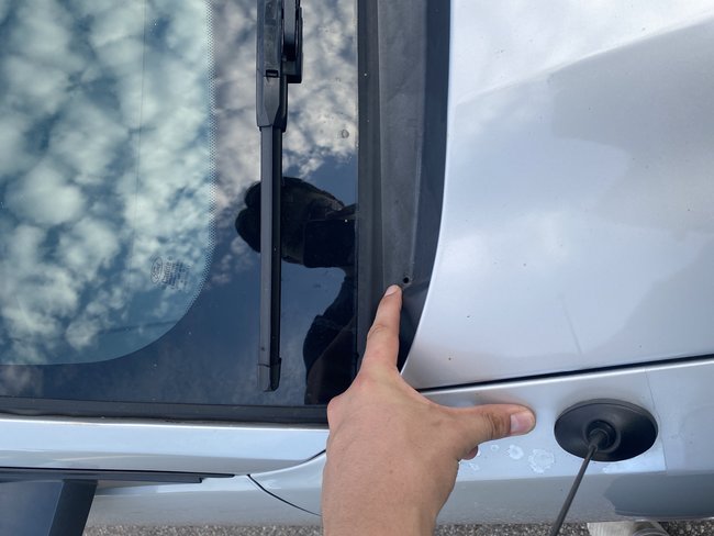

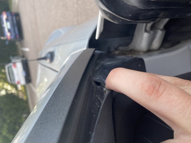

Will do. I think the leak is coming from a small hole in my windshield where the plastic trim meets the windshield. I also noticed a small hole in the rubber part where the passenger window meets the frame of the car. So I will plan to seal or replace. I figure replace might be better but at the same time someone might do a worse job putting a new rubber seal on than me sealing the original. I will post pics when I get home and see what you think.

If you can come up with a way to make smoke or even steam you can use it to find some leaks. You use the fan blower on high inside the car with it taking in outside air or use something like a leaf blower or similar in a barrier in a door window to force air into the car. Then go around the window and panel seams with the smoke or steam and look for it to move where air is escaping from the car. Like this video:

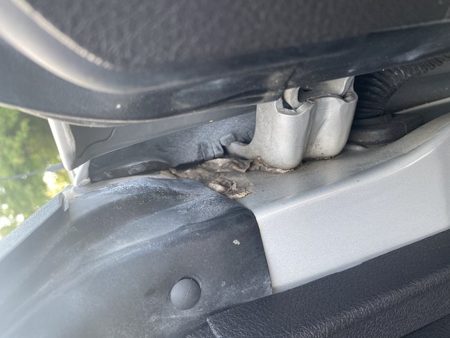

The third pic I definitely see signs of water leaking due to the rubber starting to crack and the discoloration.

Any type of smoke or steam generation would work, even something like a tin can with smoldering leaves and a hose. The idea is to use the smoke just to see the airflow. I've seen a bunch of DIY things used, from cigars, leaves, stage smoke machines.

The base of the windshield is a common leak area on them, it then runs down the inside of the cowl panel and into the SJB. If you use a mirror and look above it inside the car and behind the panels you will likely see the deposits left by water where it ran down.

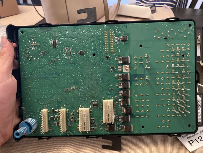

This is a pic of the sjb I bought online. I don’t see signs of wetness or damage. let me know what you Guys. think I’ll be taking out the one in my car this weekend.

Looks okay.If you pull the one in the car apart you can likely clean it and have it work, I would compare them very close and be sure things match up before trying the replacement.
