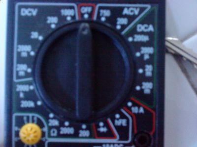

where on this meter should I use to do what you want me to do?
https://images.2carpros.com/forum/automotive_pictures/505144__1.jpg

5 clicks counter-clockwise. The highest the meter will read is 0.2 volts, but they are displaying it in millivolts, so the maximum you want to see at any one connection is 200 millivolts. Anything higher than that and your meter will read some kind of over-range indication. To see what over-range looks like, (how it's displayed, or indicated), just put the probes on the two battery posts. The 12 volt battery is definitely over 200 millivolts. That won't hurt the meter.
If you find this same over-range reading when taking a measurement, switch the range selector one click clockwise. Go another click if you have to, to get a reading. Ideally you would like to see 0.00 volts at every connection during engine cranking, but because we're looking for a problem, you're hoping to find a connection where the voltage is real high.
