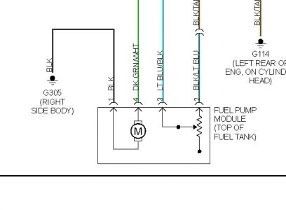

1999 Dodge Van no fuel
1999 DODGE VAN
89,000 MILES • 6 CYL • 2WD • AUTOMATIC
KURT LENNERT

Yeah, if you to buy a repair manual, just click on one of the links. Use a gage and check fuel pressure. Check for voltage and ground at the fuel pump connector, engine cranking. Dark green wire with white tracer is voltage for the fuel pump motor. Black wire is ground. Any trouble codes? You may need an obd2 code reader.
https://images.2carpros.com/forum/automotive_pictures/170934_ram_van_fuel_pump_1.jpg
