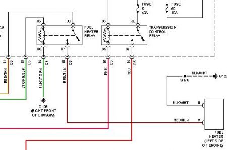

My 2003 Dodge Ram with the 5.7 L Cummins will not start when it goes below about 50 degrees F. I need to plug in the block heater, then, after warming, it starts fine.
This is a headache to say the least.
I can rule out fuel.
I believe the fuel rail and air intake heaters are functioning as I can hear them cycle on/off after turning on the ignition and before starting. I also see the lights dim and the fan motor slow after the truck is started, which I think would suggest the air intake heaters are working. However, how do I check these are actually doing their job?
I had a blown fuse in the fuel heater that attaches to the housing of the fuel filter. However, this was replaced months ago and has not blown since. How do I check to see this element is working and is it even necessary for a cold weather start. I think this only keeps the fuel filter from gelling up, but I may be wrong.
Third, I've read where this is cause also by a faulty or worn out fuel control actuator. This repair seems easy enough, but the part is $150 so I want to make sure I'm right before replacing it. How do I check this out?
I don't see any white smoke upon starting that would suggest injector problems.
Since I won't be near an outlet at every stop all winter, I need to figure this out! I read about our Canadien friends starting these things down to 20 below without a block heater so clearly something is wrong here.
Any suggestions?

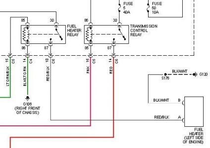

https://www.2carpros.com/forum/automotive_pictures/139033_coil_8.jpg
https://www.2carpros.com/forum/automotive_pictures/139033_gov_7.jpg
diesels are not my specialty but i just gave myself a crash course in this system and it seems pretty simple. i would first start by checking power at the fuel heater because you said it had a blown fuse. it should have power with key on and outside air temp below 50 degrees. if it has power then you need to install a amp meter in series with the hot lead to it and make sure its actually working. you can also ohm out the heater and see if it is open. lets start there
