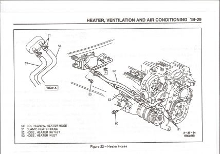

Heater hoses - sorry but I searched through two tech manuals and there is no pic of them. They should be 2 hoses, about 5/8th and very close together going into the passenger's side of the fire wall. The best I can do is provide one from another vehicle to give you an idea.
https://www.2carpros.com/forum/automotive_pictures/248015_scan0001_1.jpg

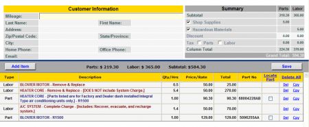

Estimate - your best bet is to get a few figures from say the dealer and several places in town. I would ask around to see what folks recommend as reputable. I would also ask the Better Business Bureau - they may have folks reported to them as great and not so great. But get some estimates from them but make sure they come up with the same conclusion.
I have attached what I think - but I don't have some things some may charge but at least it gives you an idea.

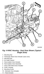

REMOVAL
WARNING: ON VEHICLES EQUIPPED WITH AIRBAGS, DISABLE THE AIRBAG SYSTEM BEFORE ATTEMPTING ANY STEERING WHEEL, STEERING COLUMN, OR INSTRUMENT PANEL COMPONENT DIAGNOSIS OR SERVICE. DISCONNECT AND ISOLATE THE BATTERY NEGATIVE (GROUND) CABLE, THEN WAIT TWO MINUTES FOR THE AIRBAG SYSTEM CAPACITOR TO DISCHARGE BEFORE PERFORMING FURTHER DIAGNOSIS OR SERVICE. THIS IS THE ONLY SURE WAY TO DISABLE THE AIRBAG SYSTEM. FAILURE TO TAKE THE PROPER PRECAUTIONS COULD RESULT IN AN ACCIDENTAL AIRBAG DEPLOYMENT AND POSSIBLE PERSONAL INJURY.
Disconnect and isolate the battery negative cable.
Remove the instrument panel from the vehicle. Refer to: Body and Frame, Interior Trim, Dashboard/Instrument Panel, Service and Repair, Instrument Panel Service Procedures, Instrument Panel Assembly Replacement, See: Body and Frame Interior Moulding / Trim Dashboard / Instrument Panel Service and Repair Instrument Panel Service Procedures Instrument Panel Assembly Replacement
Recover the refrigerant from the refrigerant system. See: Refrigerant
https://www.2carpros.com/forum/automotive_pictures/248015_97395988_1.jpg
Disconnect the liquid line refrigerant line fitting from the evaporator inlet tube. See: Coupler HVAC Service and Repair
Disconnect the accumulator inlet tube refrigerant line fitting from the evaporator outlet tube. Install plugs in, or tape over all of the opened refrigerant line fittings. See: Coupler HVAC Service and Repair
Drain the engine cooling system. See: Engine, Cooling and Exhaust Cooling System Service and Repair
Disconnect the heater hoses from the heater core tubes. Install plugs in, or tape over the opened heater core tubes.
Unplug all electrical connectors from the actuators and blower motor.
Remove the nuts from the HVAC housing mounting studs.
Remove the HVAC housing from inside the vehicle taking care not to allow any remaining coolant to drain on the vehicles interior.
