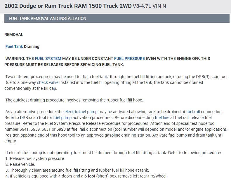

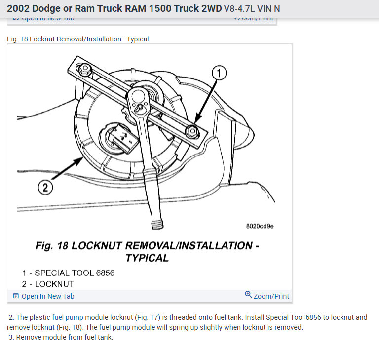

Where is the fuel pump located on the 2002 Dodge 1500 pick-up truck?
Monday, December 14th, 2009 AT 9:56 AM
SQM
  • 6,383 POSTS

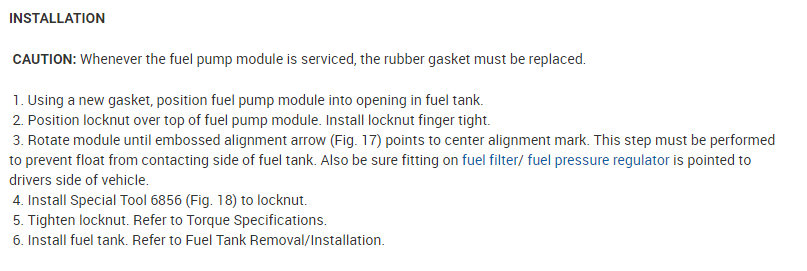

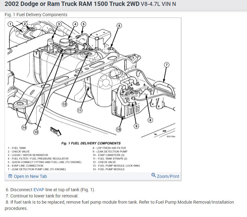

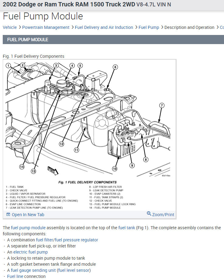

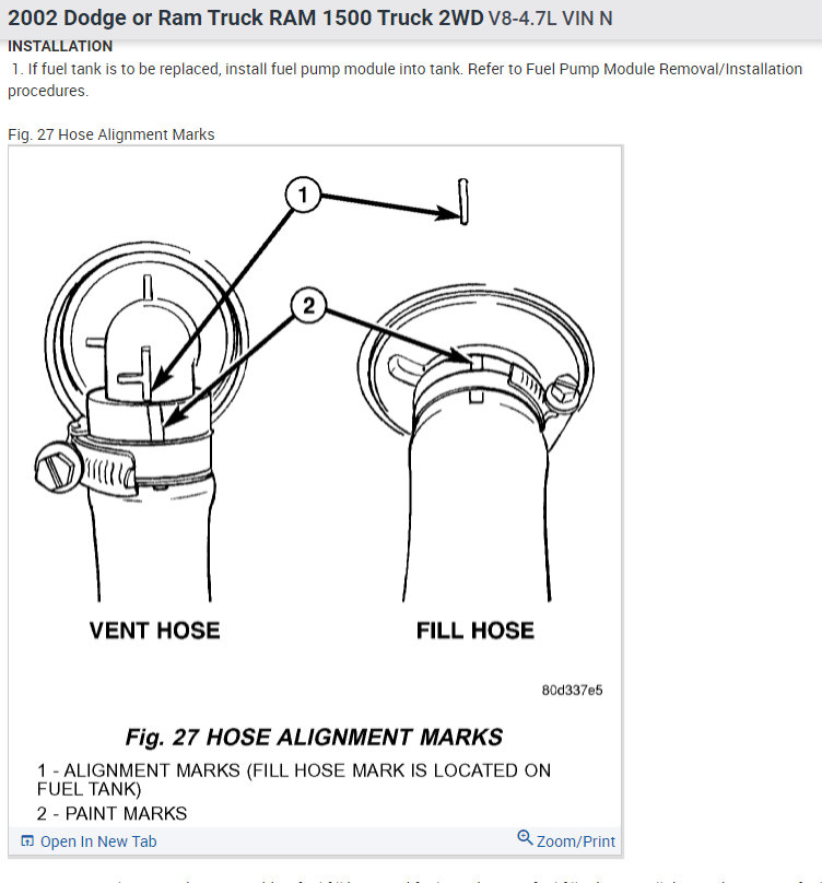

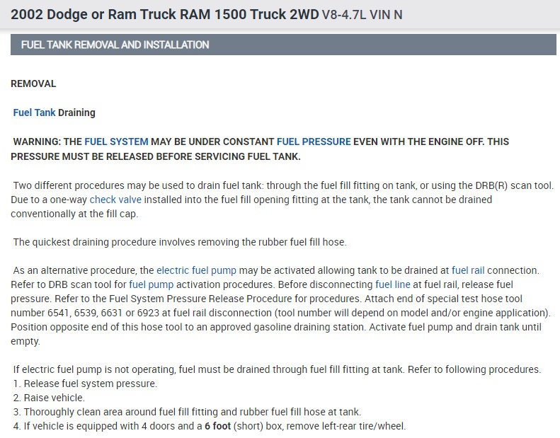

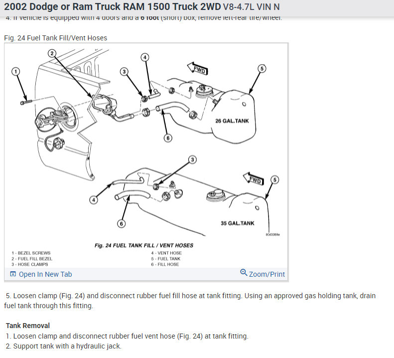

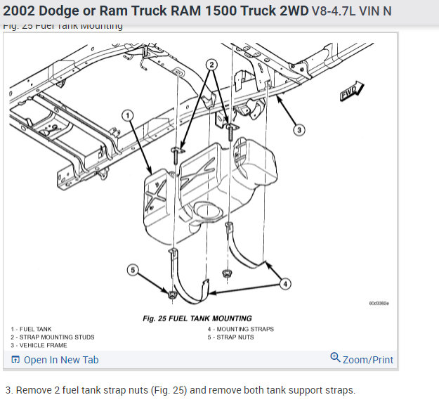

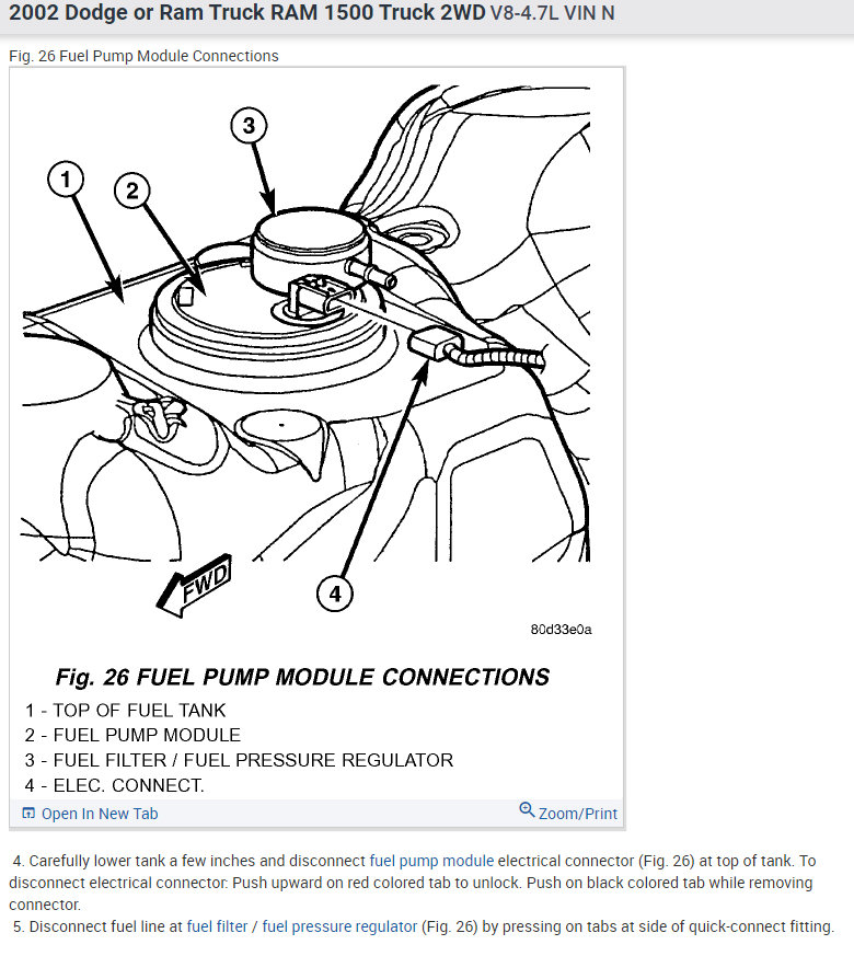

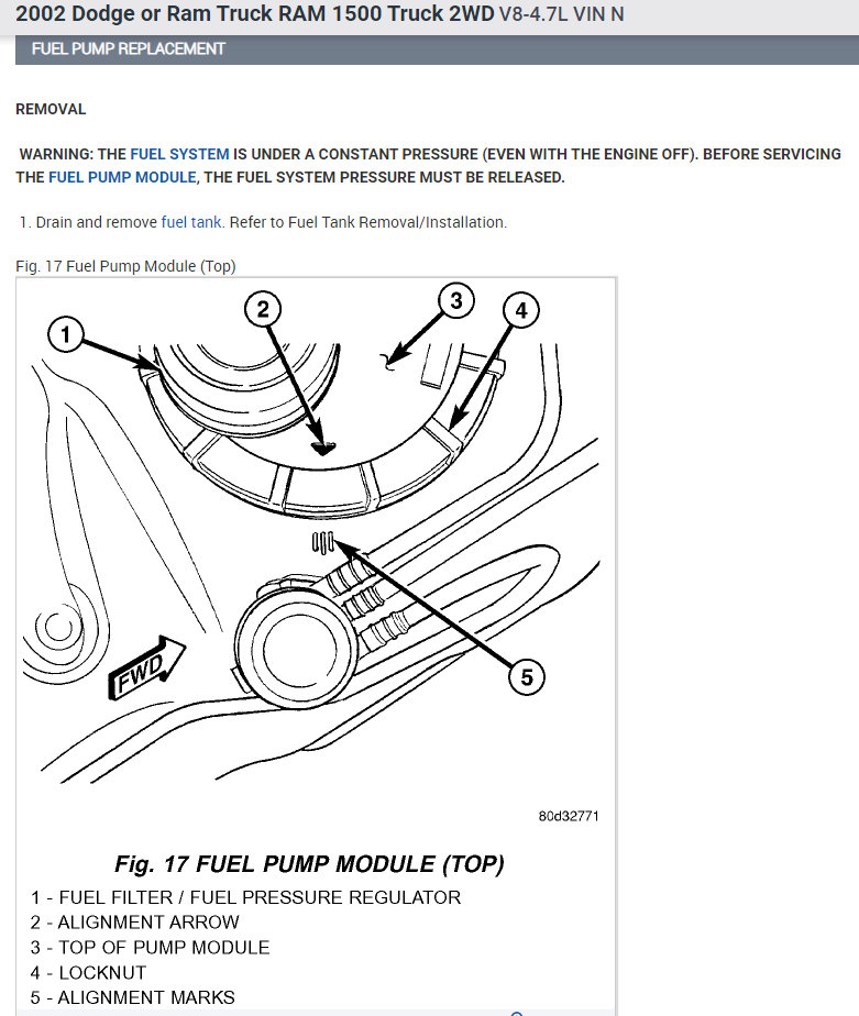

The fuel pump is located inside the fuel tank.

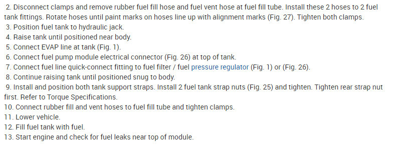

In order to access the pump you will have to remove the fuel tank from the vehicle.
Here is a helpful article:
https://www.2carpros.com/articles/how-to-replace-an-electric-fuel-pump
I have included the replacement procedure for the pump as well as the tank removal.
