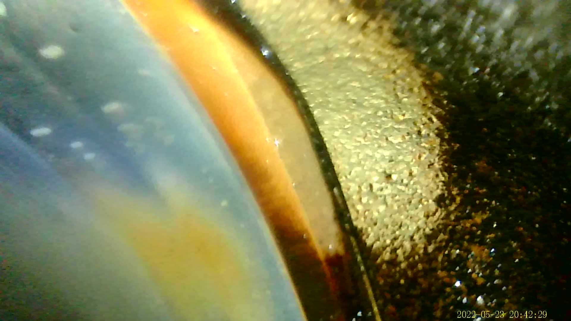

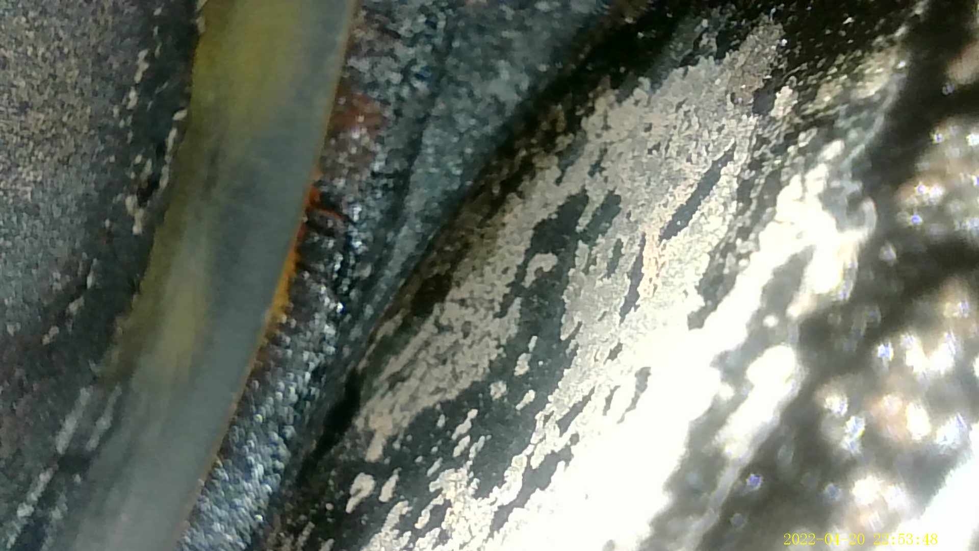

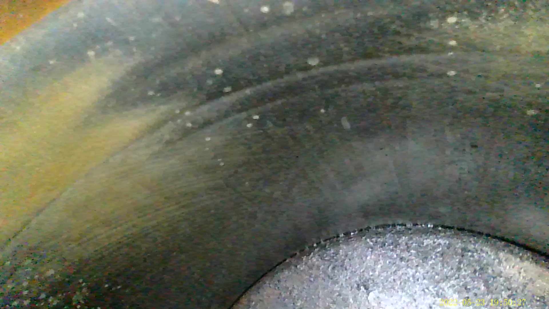

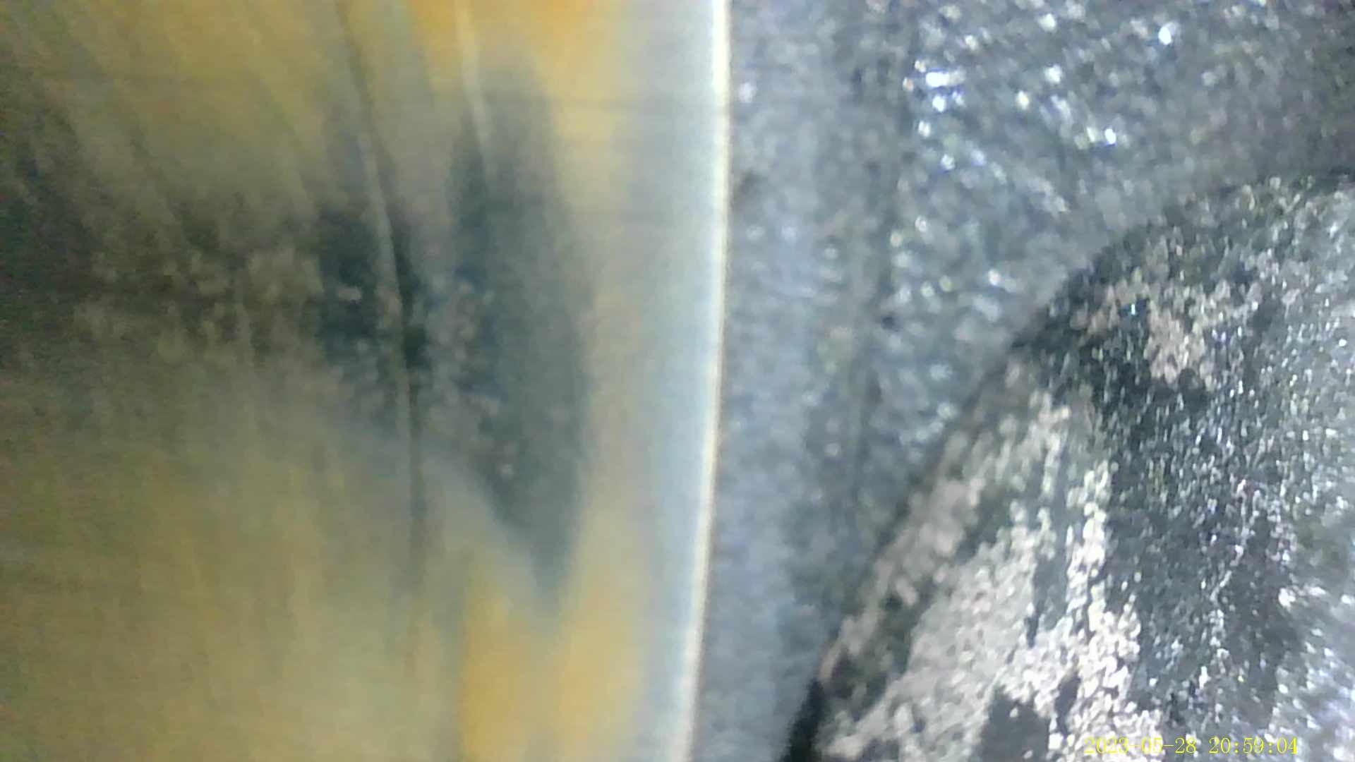

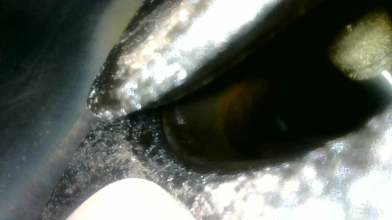

Here is the condition of some of the cylinders on my v8 I only just figured how to send photos and it is so easy. Ha

Hmm, that last image with the piston down in the bore isn't promising, the yellow on the cylinder walls and the clean piston surface looks like coolant has been cleaning it. The coolant will get into the cylinder and the ignition cycle will blast it into steam. That steam will break up and remove any carbon or deposits from the combustion chamber. So, if you look in and see 7 cylinders that have some carbon and ash on the piston tops and valves and then find one that looks clean enough to eat off them, you have a problem.

Yes, I realize that too, only I have been using fuel additives to clean the cyls/valves because the first compression test that I did a year or two ago, the num 7 was the lowest compression at 150 and I noticed that the valve seats are dirty. I also did a leak-down and was hearing air through the intake and the oil filler. I know the rings are most likely bad, I figure If I could clean up the valves, some compression may come back, provided of course that is the problem. I don't know why the gasket would be bad though, because the engine never overheated that badly to blow the gasket; every time that I had an overheating problem, I stopped driving it until I fixed it The heads were replaced back in 2005/2006 at Bob Wilson Dodge when the spark plugs were so rusty that the technician suggested that it was more sensible to replace the heads than to spend time trying to remove rusted plugs The van was from Illinois where I believe salt is used on the roads but I bought it in Florida where I used to live and I shipped it to Barbados 11yrs ago. So, the whole engine was rusty, and it has quite a history. Thanks, Frank

I thought that the yellow on the walls meant that combustion is passing the rings, but then I remembered that I used to use yellow coolant at one time, but who knows how long it has been going on.

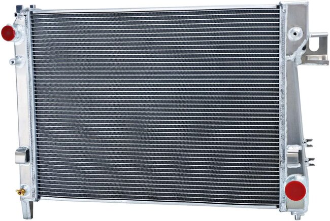

Hi Steve, the radiator is called Engine Cooler 3Row Core aluminum, through Amazon. The ports are on the same side as the top/bottom hoses with bolts stoppering them.

Is it this one? If so then those are mounting points I believe.

No, it is a downflow, that one looks like a crossflow. And the brackets are on the side and have hooks so that it can be rested on the bolts and then tighten the bolts.

Please post an image of it, there are a few that come up that will fit that truck, however it sounds like you have a very not stock design and that could be part of the problem. The OE design is a crossflow design.
