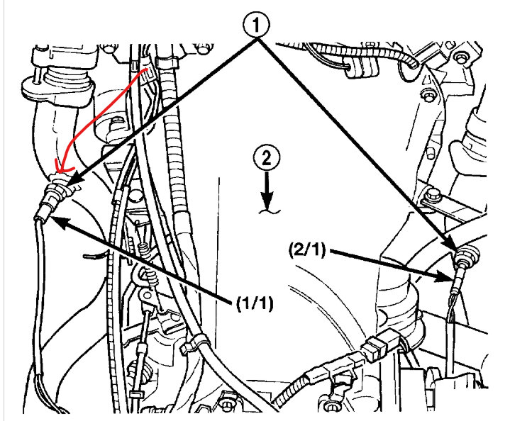

I am getting code "P0132"
What does this code cover?
Thanks

P0132 Oxygen Sensor Circuit High Voltage (Bank 1 Sensor 1)
Your oxygen sensor(s) need replaced or catalytic converter is clogged/faulty. To learn how to check your oxygen sensors, just follow the link below.
https://www.2carpros.com/how_to/how_to_test_oxygen_sensor.htm

Yes, the guide is an example. So bank 1 is on the drivers side. Here is the location. Check out the images (below). Let us know if you need anything else.
