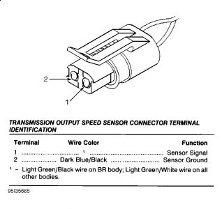

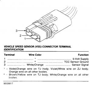

snapon modis also tried shifting with shaffer shifter which would not shift unit either while checking power to trans i noticed speed sensor had small amount of voltage to both wires one green with black stripe the other blue with black stripe shouldnt blue and black be a ground from comp.
Mar 23, 2010 at 1:49 PM
DOCFIXIT
  • 18,828 POSTS
Your describing wiring to Output Shaft sensor and un pluged 5 VDC on green/blk and ground on Blue/blk. Can't see how trns is in limp mode and no codes?? With Modis monitor Output sensor and VSS if they are not same trans will go into limp.
https://images.2carpros.com/forum/automotive_pictures/198357_Graphic_413.jpg
https://images.2carpros.com/forum/automotive_pictures/198357_Grafic_3_111.jpg

modis shows data stream n/a im at a lost for words status on this truck i dont know what else to do all i know is the truck stays in second gear no matter what i do even if i disconnect all power to trans and manuly shift gonna check acumulater pressure in the am if it checks out good all i know to do is give up and refund all monies back to cust. its allready to deep in my pocket
Mar 24, 2010 at 4:31 PM
DOCFIXIT
  • 18,828 POSTS
O.K. no codes and solenoids unpluged sameo then must be hard part failure. Possible things sticking governor, governor electrical circuit fault, valve body ie. stuck shift valve, front servo piston cocked in bore or malfunction front band linkage
