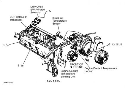

I have a 1997 Dodge Ram 1500 Truck. If the engine has not been started for more than 4 or 5 hours it stalls while trying to start, unless I keep my foot on the gas pedal. After I keep my foot on the gas for at least 3 or 4 minutes, I can let off and it will stay running. It will start again just fine as long as it is within just a few hours of shutting off.
Common sense tells me that it is the Idle Air Control Valve but I'm no mechanic, so I don't know. Please HELP!

Maybe ECT coolant sensor tells PCM engine cold to adj. timing and increase inj. pulses ie. like a choke. If IAC would have idle problem most the time . Simple test when engine cold measure resistence across sensor terminals should be 35K or higher as it warms resistence drops.

I replaced the Engine Coolant Sensor as you suggested (only cost $12.99) and am still having the same problem with no improvement. I disconnected the battery during the entire installation. Is it possible that the computer still isn't reset? Do you have anymore suggestions? I imagine that it has to be a really simple fix but I am getting frustrated with it.

I decided to try and reset the computer again. This time I drained the computer of any reserve power by pressing the horn button.
I just want to say that replacing the Engine Coolant Sensor was the correct diagnosis. For the first time in months, I didn't have any starting problems all day. My truck started like a brand new one.
