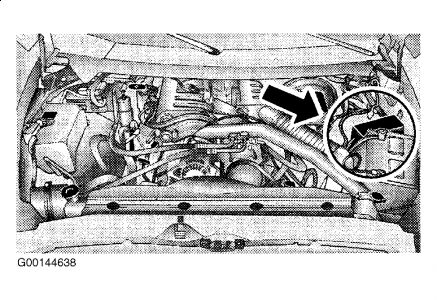

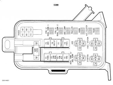

is this the fuse box under the hood you were talking about?
https://images.2carpros.com/forum/automotive_pictures/307270_Graphic_dodge_1.jpg
if that is correct tell me which fuse in its
https://images.2carpros.com/forum/automotive_pictures/307270_Graphic_1996_1.jpg

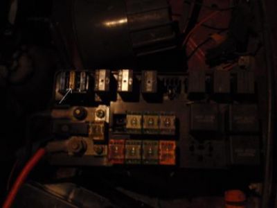

NOELY
  • 16 POSTS
See picture with arrow. The fuse keeps blowing out. It is a 20 amp fuse. If one of those 'black' box fuses are blown could that be causing my problem?

NOELY
  • 16 POSTS
https://images.2carpros.com/forum/automotive_pictures/485513_fuse_Box_2.jpg

DR LOOT
  • 2,311 POSTS
I am having a hard time finding that fused in my schematics, can you please tell me what circuit that fuse operates?
Feb 22, 2010 at 9:42 AM
DR LOOT
  • 2,311 POSTS
Sorry I found it, disconnect all of your plugs on the wiring loom to the A/C Compressor Clutch, Horn Relay, Horn Note & A/C Compressor Clutch, one of those systems is shorting out, unplug those, then remove your battery cable, it does not matter which one, put a test light in between the of cable and the battery, if the light comes on you still have a short, if the light does not come on plug-in each component until the light comes on and that is your problem lies.

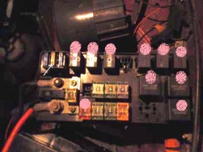

NOELY
  • 16 POSTS
I did a light test today. I could not do one inside the cab because the light wouldn't reach but none of them are blown. Under the hood however was a different story. In the picture attached you will see I have marked some relays and one fuse with a pink circle. The ones marked in pink do show a light when they are removed and their circuit checked, the other unmarked items show no light when they were removed and their circuits checked.!

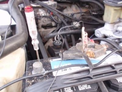

I don't think your understanding how to do the test, because you said "I could not do one inside the cab because the light wouldn't reach" the test light doesn't have to go anywhere except on the battery, remove the positive (+) cable from the battery, you may need an additional person to help you, the test light will have an alligator clip on one end, you can clip that end on the battery cable, and the other end touch the top of the battery post, making that connection from the battery cable through the test light to the battery post, if the light comes on you are having a draw, do only what I told you just now and let me know if the light comes on.
Mar 1, 2010 at 2:13 AM
NOELY
  • 16 POSTS
Ok I did what you said and the light went on. if what I did in the picture is right.
https://images.2carpros.com/forum/automotive_pictures/485513_005_1.jpg
Mar 1, 2010 at 6:53 AM
DR LOOT
  • 2,311 POSTS
That is correct......... now with that test light in that position, remove your fuses one by one and replacing them, when the test light goes out you have found the circuit that is draining your battery. Let me know what you find out

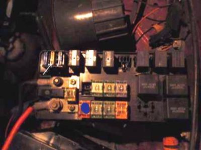

NOELY
  • 16 POSTS
Success! The photo shows the fuse that was causing the problem with a blue spot on it. My radio still doesnt work and I have checked the fuses, all of which look fine, unless I shorted my radio out !? I took the truck for a ride after using another car to charge it and it started no problem.

NOELY
  • 16 POSTS
Yeah and thanks for your help. The yellow fuse with the arrow by it keeps blowing and the horn and radio are out. I'll try replaceing the horn relay and see if that fixes the blown fuse problem
Mar 2, 2010 at 5:45 AM
DR LOOT
  • 2,311 POSTS
Most likely the horn has shorted it is no good, remember I told you what that circuit goes to, your air-conditioning pump your horn and one more thing I can't remember. Don't forget to give me a vote.
